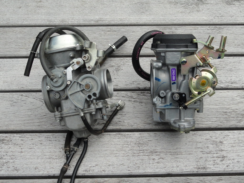

Postby breakwellmz » Wed Mar 04, 2020 6:07 am

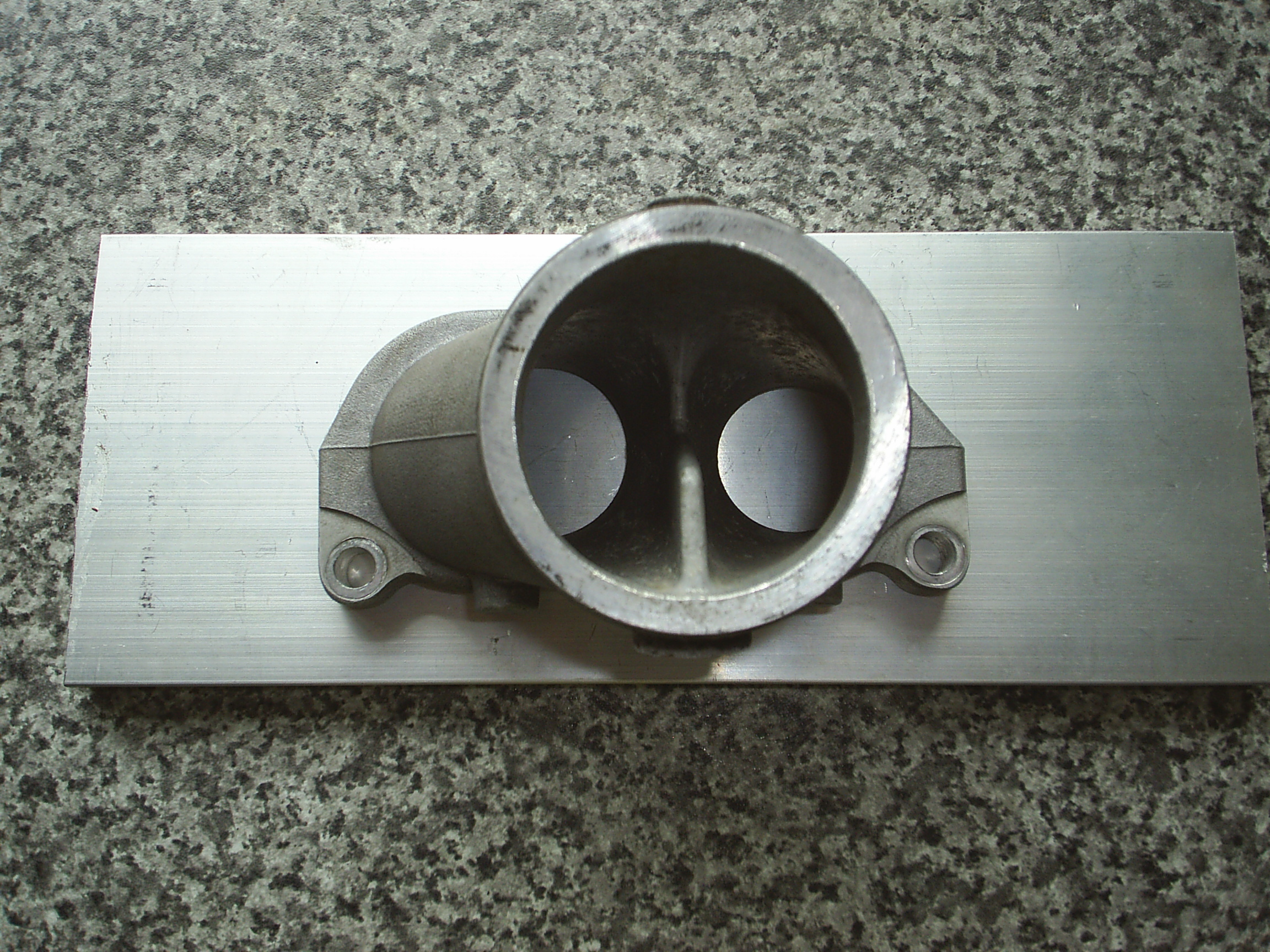

Late night teaser over here are the bits n pieces - Grizzly(?)manifold, adaptor plate, extra pair of rubber manifolds, CV pumper carb.(Note how much more compact it is than than a standard one)
Posts: 820
Re: Single carb on Mastiff AGAIN!
Postby breakwellmz » Wed Mar 04, 2020 6:16 am
The Grizzly manifold ports have closer spacing than the MZ head by about half an inch so the extra pair of head to carb adaptors, short lengths of tube, and the ally plate should sort that.

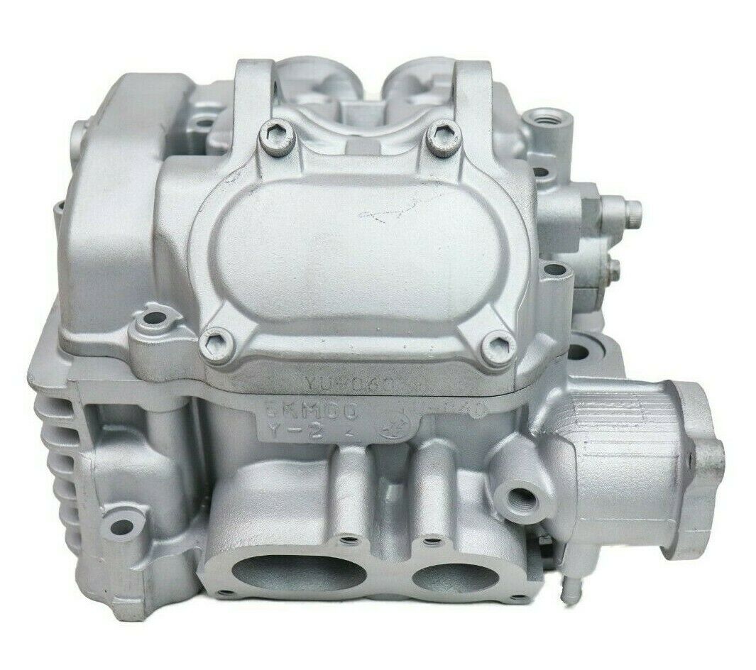

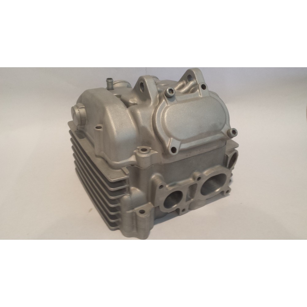

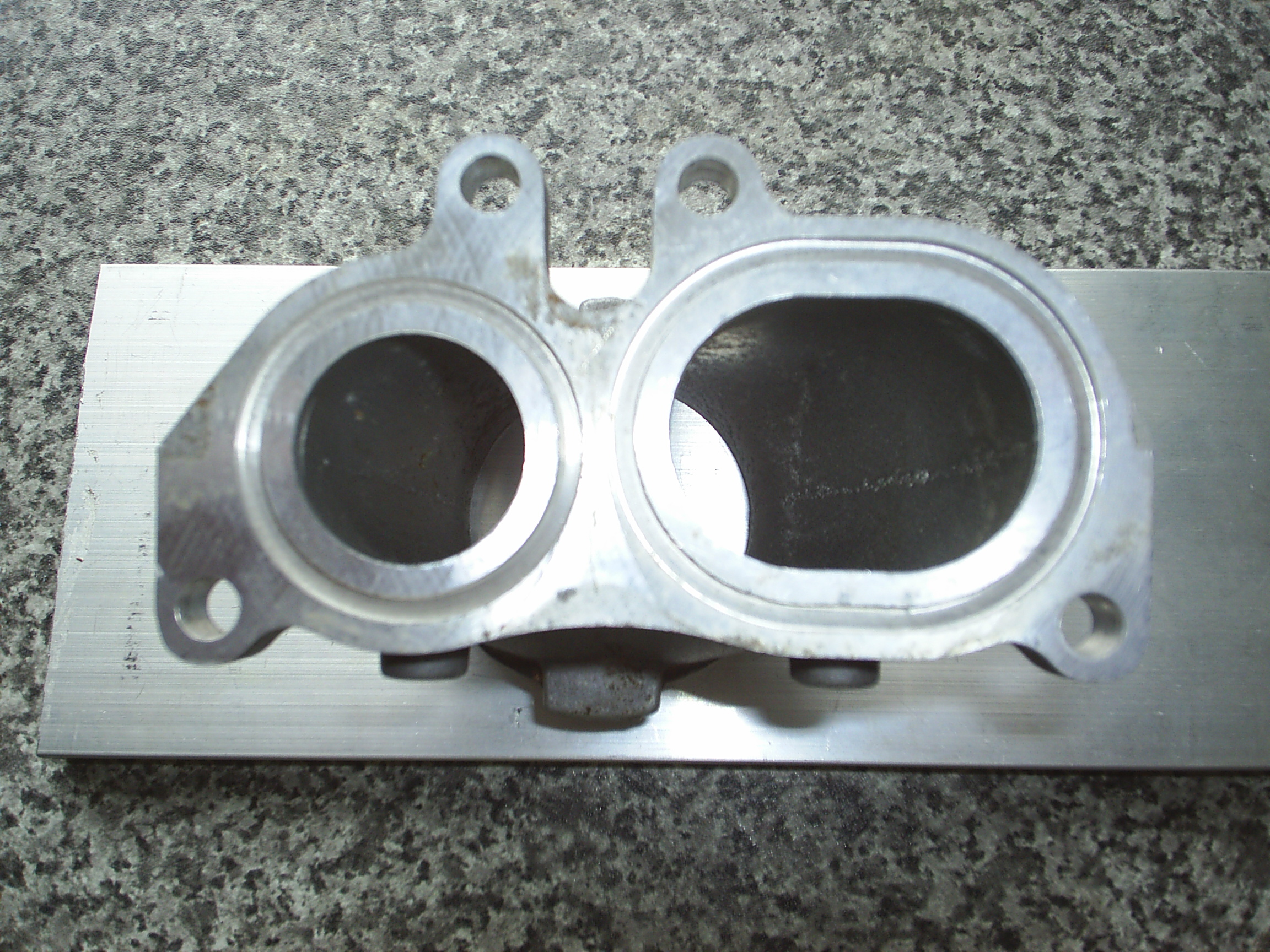

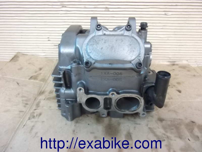

Yamaha don`t help matters by swapping around the port shapes between XTZ660 and Grizzly 660 heads as you can see here - Why?
Posts: 820

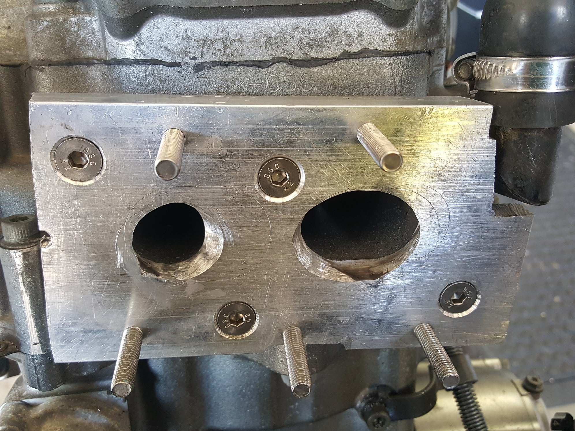

Postby grrant1058 » Sun Mar 22, 2020 3:36 am
Hello BreakwellMZ,

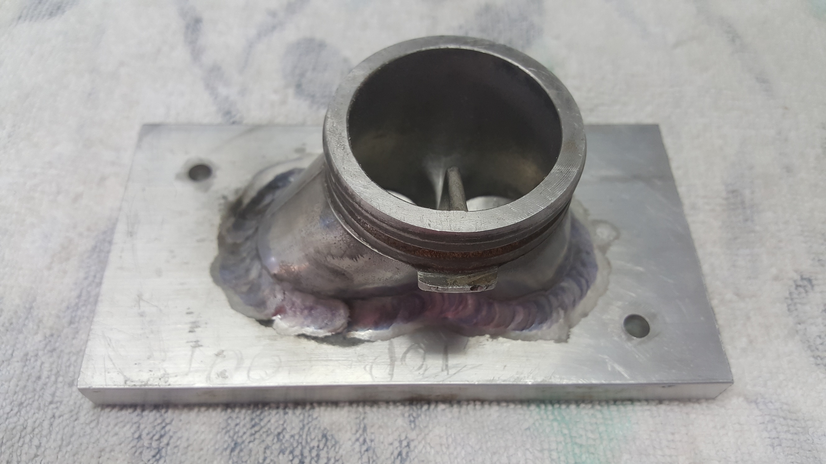

Indeed that manifold you have is from a 660 Grizzly. I have used one of those on my 660 Tour, but it did take a fair bit of fiddling, welding etc. The biggest issue is the inlet ports are reversed so the manifold has to be fitted wrong way around ( "upside down" ) and the bolt holes are different. PLUS, turn the manifold upside down and the angle of the carb is all wrong.
What is required to make this work is: -
1/ Cut the mounting face off the manifold and replace it with a new mounting plate at a different angle so the carb clears A/ the starter motor and B/ the fuel tank. In the image attached you can see I have not yet drilled all the mounting holes.
2/ As the bolt holes for the Grizzly manifold don't line up, make up an adaptor plate (similar to what you have pictured) that bolts to the existing inlet manifold mounting holes on the head. This plate will need to have bolts coming out so the modified manifold can bolt to the adaptor plate.
3/ Bolt the modified manifold to the adaptor plate on the head and good to.

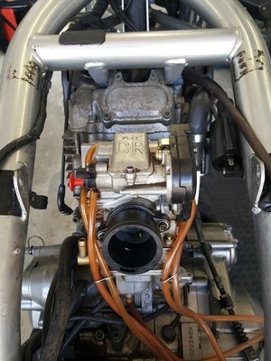

I have used a 39mm Keihin FCR pumper flat slide from a WR450 Yamaha. Fuel economy is about the same. Starts easy, idles perfect and throttle response is so much better. Pops the front wheel easy as pie, now that wasn't necessarily my goal, I just wanted to get rid of those old outdated carbs and use the latest and best technology in an easy to use/ tune single carb. I have the identical carb on my DR650. Totally transformed that bike and I now have over 100,000 km's on that carb on my DR, so they are a long lasting option. Jettings specs identical to my DR. Check out all the specs here. http://mxrob.com/
Cheers - Ron

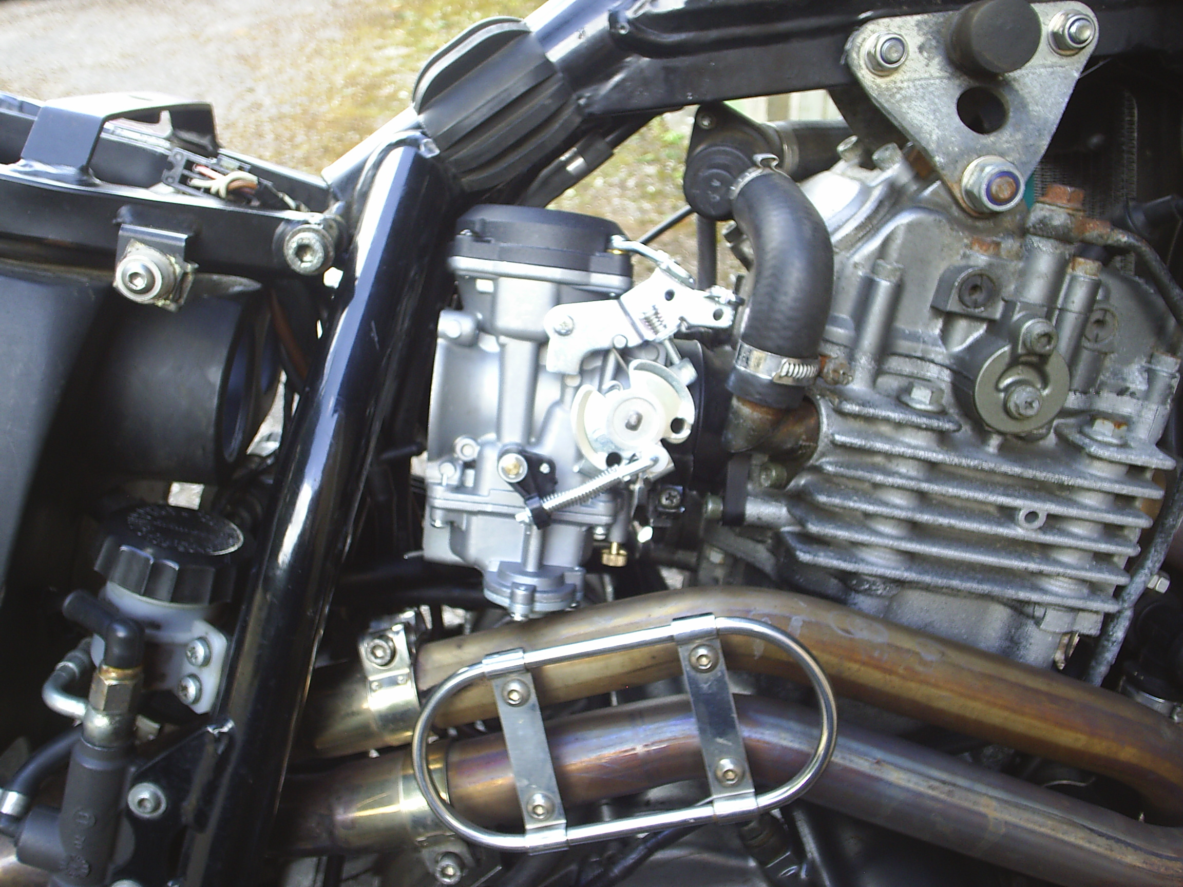

Postby breakwellmz » Sun Mar 22, 2020 4:57 am
Hi.

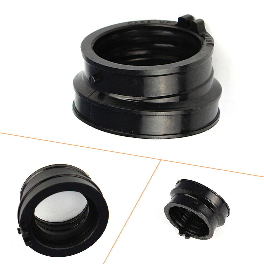

Due to not having access to a TIG welder these days i`ve used a rubber manifold from a Honda XR650 between Grizzly manifold and my carb which is angled enough to bring the carb horizontal, a mate will turn me up a simple adaptor ring to join the two.
I made my adaptor plate out of 10mm ally plate, a couple of hole-saws and a dremel, quite satisfying really.
Waiting on my pair of rubber manifolds to arrive before i can proceed.
Cheers
Posts: 820

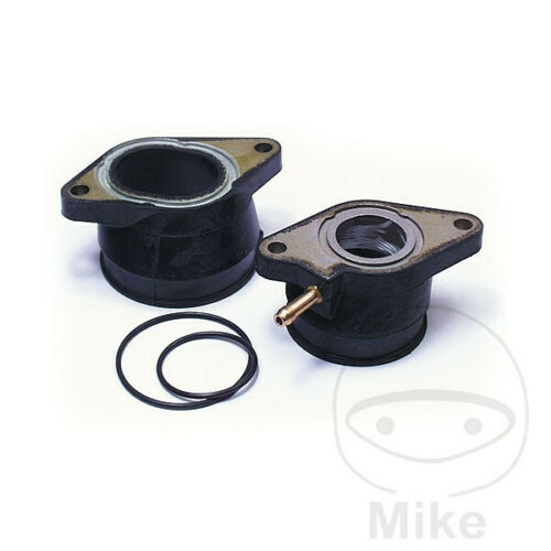

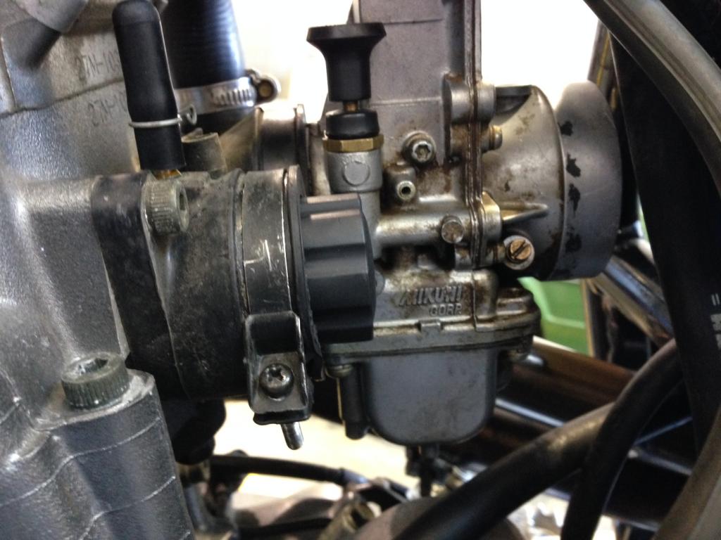

Yes that`s right but using two pairs of the mini manifolds flipped around to get the centre-to-centre spacing difference sorted between heads.It makes the inlet tract longer than original but so did these Bikeworx manifolds (second photo) -
Very tempted to try this out with my new carb just to see how it goes (first photo) -

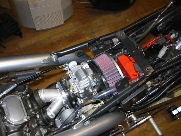

Postby breakwellmz » Sat Apr 04, 2020 11:58 am
Hi.
Took the original carbs off today and couldn`t help but put my new carb into the right-hand rubber `manifold`where it was a perfect fit!
The MZ enricherer is also a straight fit and the throttle cable outer retainers only needed the lugs cutting off and the holes opening out to 6mm clearance (for the adjusters) for the cables to function as they should.
I am now even more inclined to see how it runs in this form with the left-hand carb port blanked off.
I was surprised how small the link port is between the left and right inlet ports proper - an oval shape of perhaps only 8mm x 12mm.
I think i shall try out this setup with this link port both open and blanked off.
Cheers
Posts: 820
Postby breakwellmz » Sun Apr 05, 2020 7:43 am
The beast lives!!
After making a temporary blank for the left hand carb port and connecting cables and fuel line, it started up promptly with a bit of choke and settled down to a reliable idle.
After a little warming up throttle response from idle feels good and it reminded of my DR350 engined Beta Alp as i rode it slowly away from my garage, time to sort out an air filter.
Can anyone tell me the best way to remove the air filter box please?
Cheers
