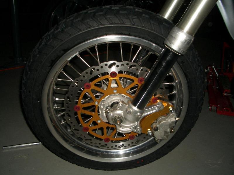

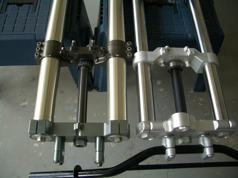

Folks here had stated that YZ forks could be used and after seeing the cost for Ohlins (I wish...) I figured that I experiment and chance the YZ route. I've noticed that quite a few YZ's are being parted with blown mtrs, with the rest of the parts looking pretty good. Hopiing that there are a few honest folks out there I bought a used set from an '03 and Tag upper. I'll still need to get the lower, stem and other bits but at least it's a start. I've always like the feel of the smaller bars, though the fat bars look cool I'll stay with the stock controls for now. Never done anything like this and hope that I haven't screwed up so far...we'll see.

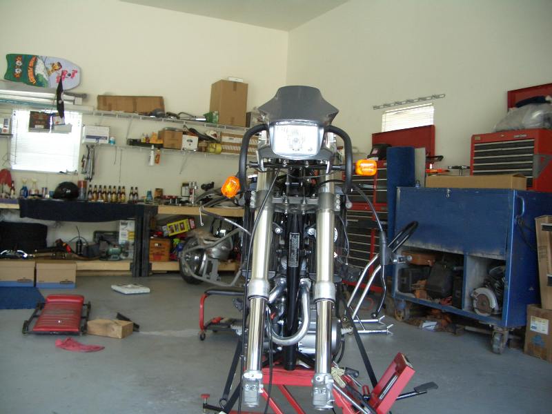

I have the YZ USD frontend on mine. The YZ neck bearings and races are the exact same 52mm diameter as the stock MZ bearings. They do however insert too deep into the neck. That was easily taken care by a bit of yankee engineering. I bought a 52mm piston with 2 compression rings. I insert 1 under each of the bearing races as they were installed into the neck.

I took 4 inches from the length so the fork is now 1.5" shorter than the reduced height Baggy fork was. I also made a set of adjustible links for the rear to lower it by the same amount. The bike is never used offroad. I live in a very mountanous area so the bike is solely used as a canyon carver. It is quite sweet. The engine is tock with an M4 pipe and a set of dual FCR's. The only thing I still want to do to her is change those boo-tuggly plastics.

My FCR's are both 35mm flat slides. I made a custom filter setup using exhaust tubing I bought from Pep Boys. I changed the main jets to 140 and the bike starts and idles great as well as run like it is scared throughout the full rpm range. I am getting 39 mpg when I have been tearing up the twisties and 45 mpg on the highway. The performance difference between these and the stock weirdo carb setup is awesome.
