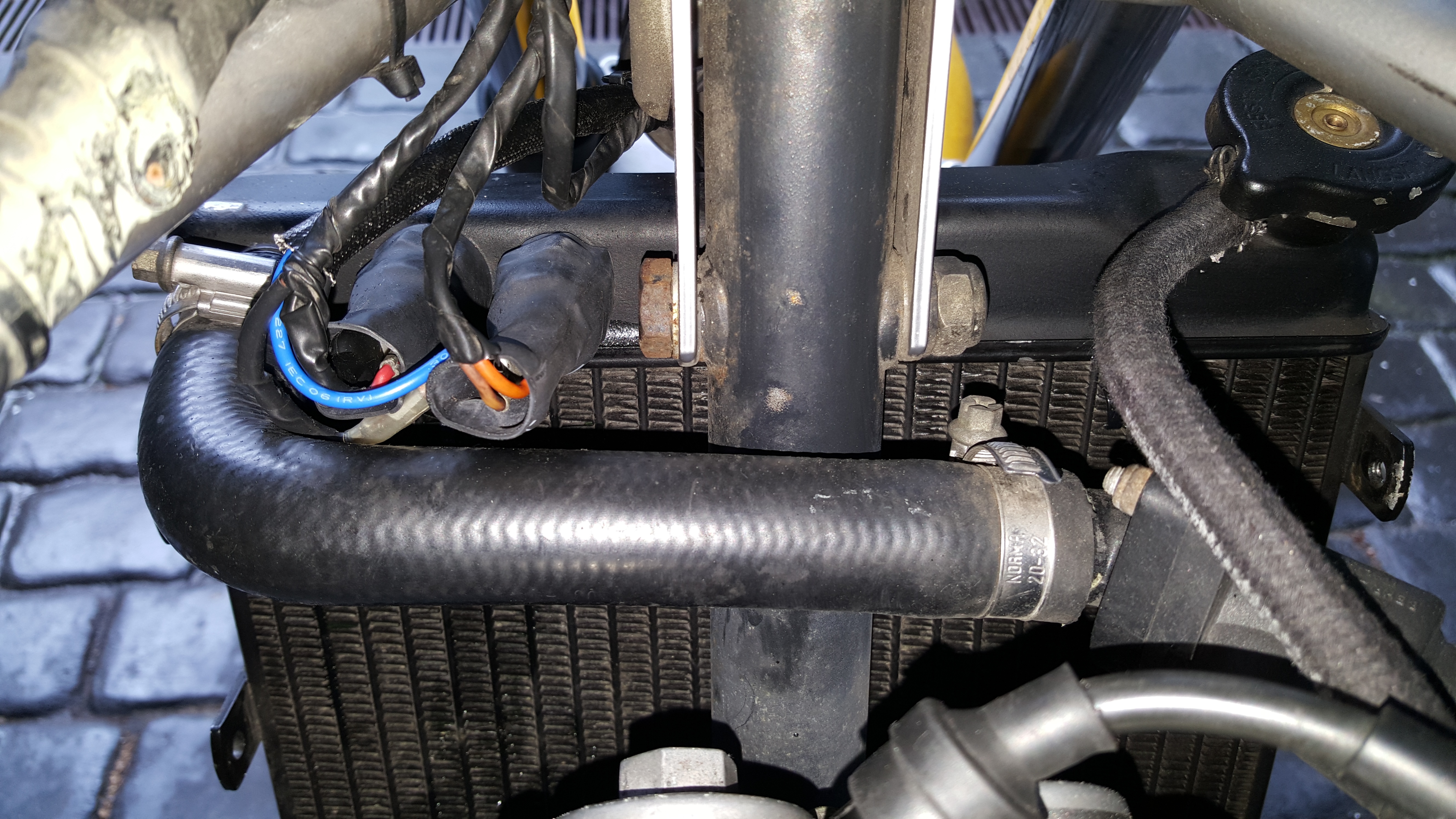

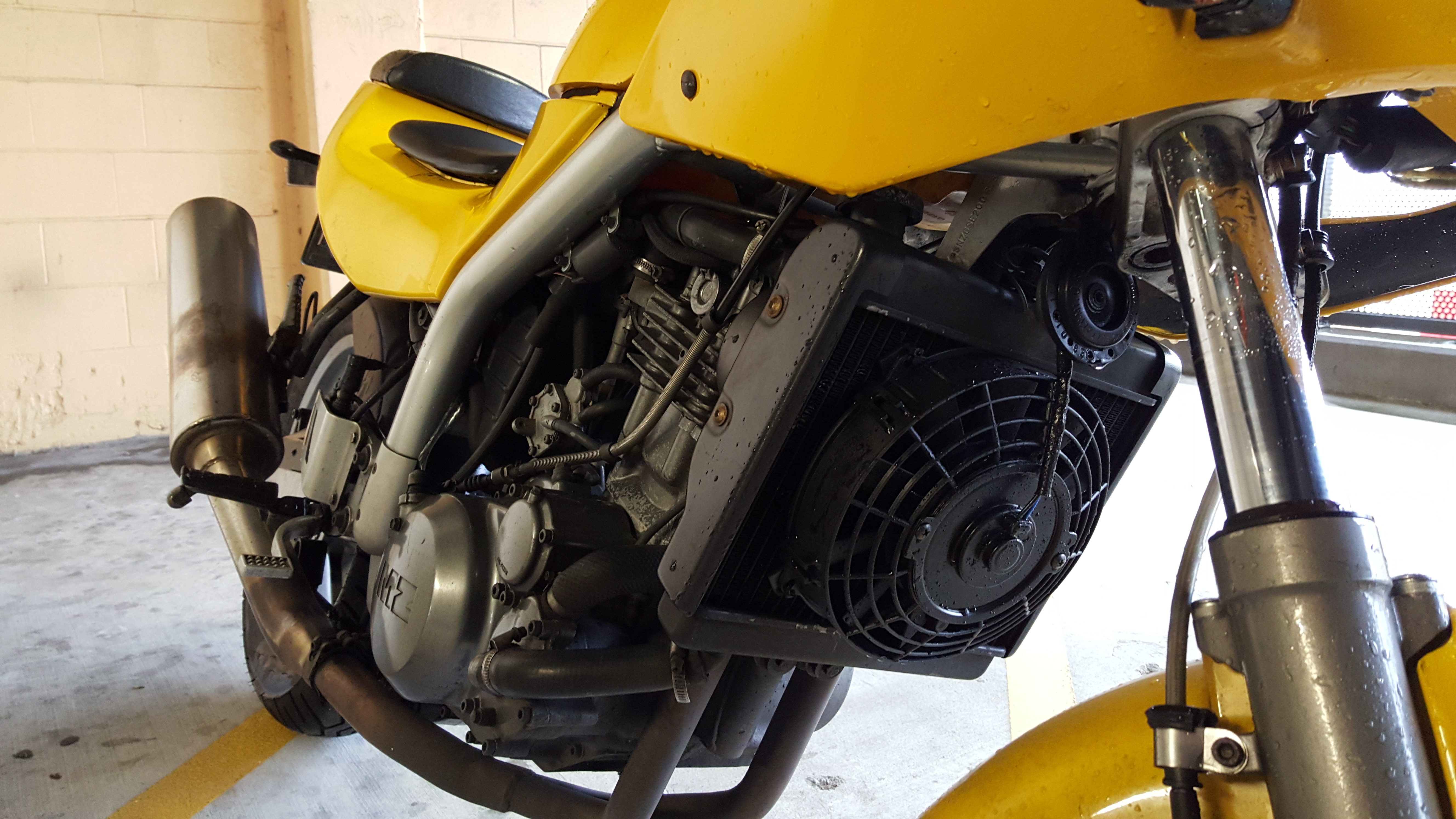

The 7" fan that I purchased was very easy to get and quite cheap at $30 http://www.aliexpress.com/item/Ryanstar-Store-High-quality-7-inch-12V-electric-cooling-radiator-fan-kit-for-universal-car/32425419024.html?spm=2114.01020208.3.2.i2JVJI
This fan fits on the front side of the radiator without any modification (other than flipping the blade over) and does not foul the front fender at all, It was as simple as taking the old fans off, sitting this one in place with 4 small bits of sticky foam so it wasn't rubbing and then holding it in place with 4 cable ties. I tidied the wiring up a bit because I like my bikes tidy and the less wiring clutter the better! its a simple matter of wiring the negative of the fan to the thermo switch terminal and the positive to the brown ground wire and then getting rid of the 2 old connectors. The reversed polarity is so the fan pushes the air in the right direction - This also means flipping the blade over which is as easy as undoing the bolt on the front and putting it back on in reverse.
I tested the thermo switch out just to be sure it would fire up when i needed it to by having it connected to my multi meter and dipping it in boiling water to watch it switch, The temp on these must be fairly high as it wouldn't switch until the water was boiling violently but it worked 100% reliably so I wasn't too worried.
Once all together I let it idle for around 14 mins and the fan came on as expected and cooled it down enough for the fan to shut off in about 30 seconds so im happy with that. Got the chance to road test it on the way to work this morning and after a 30 min hardish ride it still took 8 mins of idle before the fan came on so it cant be obstructing air flow by much.
The only outstanding question I have on this now is the sensor for the high temp light? I didn't take the switch out of the radiator to test in boiling water like I did for the fan switch but I did test the wiring and lamp by shorting it out and they work but the light doesn't come on when the fan does. It this set to a higher temp? Has anyone seen the temp light come up on their dash before?
Hope this can be helpful for someone else out there!

I hate to be the party pooper but your mounting system for the fan down right dangerous. Zip tying your fan to the radiator core is probably one of the worst ideas I've seen in a while. You can buy some aluminum plate that is thin enough to work without a metal shop and make some real fan mounts. Use a drill bit to make your radii and a hacksaw to make the straight lines, bend where necessary and voila! Custom radiator fan mounts. :wink:
Re: Skorpion substitute part database- please add!
Postby toledo » Mon Aug 31, 2015 4:02 pm
I thought that at first too, but it weighs less than a kg, doesn't flow enough to pull its self off and the zip ties are rated at a much higher temp that they will ever be exposed to there. The fan comes with a push through type zip connector which I didn't quite trust so I convinced myself to give zip ties a go. The only thing i'm worried about is it damaging the radiator core but it doesn't seem to be at all so far.
Convince me otherwise and i will make up some custom mounts....
toledo
Posts: 12
Joined: Tue Jul 28, 2015 8:05 pm
Postby edfmaniac » Tue Sep 01, 2015 1:01 am
I won't try to convince you. I'll just leave you with the fact that you are riding a big single cylinder and vibration is a much more powerful force than most people think it is. If you aren't inspecting the zip ties and the point where the cooling fins are soldered to the water pathways constantly, you are gambling with the possibility of that fan ending up under your back tire on a corner or at some other inopportune time. Vibration and chafing would be my biggest concern, not temp.
