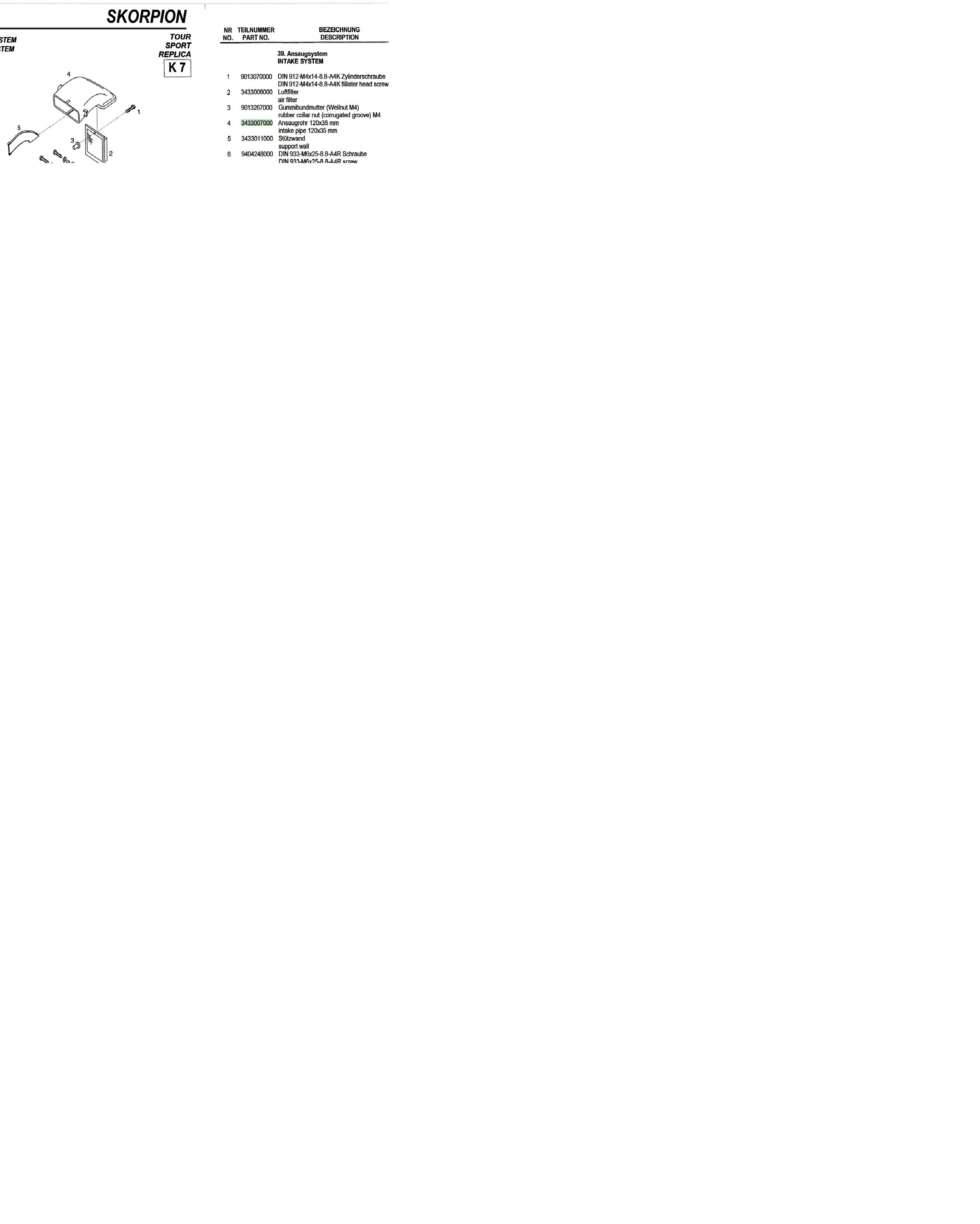

and lot of noise can be by not having a stock air box
my 660 is missing one of the plastic covers under the seat an its loud
any one with 4 and 5 as extra in the parts box i am interested .. number 2 the air filter is not found in USA
click picture to make it bigger an use arrow keys to move up and left to view it
item 4 and 5 4 = 3433007000 5 can be hand made if needed
