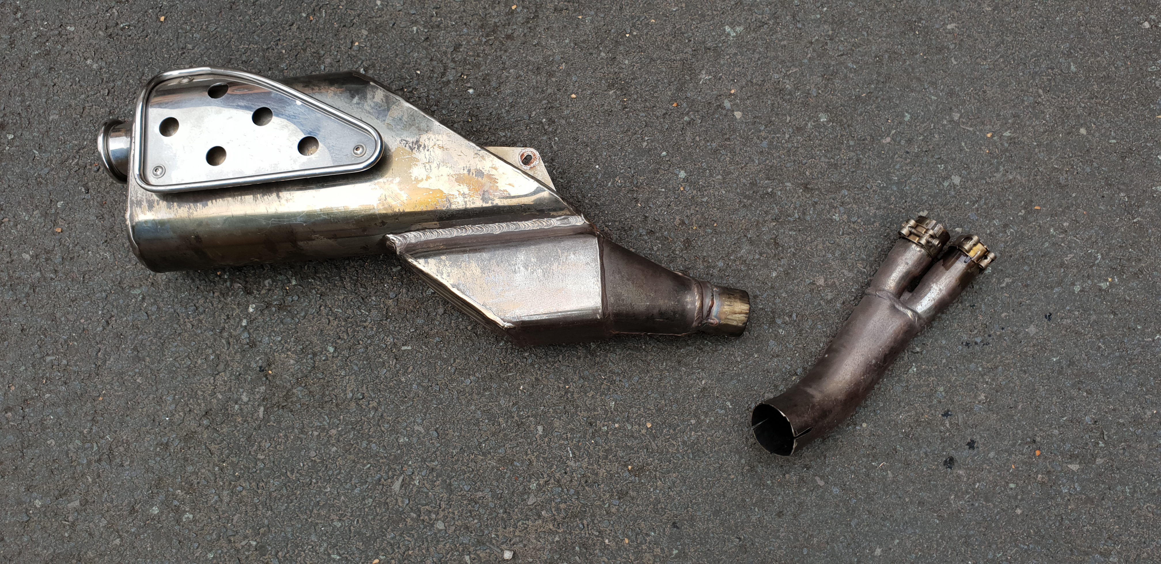

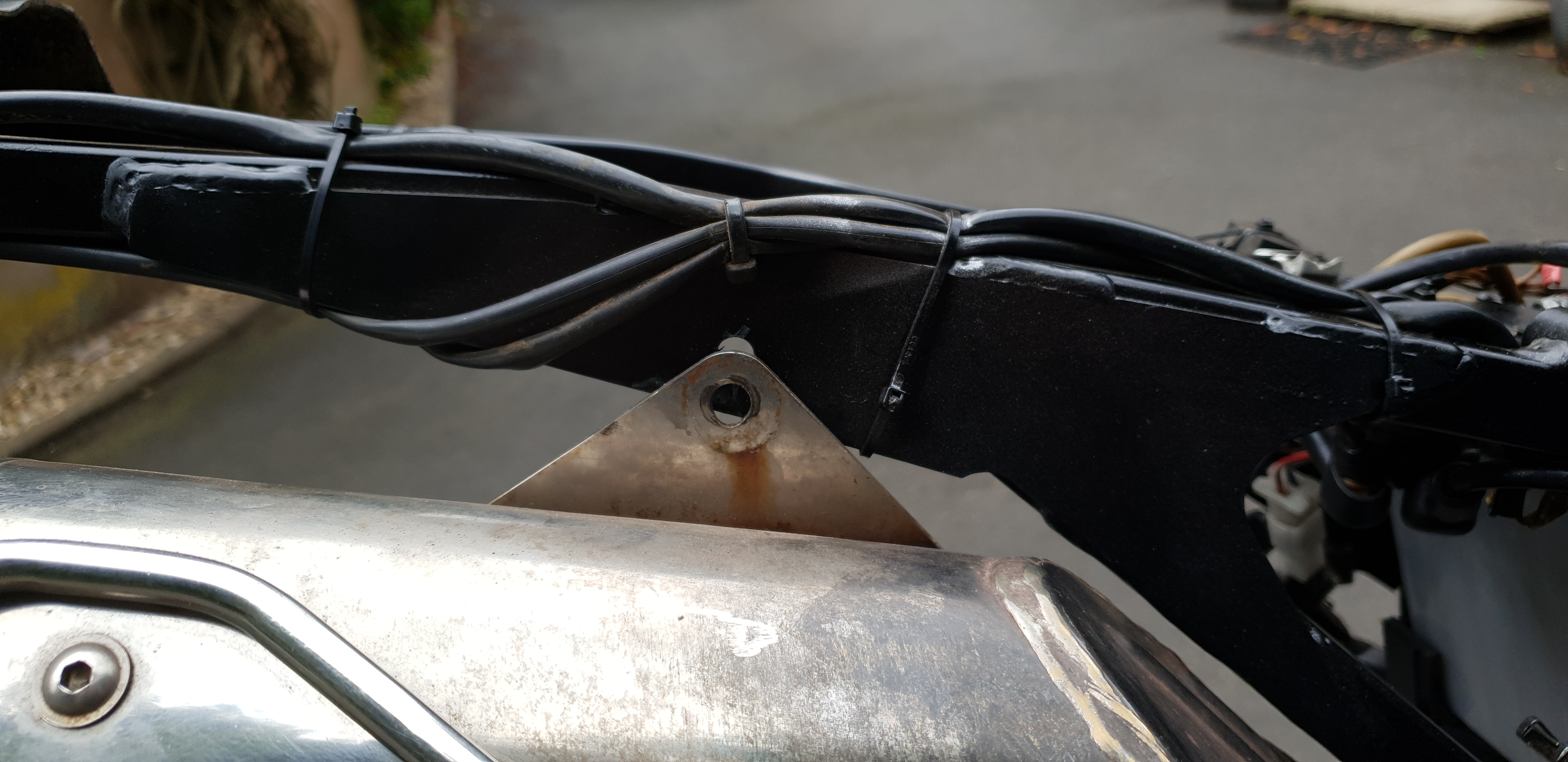

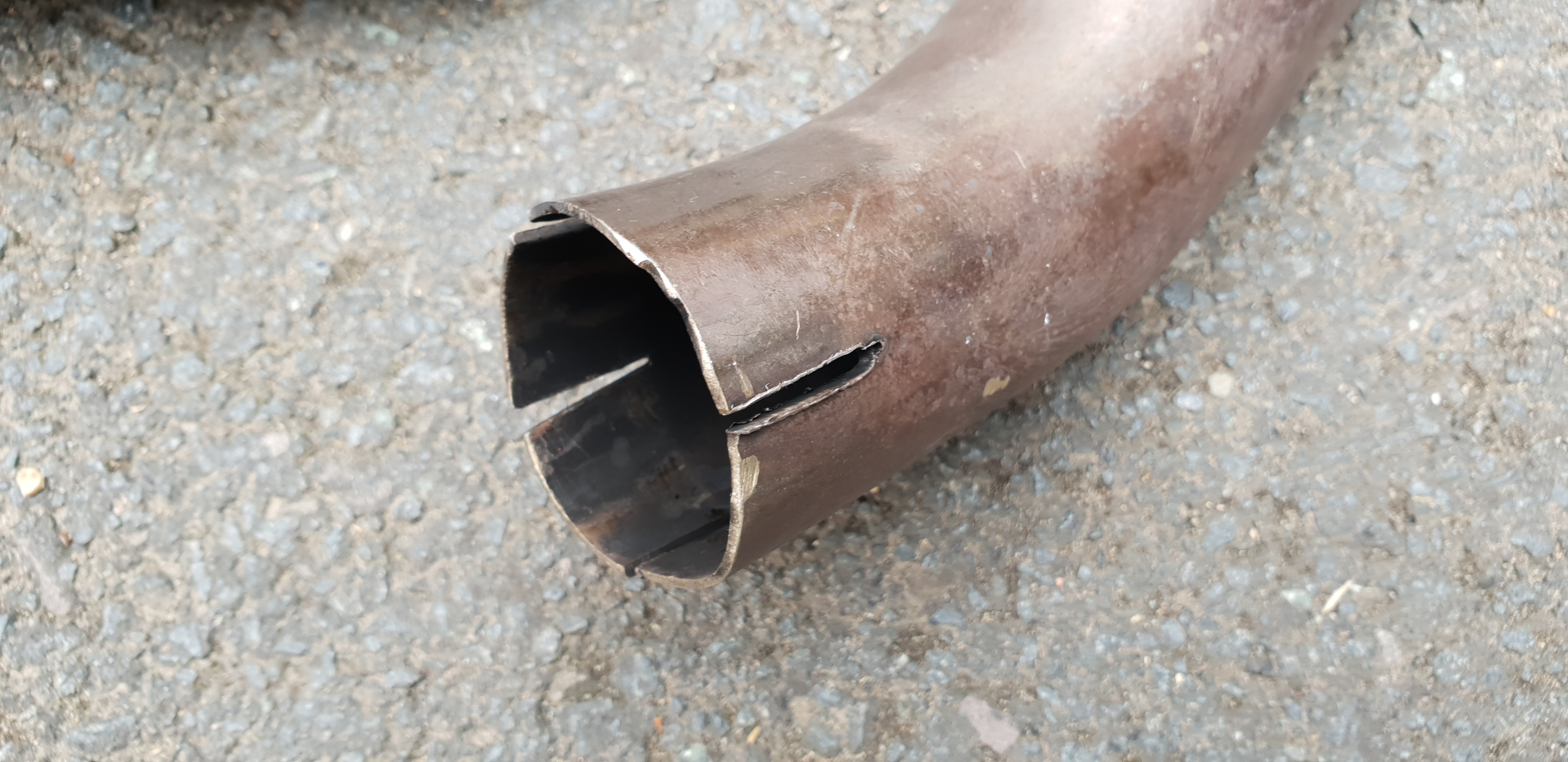

Decided I might ditch the hacked exhaust this morning. I could get it welded up but there's one on eBay at the moment for £50... Or, I could go crazy and get one of those GPR exhausts which are advertised on eBay... for £209, including link pipe.
It wasn't even attached here. And couldn't be without realigning everything, sorting out the mid-section leak, etc.

The exhaust can be Tig welded back together no problem, but you will have to assemble on the bike in the correct position etc and bolt up fairly tight, and have it tacked in the right place and then remove to Tig up properly. If you have a normal Mig welding set, you would still be able to turn that fairly low and tack the pieces back together, then you can remove the exhaust and take it to someone that uses Tig on stainless steel and get them to stitch it up all the way round. If you do, just remember to put as many small tacks as you can on the pieces, at least 4 at 90 degrees to each other, or when he welds it properly it will pull out of alignment, and won't fit back on the bike. I have a BSM Future, road legal with the e3 or e4 mark, to signify that it complies with legislation in Europe. it does make it slightly throatier than standard, but not enough to annoy your neighbours if you have any, but it dies have one slight dint in the can. It is stainless steel, and but a lot lighter than the monstrous original. I did want £100 for it, but you could have it for £85 plus postage if you are interested. Just a thought.

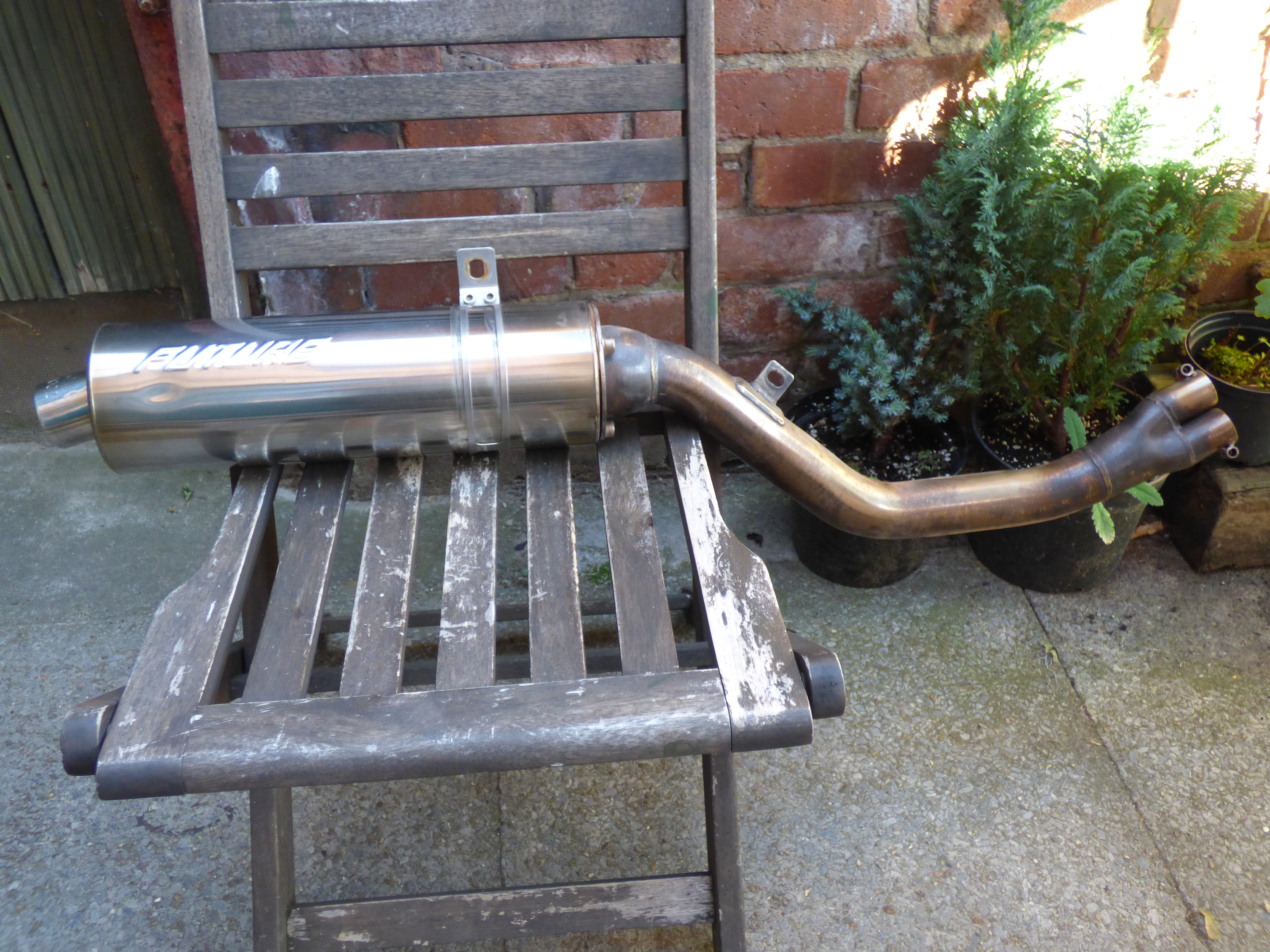

Hi Jon. Yes, I'll have the exhaust off you, mate. Thanks very much indeed. I can pay you by PayPal or bank transfer, whichever you prefer. I'm going to be away from Wednesday until Sunday, just so you know. I'll PM you my address.

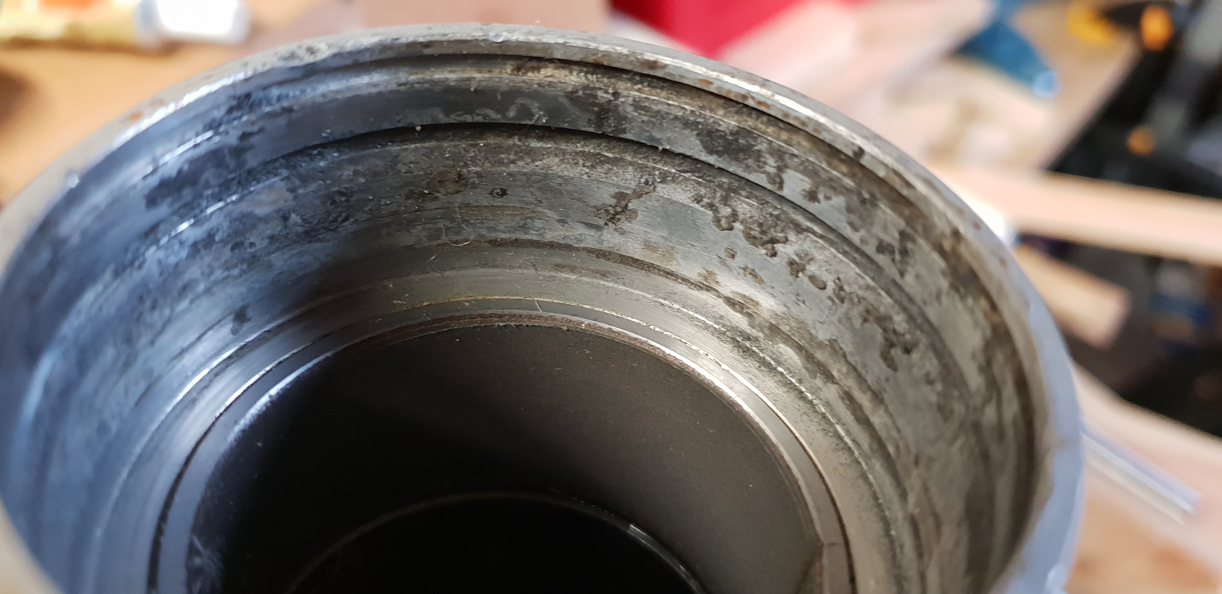

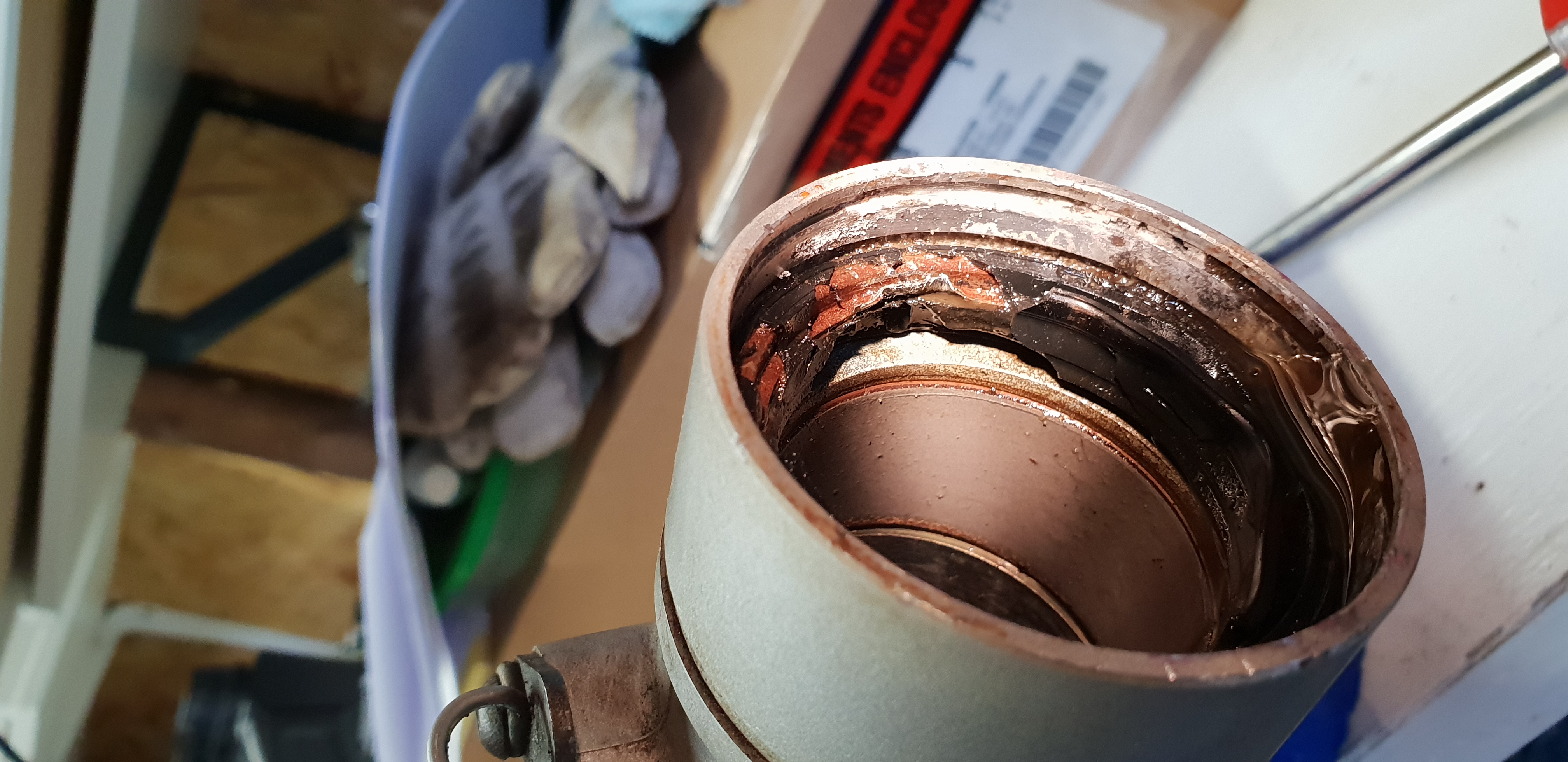

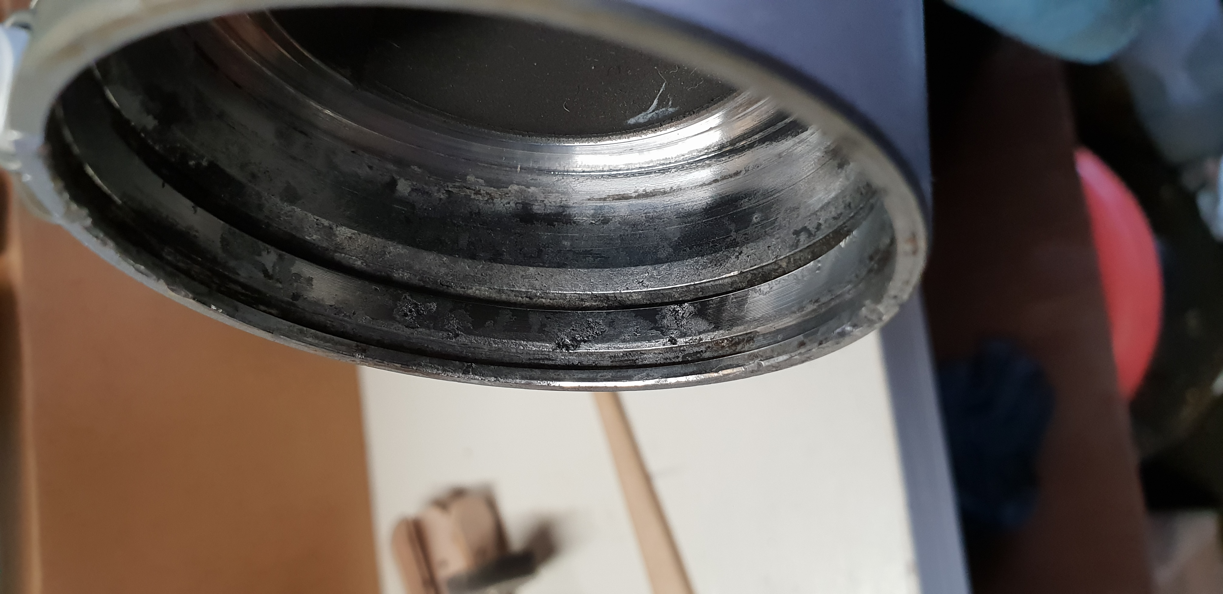

Had a bit of a nightmare this evening. I thought I'd do the fork seals. Got the left one off and could not get the seal out. It has been in there for 13 years I guess and didn't fancy coming out. After several failed attempts, I took to the heat gun. No joy. WD40 left to do its work for 20 minutes. No joy. Another go with the heat gun. Stuck solid. So I took a drift and gently tapped it down all the way round, then tried prying it out again. Ping! Jeez. At last. The state of the fork leg seal surfaces was not good. All back on the bike now. Hopefully the right leg will go easier.
Cleaned up as good as I could

They are always corroded like that, did you give it a gentle clean with a bit of fine wet and dry or similar to smooth it up a bit? And always put plenty of the rubber grease normally supplied with the seals around it, and the seal lips when you assemble. I can see the top guide bush in the picture, and you can tell it has done a very low mileage and no off road work, the Teflon/PTFE coating on the surface of the bush looks perfect, be careful not to damage it, as it scrapes off very easily. The fork bushes both slide on the stanchion and guide in the top of the leg are not obtainable any more, so be very careful with them. I am trying to rebuild a set at the moment, and I can't source any bushes from anywhere, not even old stock.
When do you want to send the money for the exhaust? My email is: j.baldwin119@btinternet.com
If you send it friends and family then there will be no fees, and don't put you address on the payment as a note, they will presume if we are already friends, which we are anyway, that I will know the details, you can PM me the address on here, or email separately.
The postage should be about a tenner, I may have to unbolt the silencer can from the link pipe to keep the size down for posting, and you may have to put some gasket sealant on the join to reseal it, something like high temperature Hylomar Blue (originally made for Rolls Royce jet engines) and I will try and send it by UPS, who are very good and deliver next working day. So if you send me £95 that should cover everything.

I cleaned the surfaces with Solvol Autosol and a dremel soft pad. I didn’t have the guts to use wet and dry :-D Next time, maybe... I put plenty if the rubber grease all over the seal, so hopefully all will be good.

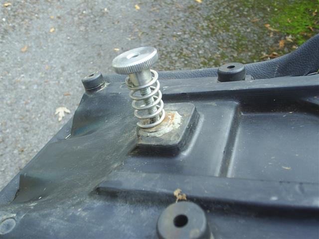

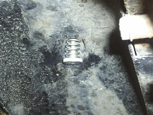

The one going into the base of my seat through the mudguard got lost a long time ago (not surprisingly really)I drilled out the seat fitting and bonded in a length of M6 stainless studding. This is secured by a knurled M6 stainless hand-with a spring between it and the mudguard underside, works a treat! :D

breakwellmz wrote:The one going into the base of my seat through the mudguard got lost a long time ago (not surprisingly really)I drilled out the seat fitting and bonded in a length of M6 stainless studding. This is secured by a knurled M6 stainless hand-with a spring between it and the mudguard underside, works a treat! :D
Sounds like a damned good idea,i might do the same myself but use an m6 nylock rather than a knurled thumb nut/hand.
