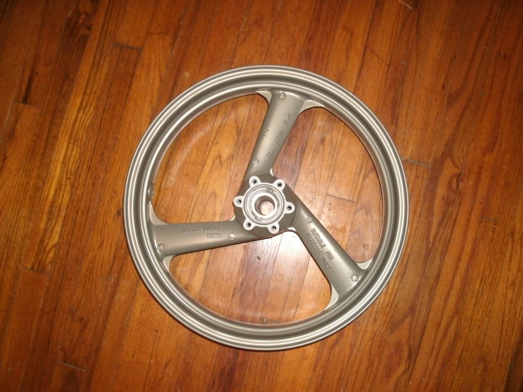

I could, but I'd like to wait until my winter teardown. The frame will have to be separated out, and it, the rear subframe, and front engine tube are going to be powdercoated. I'll weigh the wheels then. I must say they aren't the lightest option, but likely lighter than what I've heard about the stock skorp wheels.

Just got my first piece back from the powder coater. Looks pretty good. Bad news is he dropped my rear wheel and dinged the lip, so he sent it to a professional shop to be put on a machine and retrued. Go figure it had to happen to wheels that take a good deal of searching and hunting for.
