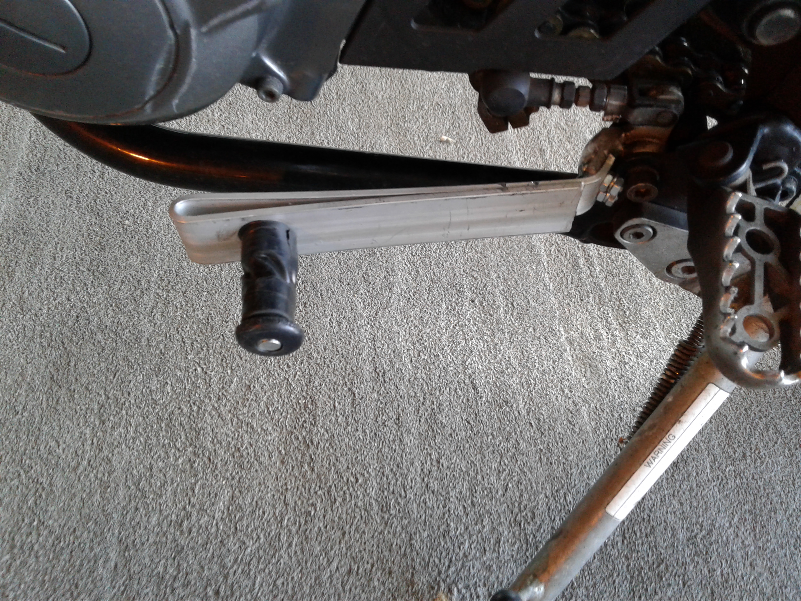

Postby seattleMZ » Wed Jul 19, 2017 2:05 pm
Not a lot of activity about shifters , so I'm adding my 2 cents.
After 9 years I decided to start riding to work on my MZ again. (Bad t-bone accident back in 2008 on my Aprilia made me rethink my priorities)
I've been working on my Baghira off and on over the last 6 years. Rebuilt the top-end, replaced banged-up parts (ebaying in Germany).
Yesterday on the way to my job the shift lever broke off. This was bound to happen since it's been welded once before. Luckily I was in 2nd and the bike has taller gearing than stock so I wasn't completely screwed.
I had to build a make shift lever last night by heating and bending some aluminum flat bar I had lying around(see PIC).
Now the hunt is on for a replacement...no luck! Apparently OEM levers are unavailable.
I searched several threads about alternatives but the information was never conclusive. Several people posted ideas, but those levers would never work due to frame interference(don't waste your time). The stock lever has a Z-bend for a reason moat other bikes use a more modern frame design that removes the lower frame tubes by using the motor its self as the bottom torsion support. That's why most of the levers are straight or just slightly turned out.
If there is anyone who has successfully fitted an alternative lever to a Baghira please share exactly what you used and the exact mods needed if any.
Thanks,
Michael
