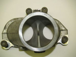

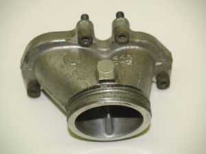

I didn't think that either Dale Walker or Galen Miller had any Skorpion single carb kits lying about for me to buy. I would like to get the dimensions for the single carb intake manifold so I can make my own, the photo posted by Mr. Jurgenson gives me an idea of its appearance, but not its dimensions.

the two pipes fit into the rubber mounts on the cylinder head as they are; that is simple enuf.
The carb is mounted in a Mikuni bolt-on (fits a Harley) mountso buy that first and then miter the tubing to match up.
The two first miters must also bend down so that the manifold is horizontal, otherwise the big carb will not fit under the Skorpion tank.

1) the Grizzly header does not fit. Neither of them.
2) one can make an adapter spacer; I have and have at one time or other uploaded pics; it is not a good alternative.
3) I bought all 5 of Galen's manifolds for HWE Motorsport in Karlsruhe. They are not for sale.
4) Except for Galen's complete kit, none of this is bolt on.
5) I cannot see any gain by using a BST40 instead of the stock Teikei, on the contrary. Why would anyone want to replace a slider carb for a single CV carb? Isn't the response sluggish enuf already?
6) the best and cheapest at the bottom line carb conversion for the stock or mildly tuned Skorpion is the Mikuni TM34-B65. Galen's kit was very good, but it was NOT cheap and it can no longer be had.
7) all of this and a lot more has been posted with pics and links umpteen times.

Bill gave me some good advice on my single Mikuni mod. The Grizzly manifold has the ports closer together than our head, thus needing an adapter of some kind. On the Baghira, there isn't room for the carb, so I had to cut a frame member and mount the carb around 6" back from the head where the air box used to be. It works and jetting is now simple and available. Niether were true with the stock carbs. If you search on my posts, you will see how I did it, and it won't take that long to find them. It looks like it would be quite a bit simpler on a Scorpion.

Thanks, I found the pictures of your mod. That's pretty much clears it up. It looks like it would be easier to fab a part just like the one in the Bikeworx kit. I can buy and/or make all of the parts with a hacksaw and file and have a friend weld it up.
