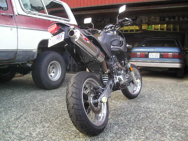

here's mine 8mm x 35 mm s/s allen drive bolt, saved me crashing in the dirt in a race.....

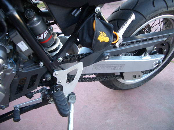

I just installed MZ 125SM footpeg rubbers onto my 660 Black Panther. They cost about $15 and popped right in place. Two benefits: decreased vibration thru the boot soles, and no more hooking my pant leg on the metal peg tabs. I also was scraping up my boots and leather pants now and then.
Here's a picture, it also shows my OnGuard disk lock. I'm trying out carrying it in the pouch (comes with the lock) ziptied to the frame. Sofar it's pretty nice. The lock was a heavy bulky item in my courier bag or pocket.
Review of the lock: Great lock, although the key is sloppy/fiddly which I do not like at all. I prefer my old Kryptonite, but am still waiting for them to send me the updated lock.
UPDATE: a new U-lock just arrived from Kryptonite for my bicycle - and they use same fiddly type of key as the OnGuard locks! ha! Also the OnGuard puch (see photo) is not holding up well, I fear my lock may fall out soon. Must find a new way to haul it. (updated 01Feb05)
