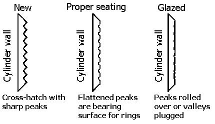

Sounds like your old friend was pulling some knowledge out of his rear end. If you want an engine that uses oil and doesn't make full compression, use your old rings. If you want an engine that's going to last, hone the cylinder, put new rings and do a break in on the new top end. All the oil that you need to lube the cylinder should be left behind in the tiny grooves of the remaining hone marks after break in. It's not much, just a layer that is a few molecules thick. Here's a link to the break in procedure that I used and a brief explanation of the method. http://www.ntnoa.org/enginebreakin.htm
Now that I've reread the posts, y'all were referring specifically to oil rings. I wouldn't think that anyone's oil rings would scrape enough oil off of the cylinder walls to negatively effect cooling and lubrication, but I'm no expert by any means. I just know that oil rings are very thin and weakly sprung compared to compression rings.
