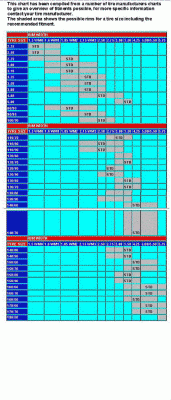

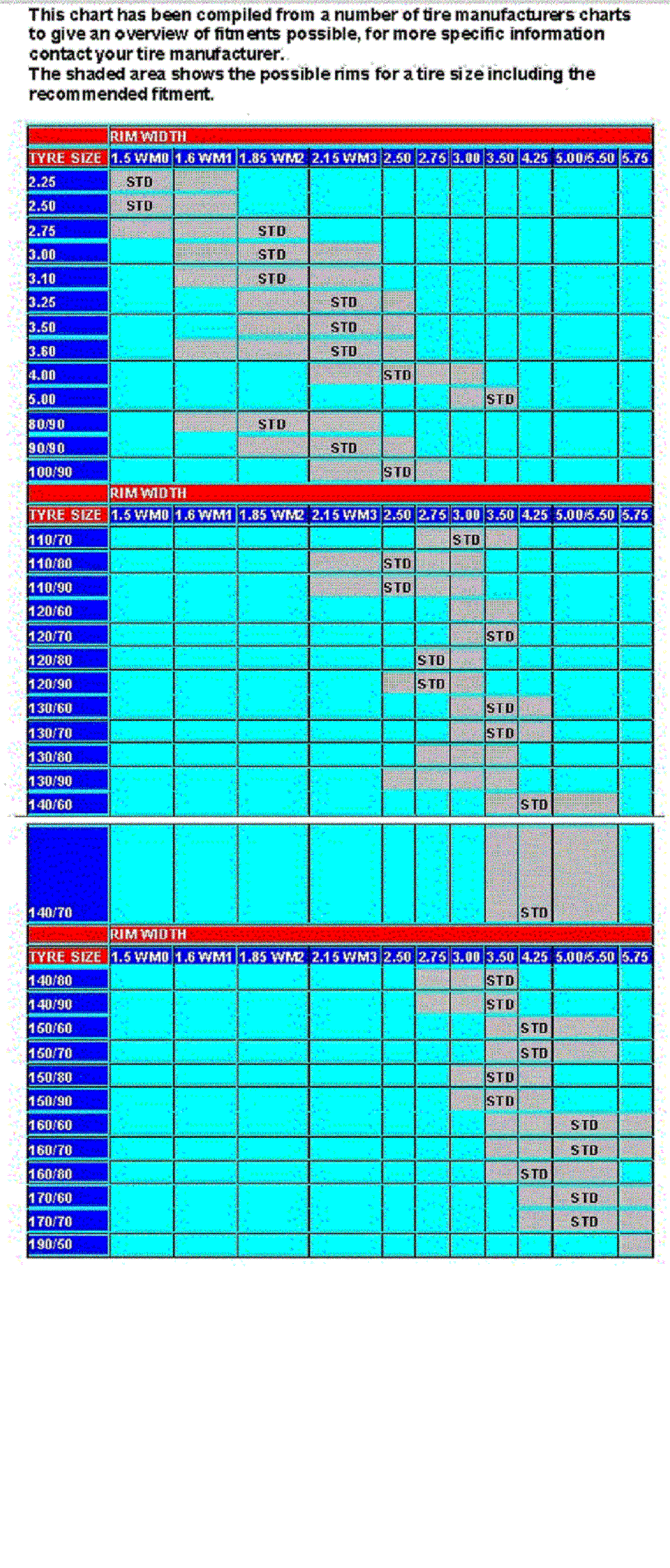

Postby Namikuz » Mon Apr 01, 2013 7:53 pm
Here is a tire chart compiled for tire and wheel sizes, both Radial and Bias ply, gleened from alot of different manufactures.
Some will be controversial and others make sence.
Let the screaming begin!!!!! :lol:
Click pic to enlarge.
Robbie(Namikuz)Stevens
Rev'em high....
Rev'em HARD!!!!!
Namikuz
Posts: 104
Re: Experiance with tires
Postby Bill Jurgenson » Tue Apr 02, 2013 2:04 am
Perhaps you could upload or link in a size that can be read, please?
Postby Namikuz » Tue Apr 02, 2013 11:08 am
Bill Jurgenson wrote:Perhaps you could upload or link in a size that can be read, please?
You should be able to click on the pic to enlarge as noted in post......?
If not LMK.
Link to the PDF http://www.mtsac.edu/~cliff/storage/gs/ ... _Chart.pdf
As noted.... RESEARCH your choise and find what works for you.... Remember.... Factory is always recomended, but not always optimal for what you want.
Postby Bill Jurgenson » Tue Apr 02, 2013 12:39 pm
then I hope you saw that
1) there is no 4" size (it is a bastard), and
2) 4.25 at least is the rim size listed for everything from 140/70 on up.
Just like I have repeatedly posted.
Bridgestone: 4,5" for 150/60
Pirelli: 4.25" 150/60 but then Pirellis are narrower than most others. The 150/60 SuperCorsa is only 143mm wide on the 4" rim and really does work.
On the race track a wider rim but only because of the much wider selection of tires. I used 3,5" front and 5" rear, both Marvic mag wheels.
On the 5" I ran a 165/55 Bridgestone slick or 160 Dragon Rain.
That is neither here nor there for riding on the street.
As many will know, I use a Brembo 3.5" rear wheel with a 130/70 tire (Heidenau K66) and Brembo 3" front with K66 110/70 on my Skorpion.
Probably, the availability of Heidenau tires is nill but It you can get them (K63+K64-front/rear or K66 both), they are very good.
I use this one:
http://www.reifenwerk-heidenau.de/modules/reifenliste/view.php?point=5&rtyp=17&profil=102&pic=59
Which has identical tread but a softer hi-silica compound making it a veritable rain tire.
