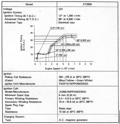

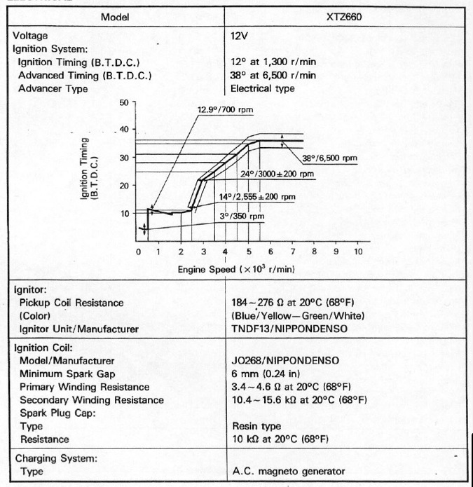

They run at 5-10º BTC some even at 0º where they have manual advance. When you consider this in the context of an engine undersquare to a ratio of 3:4, you can see that there is little pressure and certianly nothing exploding (i.e. burning uncontrolled). Add then the manhole-like flywheel anywhere from 10 to 25lbs and it i easy to understand.
the stock DENSO box advances to abruptly from 3º to 12.9º at 700rpm(that's 10º in a millesec.) and then remains relatively flat over what can be considered an idle range to 2500 and then climbs steeply from there to ridiculous heights. The flat section, that in fact dips, is the main reason for chain grabbing and funky idling, tho the balancer contributes a lot to the poor idle as I have said.

An embarrassment of information riches Bill! :smt112 Thanks for explaining that lot! I'd wondered what was wrong with the ignition timing on the Skorpion - it's obviously a bit radical ........... I'll save for a SilentHektik setup. Meanwhile, armed with that part number, I'm off the the local Yam dealer this morning for a new part.
I'm much obliged.
