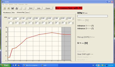

The Ignitech Sparker TCIP4 is fully programmable. You can set the ignition curve a you see fit and the limiter whereever you want.
here is an example of a curve I use:

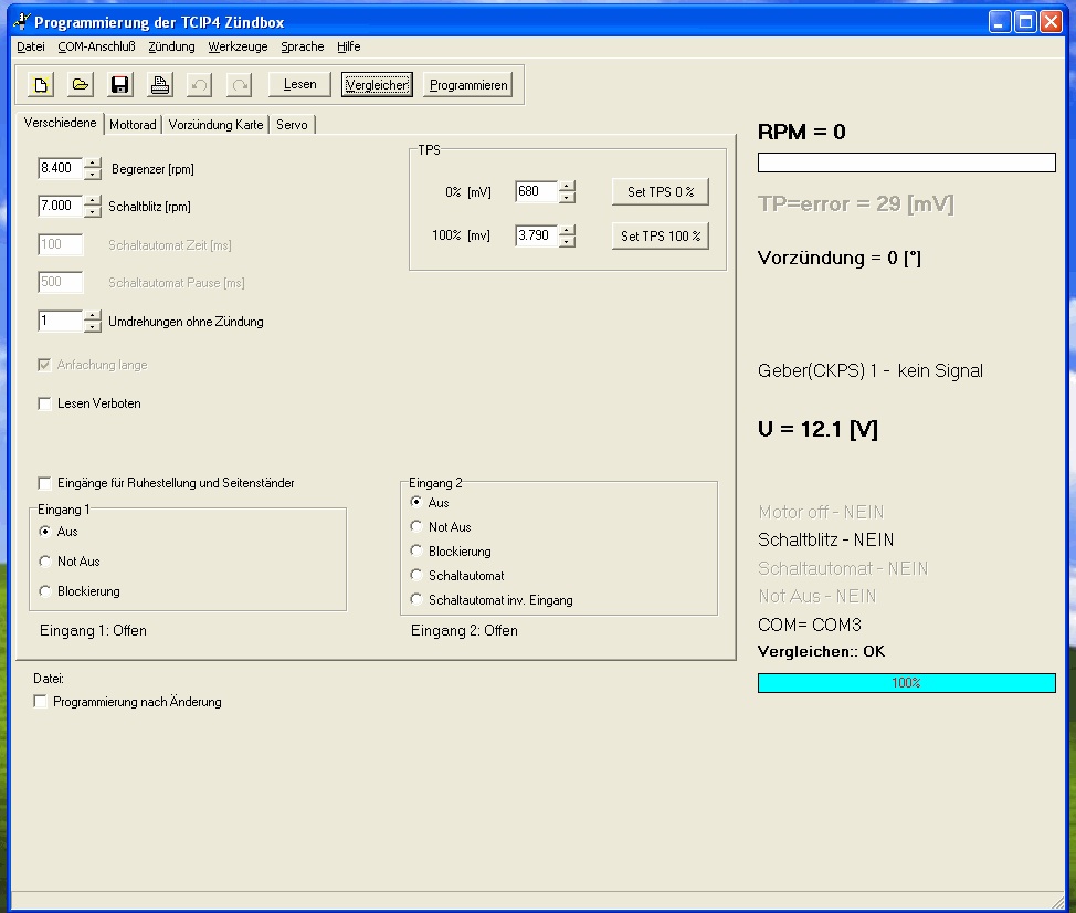

here is another page from the SW where things like the limiter are set, here to 8400 'cause the owner wanted it that low.

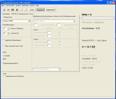

This is the page with basic settings. Yamah XT600 is the nearest stored curve and necessary for the basic pckup data but it is otherwise meaningless.
