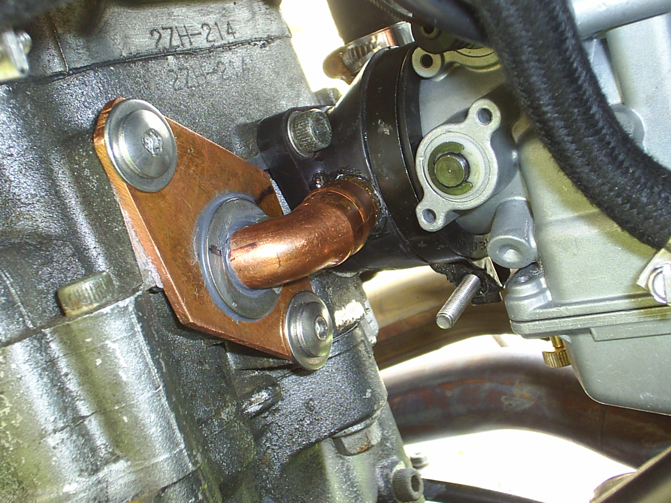

Postby breakwellmz » Sun Jul 26, 2020 5:44 am
Well here is the latest version.
Link port within head joining the two inlet ports has been blanked off so LH valve supplied only by what can be dragged through the 14mm ID copper pipe.
The engine feels freer(?) to rev without loss of bottom end, instant starting and solid idle, less banging on the over-run is a bonus.

Postby Puffs » Mon Jul 27, 2020 3:57 am
Nicely made... 14mm - standard waterworks pipe?
I'd guess that at throttle openings of just ¼th or less, all 3 intake valves see a similar flow, but when you open the throttle wider the majority of the flow will go through the 2 RH valves. At any rate, the LH intake channel will be throttled by the small pipe, so this mod should reduce the maximum power & torque values. It also makes me wonder if a 40mm carb is really required then.
But if the engine behaves better, it's still a worthwhile mod!
