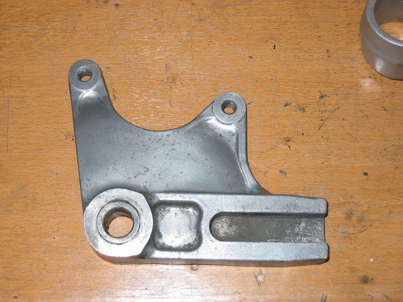

edfmaniac wrote:Thanks. I appreciate it. Since I realized that the caliper bolts to the outside of the bracket, unlike the original equipment, I've determined that the Ducati bracket could be made to work. My problem now is the diameter of the rotor. Evidently the SZR disc is smaller than both the Ducati and the MZ discs. Looks like I'm either going to have to wait on an SZR bracket to show up on Ebay or I'm going to have to come up with a custom built or universal type bracket. I've even offered finder's fees to a few bike breakers in Europe and still haven't heard anything.
Give these guys a try http://stores.ebay.co.uk/BA-Bikes?_trks ... 7675.l2563 , I got stuff from them and found them very helpful and they have several SZR/MZs in bits

That's who I purchased my Brembo wheels from. They already sold the bracket. :(
Postby twinlinemoto » Tue Mar 01, 2016 11:28 am
Correct me if Im wrong, but I believe this bracket is the same as the Ducati 620/750/900 monster and 750/900 supersport. These models all use the same brembo wheels and calipers... might be worth a check?

Postby edfmaniac » Tue Mar 01, 2016 1:30 pm
Close but not the same. The diameter of the brake rotors are different, the axles are different, the offset between the planes of the brake caliper and wheel spacer surfaces are different, and the thickness at the axle is different. I can work with all of those except the rotor diameter. If I can't find the correct bracket, I'll probably have one made that will be all one piece, instead of a mass of bushings and shims etc.

Damn, I thought that would have been great. Is the SZR the only one with that rotor diameter? If you didn't already have SZR wheels, would the ducati wheels work?

http://www.ebay.co.uk/itm/Yamaha-SZR-66 ... SwJcZWc5Wp

Postby edfmaniac » Tue Mar 01, 2016 6:54 pm
That's it!!!! That's the part I need. The seller says they won't ship to the USA but I have sent them a message begging them to reconsider. If they decline, would you be willing to help a fellow MZ fan out and be the middle man, assuming they will ship to your country. I would reimburse in some way of course. This is a very hard to find item.
