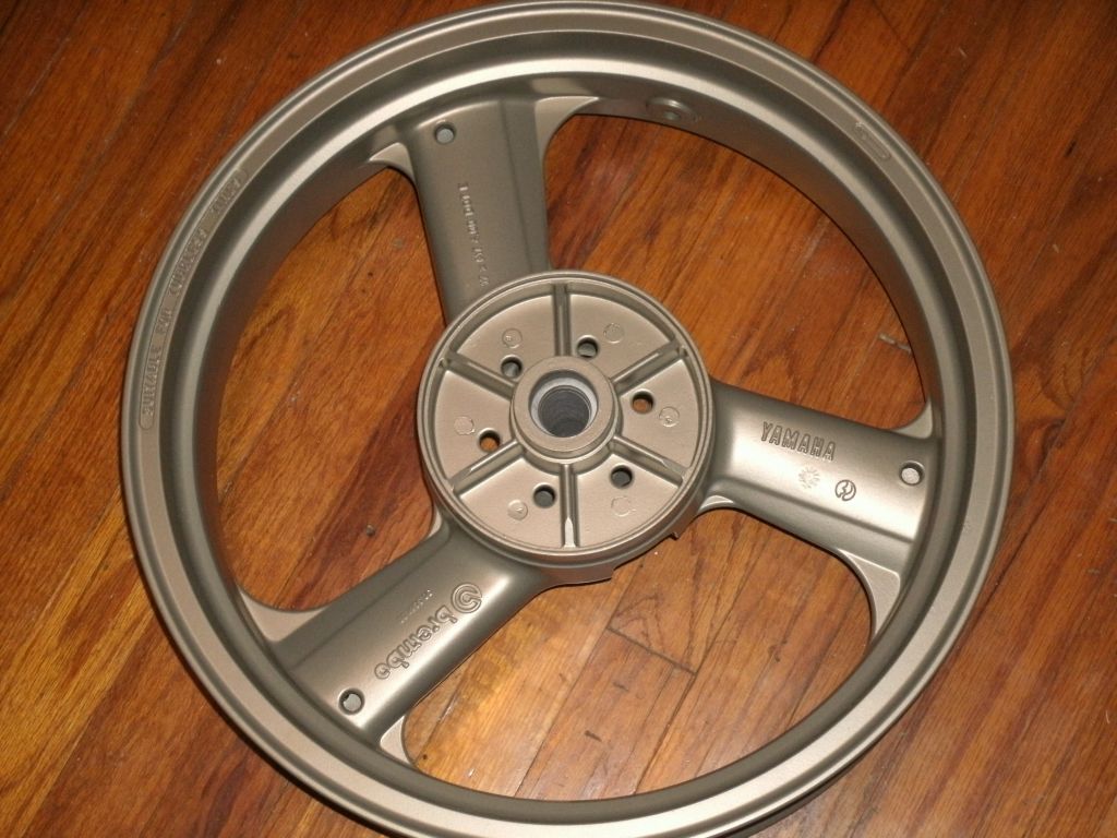

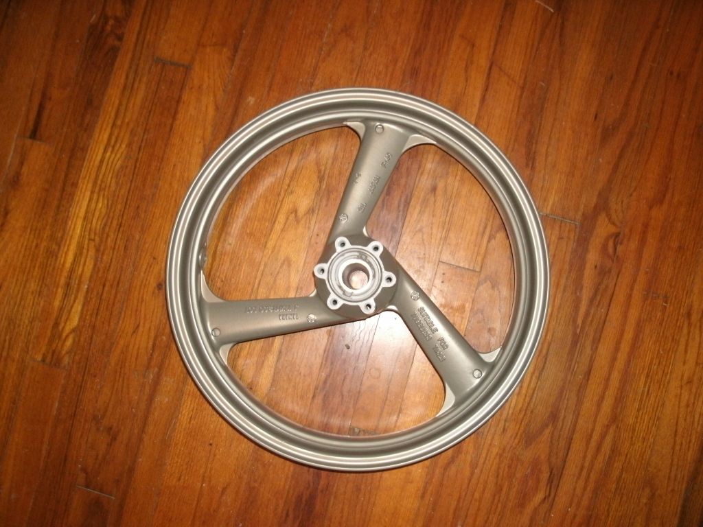

Postby edfmaniac » Tue Nov 17, 2015 2:12 pm
Brembo wheels are here and in good shape. Early Christmas for me. :D

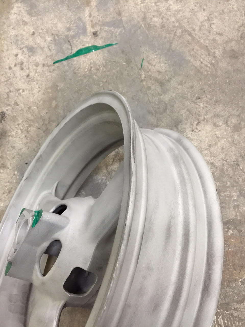

Postby edfmaniac » Wed Feb 03, 2016 10:30 pm
Both rims are done now. :D
The rear got dropped by the powder coaters but they sent it to a pro for straightening. The tech at that shop said it was one of the smallest flat spots he's ever had to fix so I'm not too upset about it. :|

Postby edfmaniac » Thu Feb 04, 2016 6:28 pm
There is no direct bolt on wheel swap that I know of. They all take specially machined parts and/or alternate parts to make work. The Brembo's from the SZR had been done before and came recommended due to their light weight, so I picked up a set when I found them online. Now I just need to find the right caliper carrier for the rear and I'll be ready to start fitting things in place.

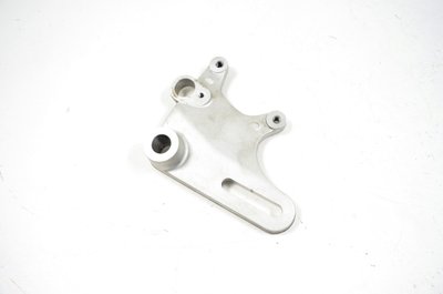

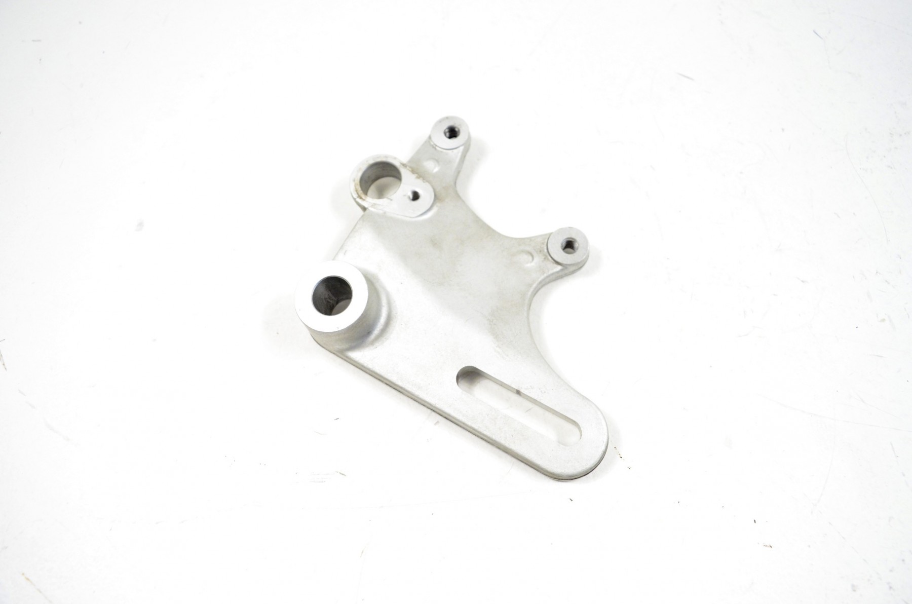

Postby Hajok » Sat Feb 13, 2016 5:15 pm
Instead of an original SZR caliper hanger maybe this is compatible:
It's a Ducati 620 monster part. Caliper is the same and dimensions seem to be close. Worth a visit to your local used parts guy?

Postby edfmaniac » Sat Feb 13, 2016 10:16 pm
Looks very similar. Thanks for the tip.
Postby edfmaniac » Sat Feb 13, 2016 10:34 pm
Looks like Ducati has all kinds of hangers and carriers that look very similar. I just picked up one for $11 plus shipping and we'll see how it works. Thanks. I might ask you for some measurements in the future. :wink:

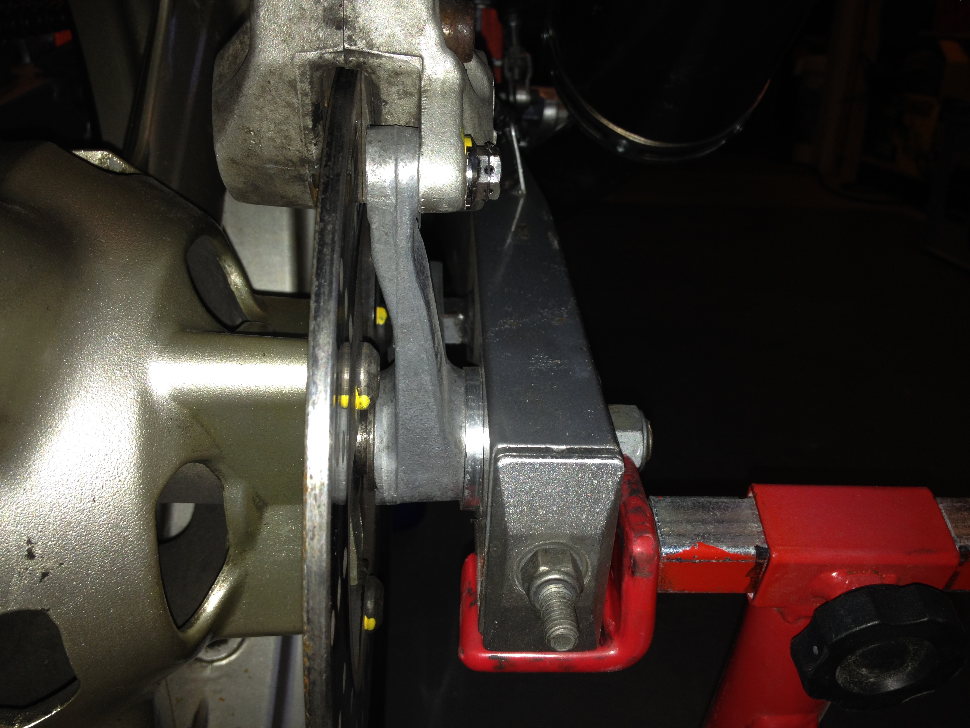

Postby edfmaniac » Mon Feb 22, 2016 3:37 pm
I thought I lucked out and found the right Ducati bracket but there's too much offset in both of the ones I picked up to be compatible with the Skorpion.
Hajok, any chance you could measure the offset between the plane where the caliper bolts to the bracket and the plane where the wheel spacer meets the bracket? From the pic you sent, they look almost even with each other. Thanks.
Postby Hajok » Fri Feb 26, 2016 12:04 pm
I missed your post completely; sorry for the delay!
The offset is 11mm. The wheel side of the flange at the axle (where it meets the wheel spacer) is exactly in the same plane as the backside of the caliper bracket. The thickness of the bracket at the caliper is 11mm; therefore the offset from the caliper plane to the wheel spacer is this distance. The hanger width at the axle is around 25mm (hard to measure exactly). The hanger curves around the disc bolts about 6mm.

Postby edfmaniac » Fri Feb 26, 2016 12:59 pm
Thanks. I appreciate it. Since I realized that the caliper bolts to the outside of the bracket, unlike the original equipment, I've determined that the Ducati bracket could be made to work. My problem now is the diameter of the rotor. Evidently the SZR disc is smaller than both the Ducati and the MZ discs. Looks like I'm either going to have to wait on an SZR bracket to show up on Ebay or I'm going to have to come up with a custom built or universal type bracket. I've even offered finder's fees to a few bike breakers in Europe and still haven't heard anything.
