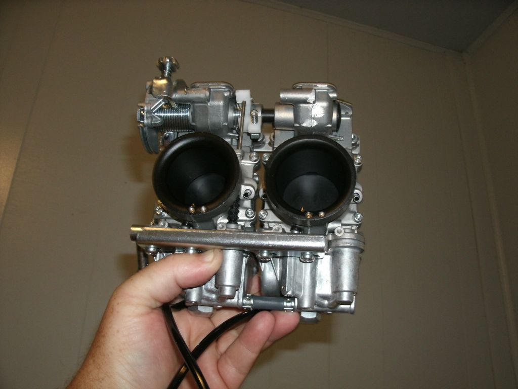

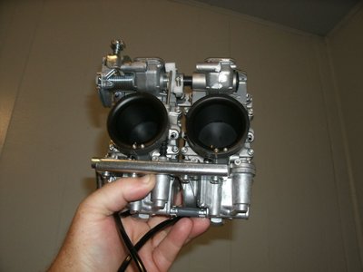

After spending more than 3 weeks in route, my carbs finally arrived in the US and are headed my way. It's been a frustrating couple of weeks trying to figure out where they were but they are finally on the move again. Hoping to be running by the weekend if Topham did a good enough job on guessing jet sizes.
Postby edfmaniac » Mon Jun 23, 2014 11:40 am
It's here. Probably going to take a day or two to get everything in line as far as final mounting, cabling, and air filters.

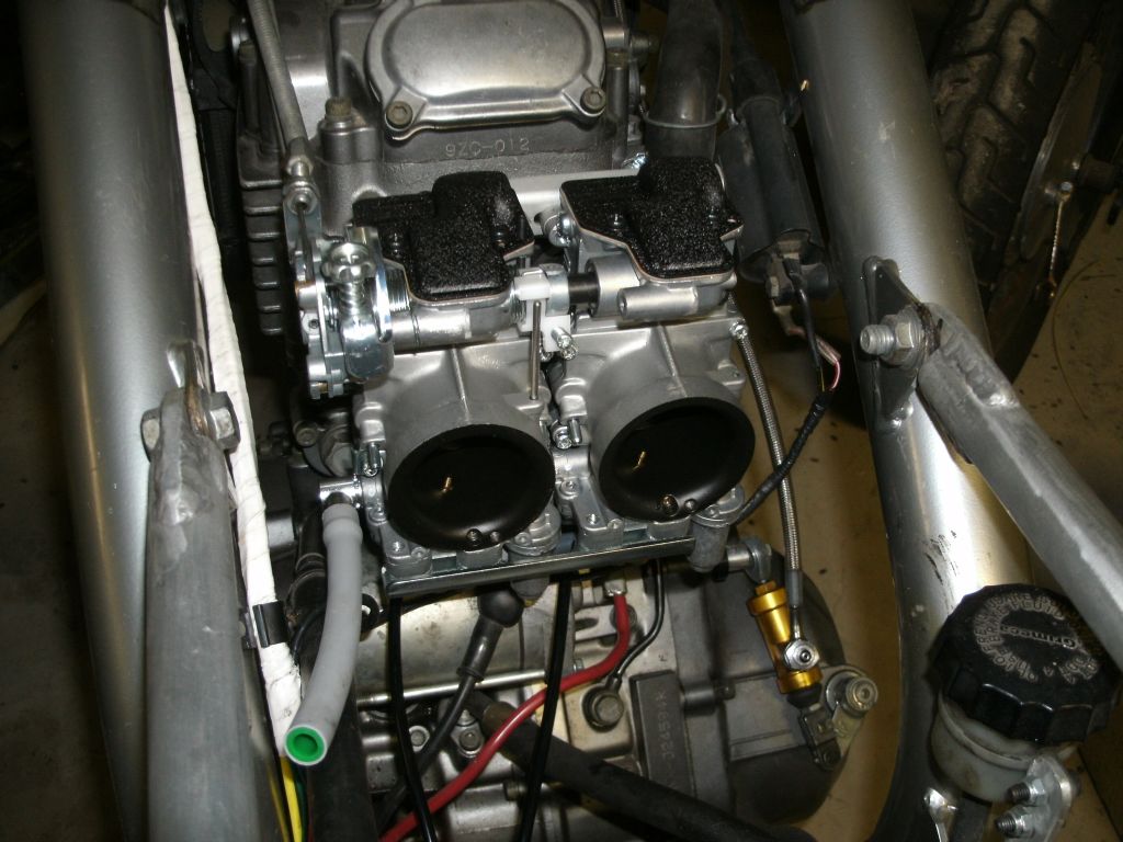

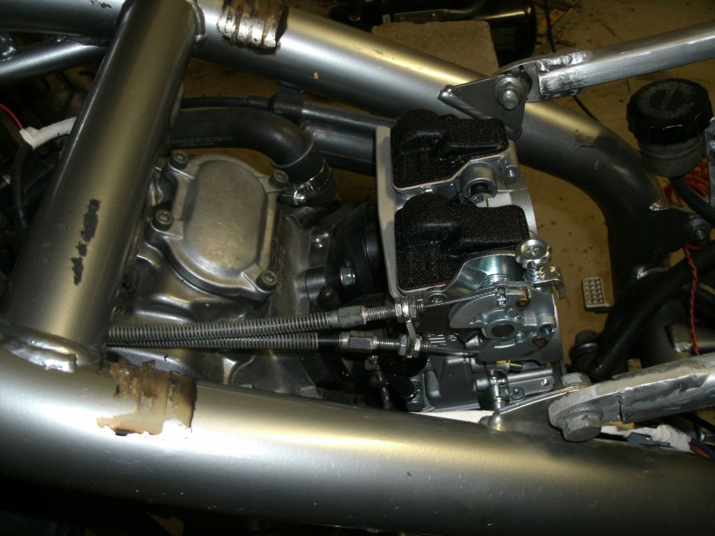

The left side carb boot needed some more Dremel tool work because the minimum spacing on these carbs is 70mm and the center to center spacing on the stock boots are 65mm. Also the diameter on the boot was a little on the small side so I enlarged the ID and did all my work so that the new center would move as far to the left as possible. Cables were completely compatible, just a little long. Use the extra slot that is provided on the throttle pulley to take up as much cable as possible. Filters are on order and I discovered that the petcock on the tank I'm using was right where the throttle pulley is so I had to cut off the valve part of the petcock, add a brass tube in it's place and install an inline fuel valve. Once I determined that the bowls weren't leaking after turning on the fuel, I decided to fire her up. :D :D :D So far so good. Idle is solid as a rock. We get to see how she does out on the road in the next few days. Can't wait to see if these solve my problems above 7500rpm.

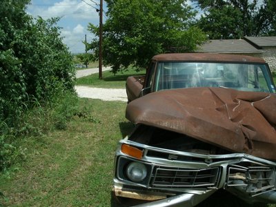

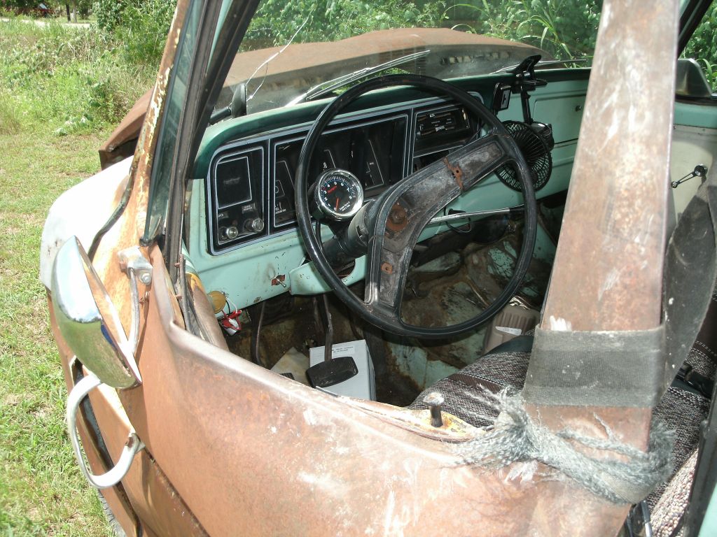

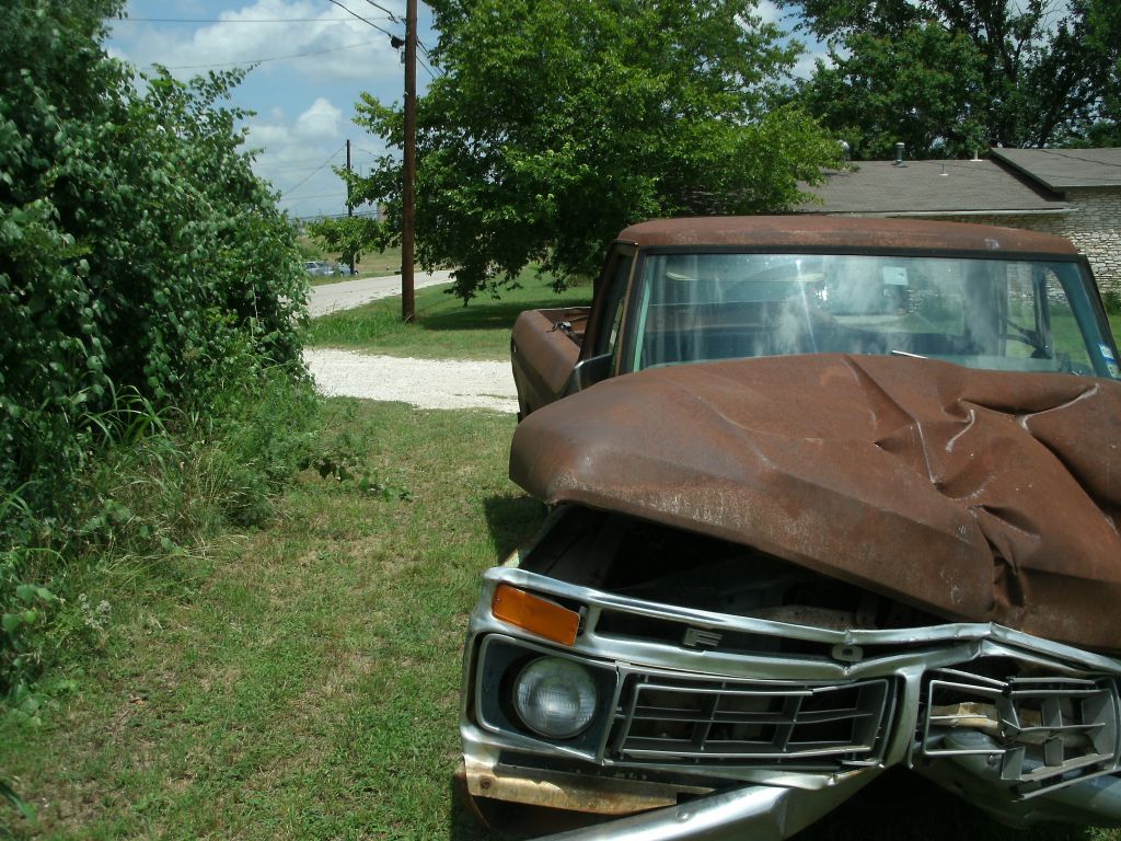

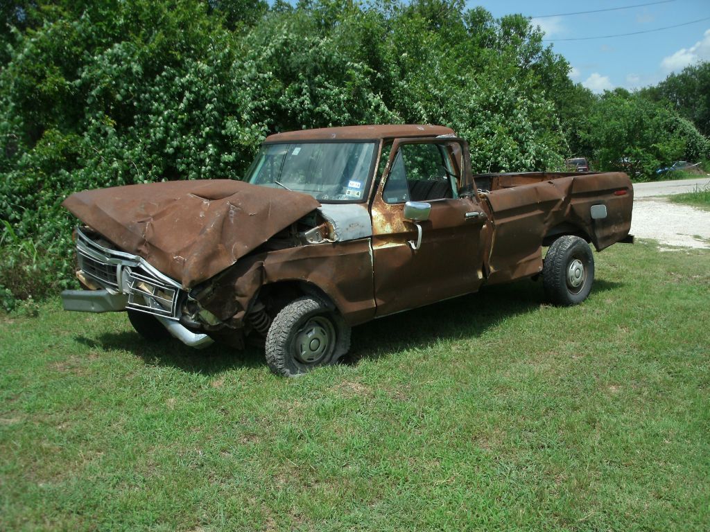

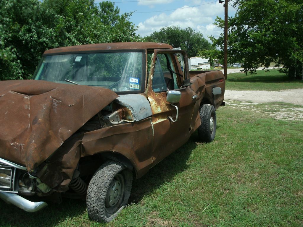

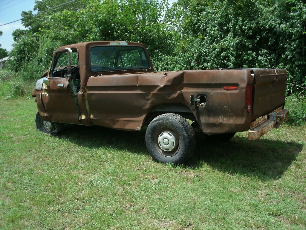

I was on my way to pick up my UNI filters when some jackass blew his red light about a full 15 sec after it turned red. I could be really upset that I just rebuilt everything from the pressure plate on the back of the perfectly running straight 6 all the way back to the rear u-joint, but I walked away with only bruises and scratches. So no, I haven't ridden the MZ yet. Too damn sore.

Postby Srinath » Sun Jun 29, 2014 10:11 am
Oh jeez that looks horrible.
Its a good advertisement for those 70's metal monsters tho.
Drunk driver running the red ?
Crackhead ?
Cool.
Srinath.
Srinath
Posts: 332
Location: Charlotte NC
Postby edfmaniac » Sun Jun 29, 2014 10:16 am
I would put my money on cell phone texting. He was young and appeared to be sober.
Postby edfmaniac » Sun Jul 06, 2014 1:54 pm
Mikunis are in and running good. I was expecting to notice a distinct increase in acceleration on the top. But instead, the power is very linear. There is much more bottom and mid range so the top end charge doesn't stand out anymore. It's just strong everywhere with instantaneous response. Next step is to order a few main jets and head to the dyno. :D
