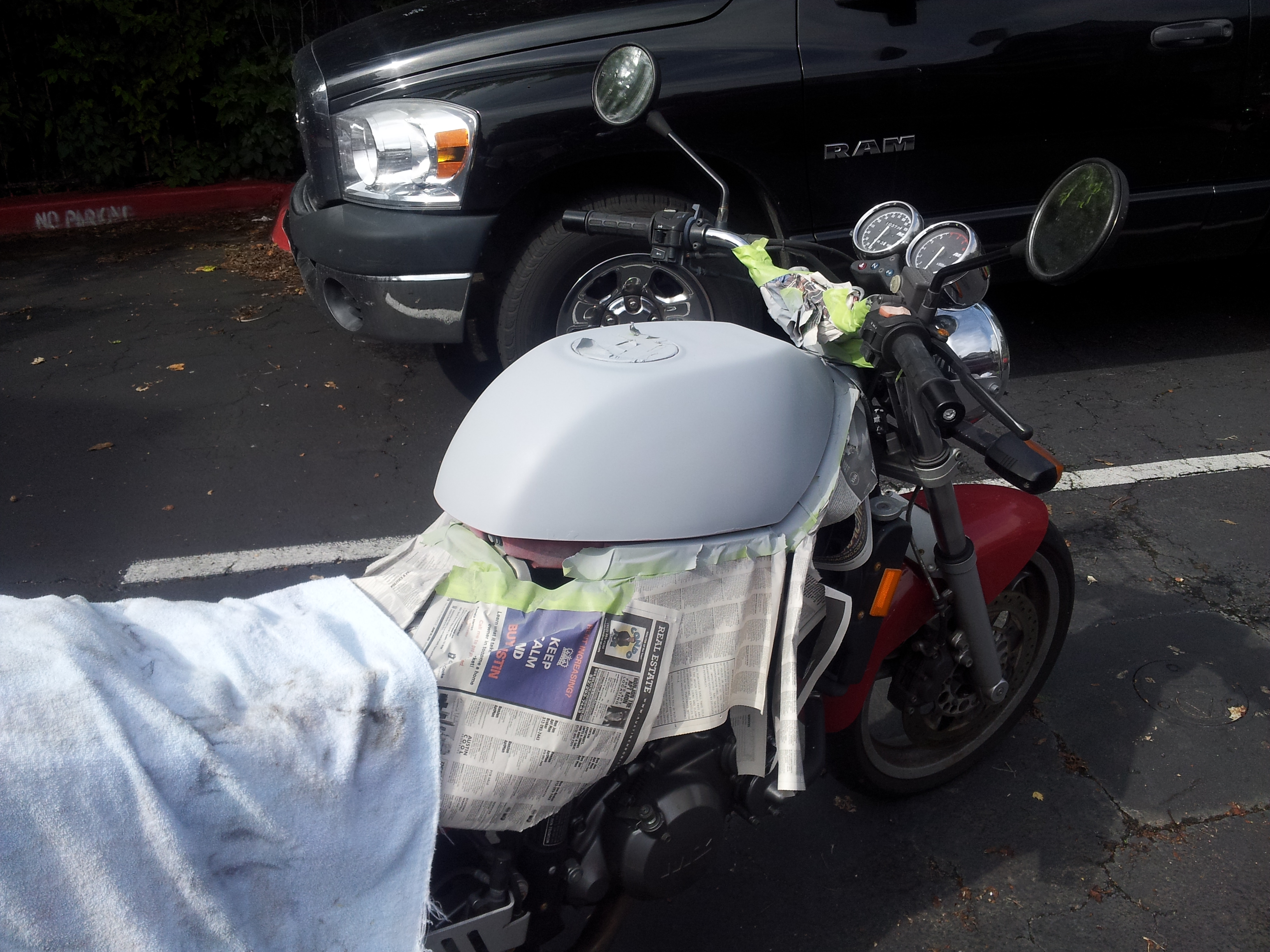

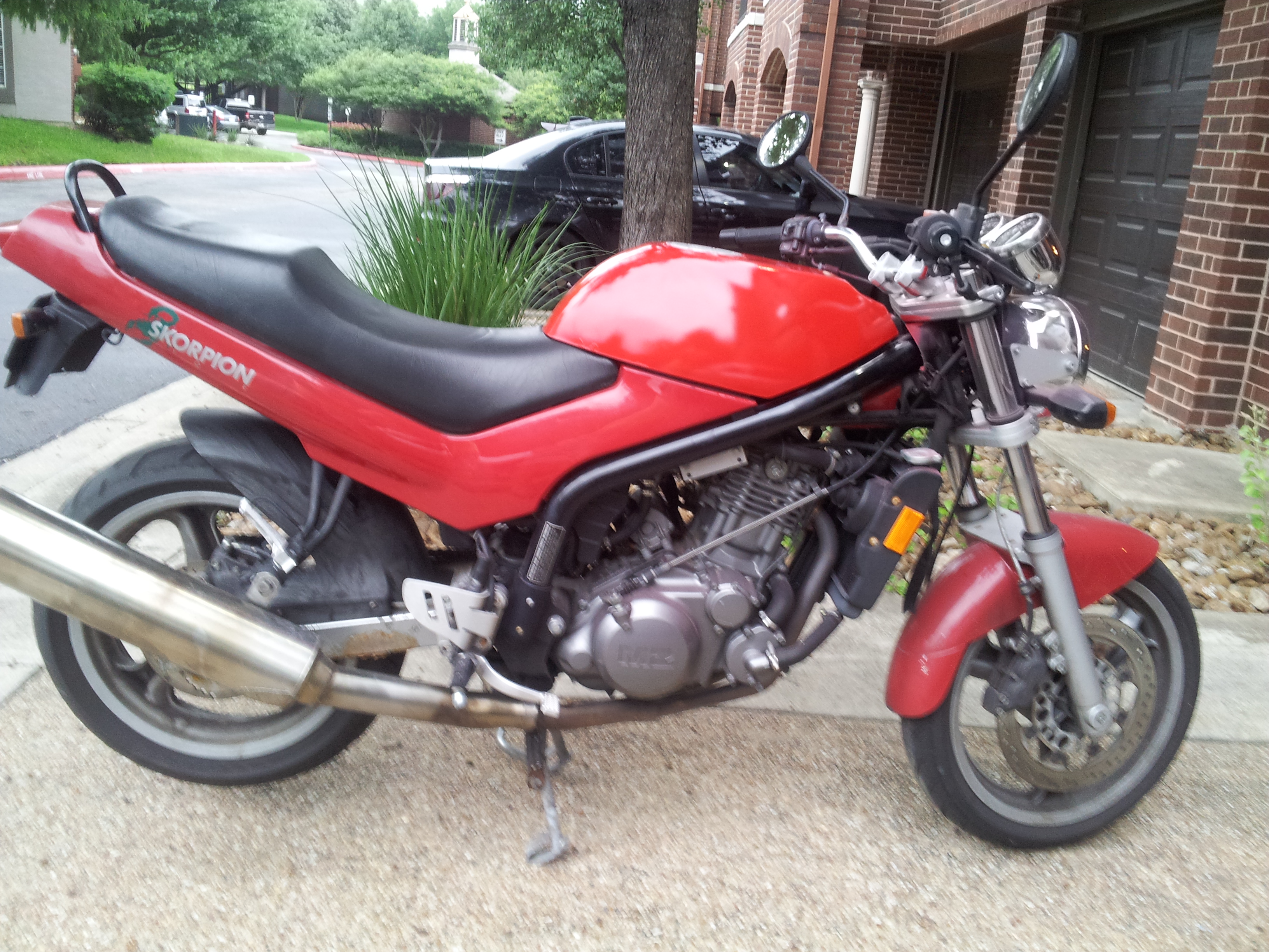

Well, you talked me out of taking it in for pro paint. I spent the first day that it has mostly not rained prepping, priming and painting the tank. I ended up using Duplicolor Victory Red, left the tank on and masked everything. Much better than the disastrous look with all the paint peeled off. Will probably buff it in a bit and put more clear coat once the whole thing cures a bit. Thanks for the inputs and suggestions.

That did turn out nicely. Buff and clear will be even better.
Mine was repainted by the PO, no Skorpion stickers...gonna have to find or make up a set.
