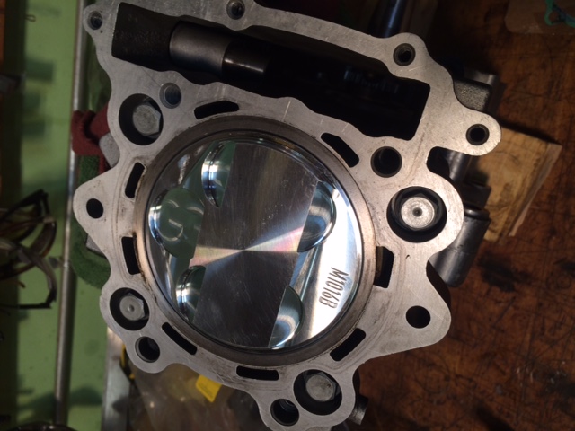

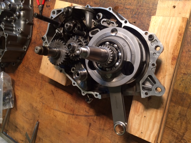

I didn't have to do a lot but I wanted it done right, and without the possibility of the engine tearing itself apart the first time I get the rpms up near the redline. Aftermarket pistons are supposed to be built to exacting specs, but a half millimeter of stretch in the rod and a half millimeter of piston rock and you can kiss your sweet build goodbye without measuring first. It's just the smart thing to do which is why most professional engine builders check clearances. I'm guessing your valves will be ok with that cam but checking the squish would be smart. No less than 1mm is what I was told by Bill J. I fudged a little and stopped at .90mm, and that was after adding an extra gasket at the base of the cylinder to raise the deck height. Without having done this my piston would certainly have been kissing the head at 8000rpms. Head was resurfaced after full rebuild and porting but that won't effect deck height. Cylinder was bored but not resurfaced. Good luck and don't forget to measure the thicknesses of the different gasket sets you use when making your measurements vs. final assembly. My final assy gaskets were just a little thinner than my used gaskets that I used to make measurements. That's why I estimate my final squish at .90mm instead of 1mm if memory serves me correctly.
