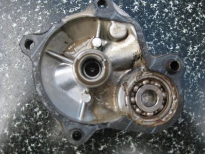

This is where I am so far. I pulled the starter out and fired it up no problem. It had loads of torque. Removed the cover plate that the starter sits into and I found the bearing that it mates with totally seized (image below)
[img][IMG]http://imageshack.us/a/img341/4066/img1421te.th.jpg[/img][/img]
I will endeavour to purchase one and get my local garage to remove and fit the new one.
So I think that’s another problem hopefully solved. I am now just left with a possible clutch issue. Looked at the case covering the clutch and it looks like a bit of a pain to remove, what with the oil filter and water pumps needing to be taken out.
Thanks for your kind offer Ian. I have friends over next weekend so will be busy then.
I will get the starter problem resolved and work from there.
i loaded the real pic so we have it when the link dies DAVE

Grahame's list this as a 6200 bearing.

Re: Unable to crank over Skorpion after 18 month lay up
Postby samandkimberly » Sun May 05, 2013 7:17 pm
Wow, that was a tough one to diagnose, congratulations! Any idea why there was enough moisture in thereto seize the bearing?
I'd bet that the clutch problem sorts itself out once you get it running. I'd *definitely* change the oil real soon though.
Sam
Postby radiograf » Mon May 06, 2013 2:06 am
Condensation from the air, and not running the engine for long enough to boil it out of the oil. Especially in winter when its more humid, and cooler so the engine doesn't warm up as fast.
Postby maxgain » Mon May 06, 2013 7:25 am
Thanks guys. I shall have to replaced the oil and filter once its running. Hopefully the clutch will free itself once running. I did a search on stuck clutches and it was suggested to rev the bike up on centre stand in a lowish gear and lock back wheel with the rear brake whilst applying throttle to break the clutch free. Thanks for all your advise. I am hopefully off to Fowlers in Bristol tomorrow to see if they have a Yamaha bearing I can replace it with. Then to my local bike specialist in Caldicot to pull and replace the bearing. Hopefully a quality oil change may stop the problem happening again anytime soon.
