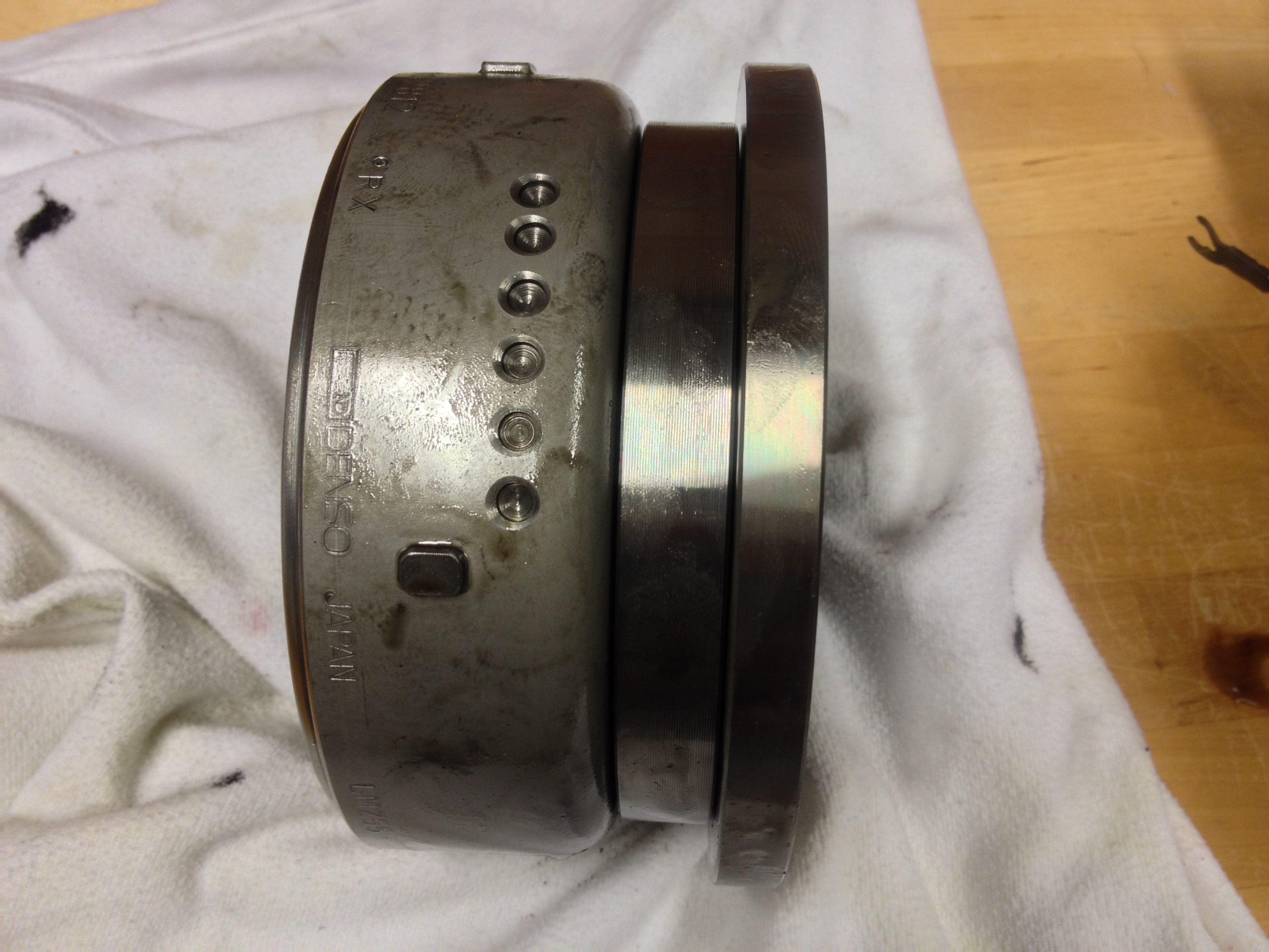

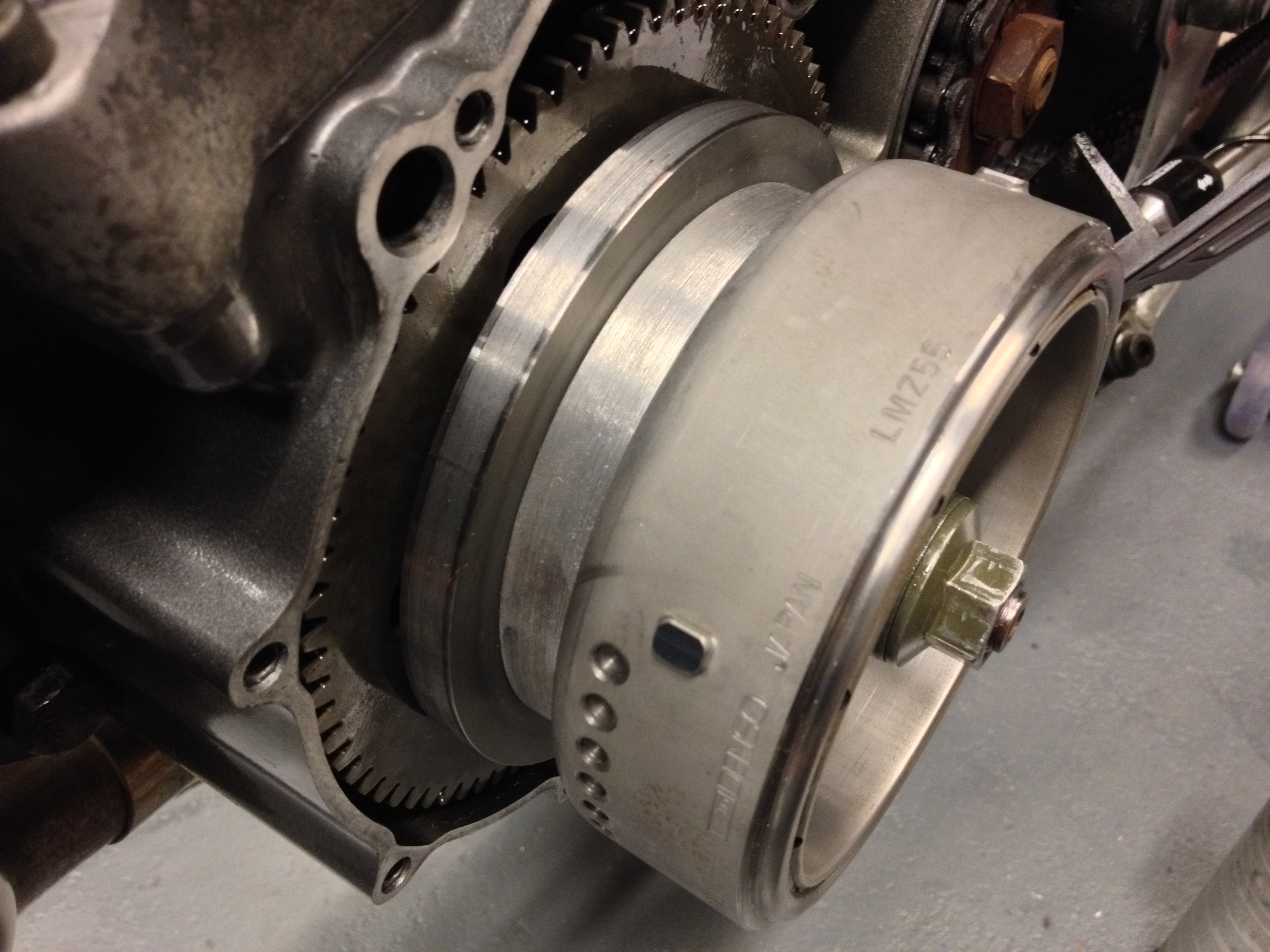

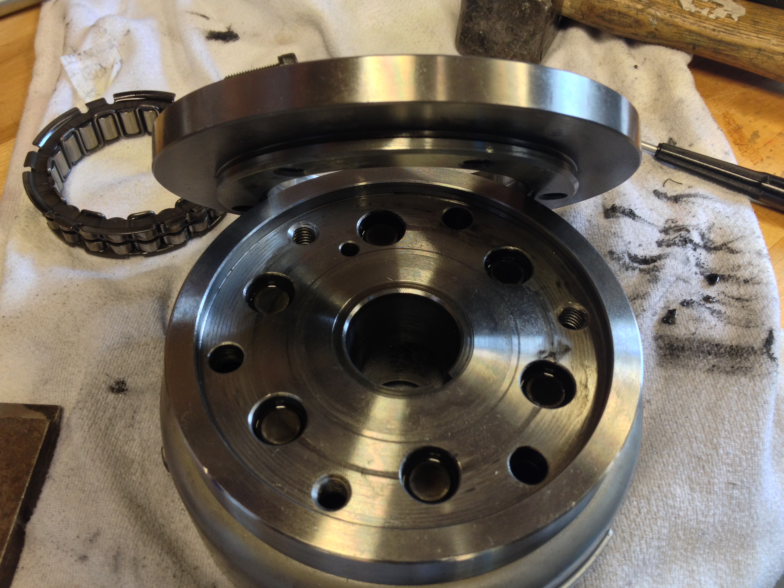

A few days ago I finally found enough courage for pulling the flywheel. I stressed the Kedo puller to the max and -with a bang- the rotor/flywheel assembly came loose. And with a bang my forehead hit the fueltank. Ouch.
Original
Original
Minus 309 grams :-)
Boxing day was used for some hours well spent at my dad's lathe. I removed 5 mm (3/16") from the center piece radius, leaving the shoulder for easy centering of the assembly. The flange with the one-way bearing is a pain. Even with a new carbide chisel it took ages removing a substantial amount of material. So after removing 3 mm (1/8") I called it a day. I aimed for the "Bill Jurgenson" aluminum flange design, but that would take ages. Still, in total 309 grams (0,68 pound) is removed.

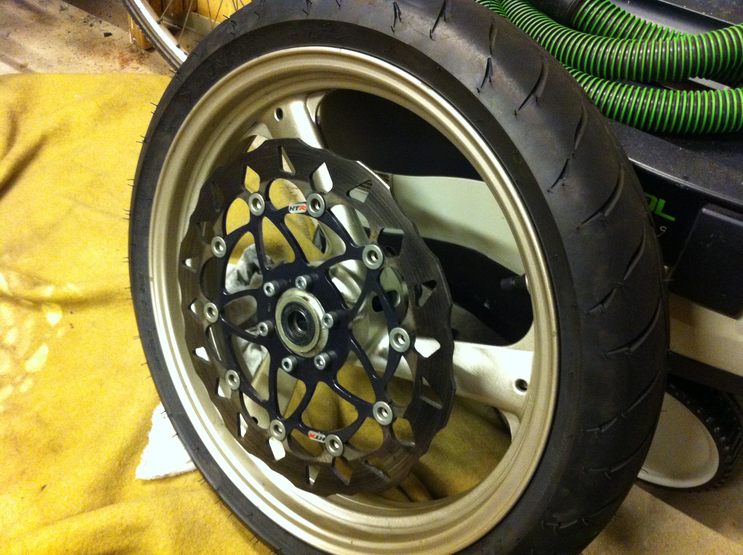

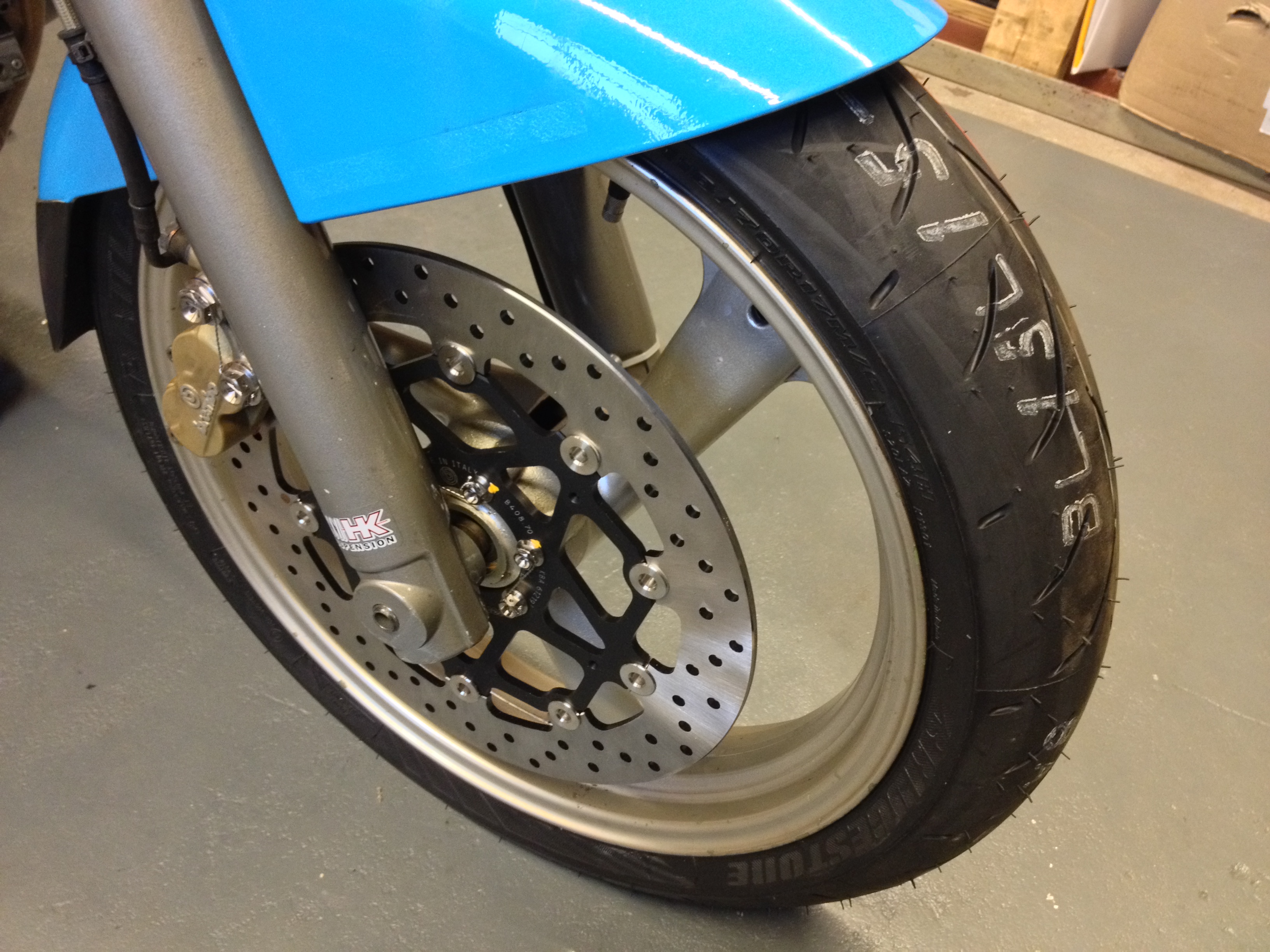

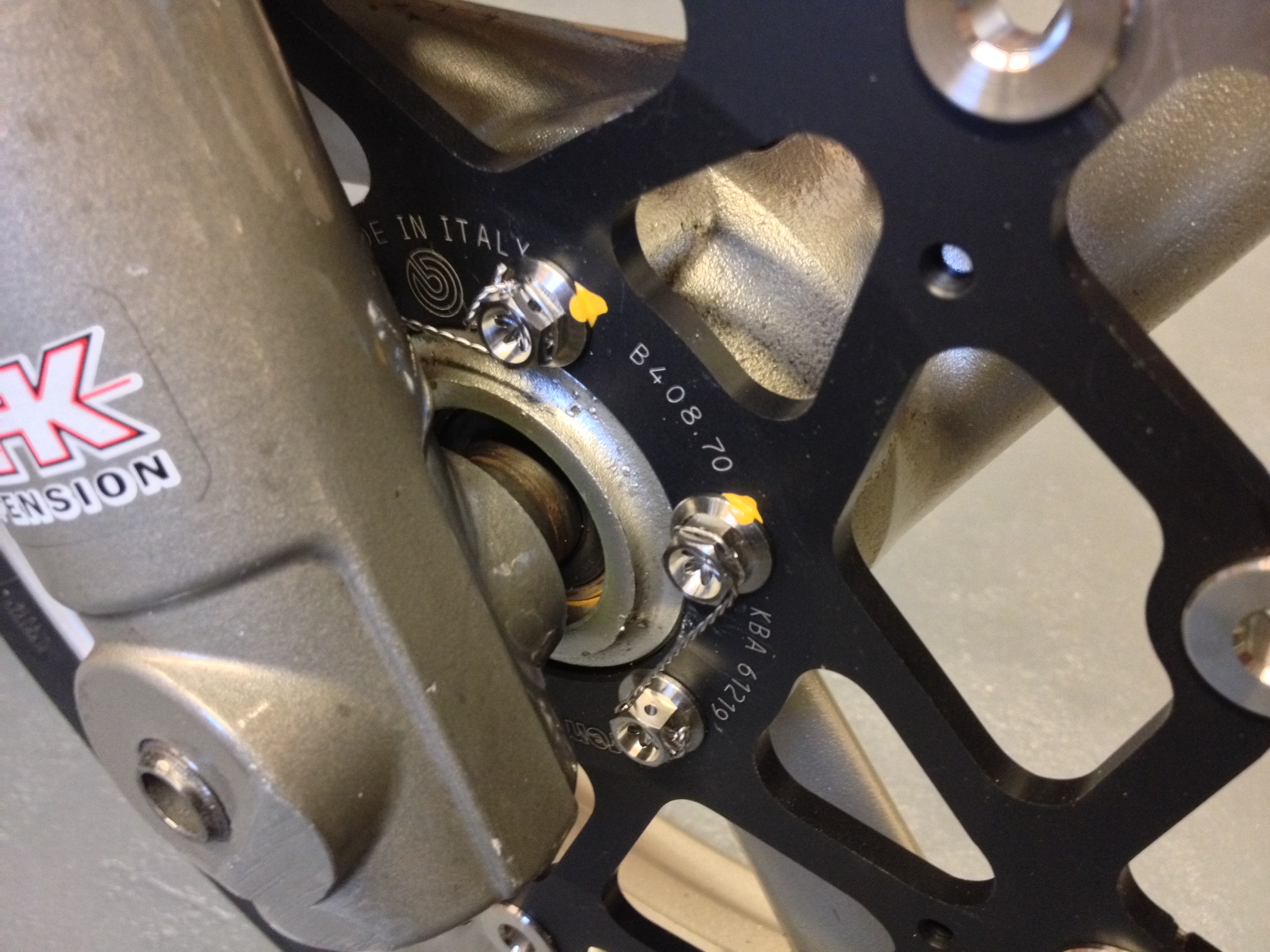

After some issues with a vague spongy brake lever feel I decided to swap the front disc for a brand new Brembo Serie Oro disc brake and installed new Brembo "SA" brake pads. With a pricetag of only € 159,- I ordered the disc directly from Italy based Carpimoto.
Spiced it up a little with some grade 5 titanium bolts and secured it with Goodridge locking wire.
The former HTR disc is definitely lighter (over a pound!)
But worn askew due to the large holes near the rotor. Pity, it looked ok.
Already the lever feel has been improved. The semi sintered pads should enhance the initial response as wel, so I'm curious what the experience will be after bedding pads and disc.

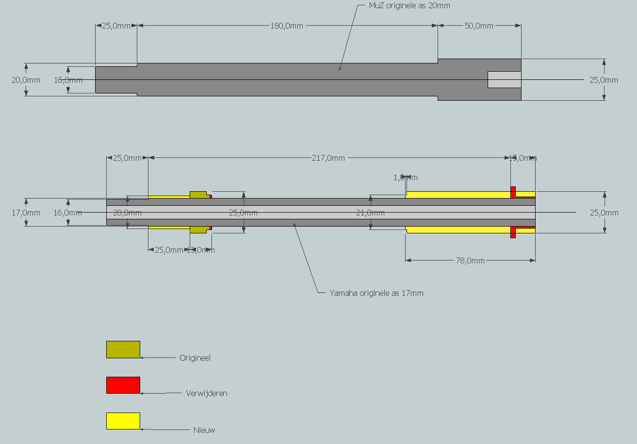

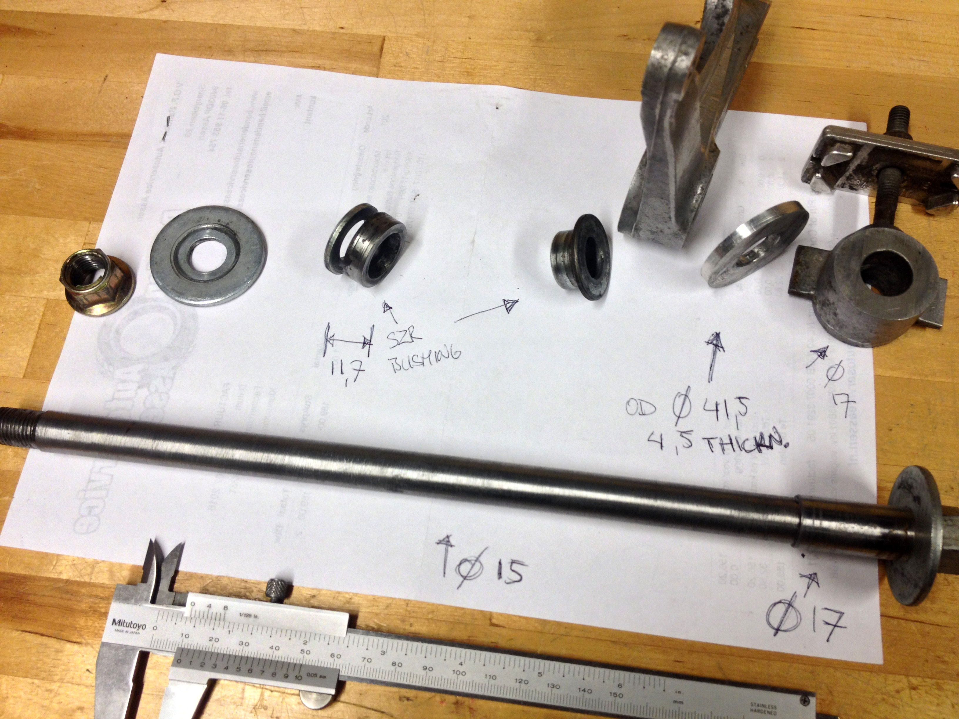

@edf:
The SZR conversion needed a different approach front and rear. Front:
Top axle is the original MuZ Grimeca. The lower drawing is the (original) SZR axle conversion. Red is removed material (bolt head), yellow is new parts. The greenish bushing is an original SZR bushing slighty turned down for proper alignment. The right yellow in the drawing part is a 25 mm aluminum bushing shrink-fitted around the 17 mm SZR axle. It still slided around the axle when installing the axle. So a put a 5mm steel pin through the bushing and shaft. The left thin bushing in the drawing is pressed into the right fork leg. All these parts came from a scrap metal bin...
As you can see the tacho drive isn't used here...
Rear axle:
I made a complete new 15 mm axle (chromo vanadium alloy) exept the right part which is 17 mm.

Postby Hajok » Thu Feb 04, 2016 3:34 pm

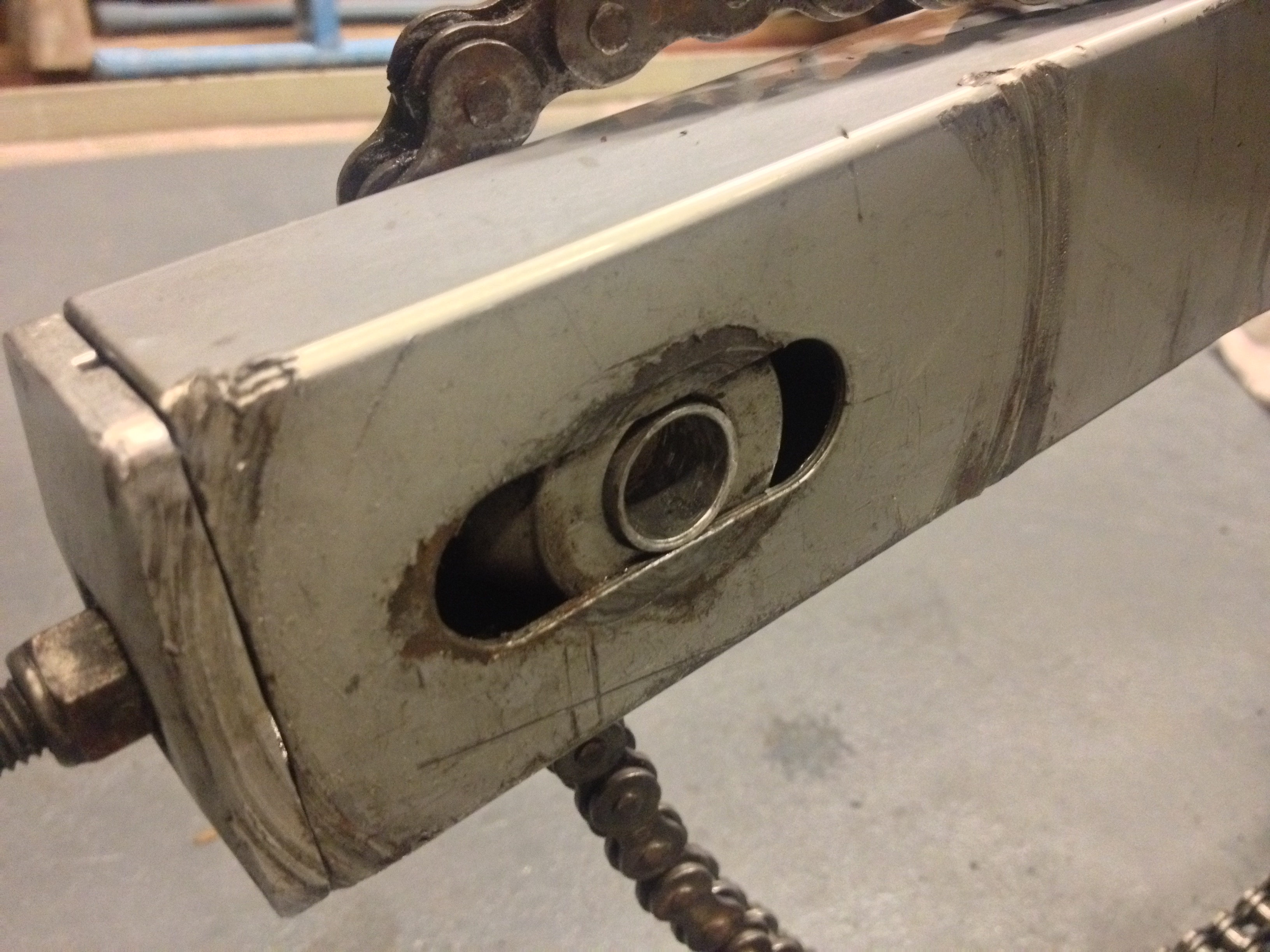

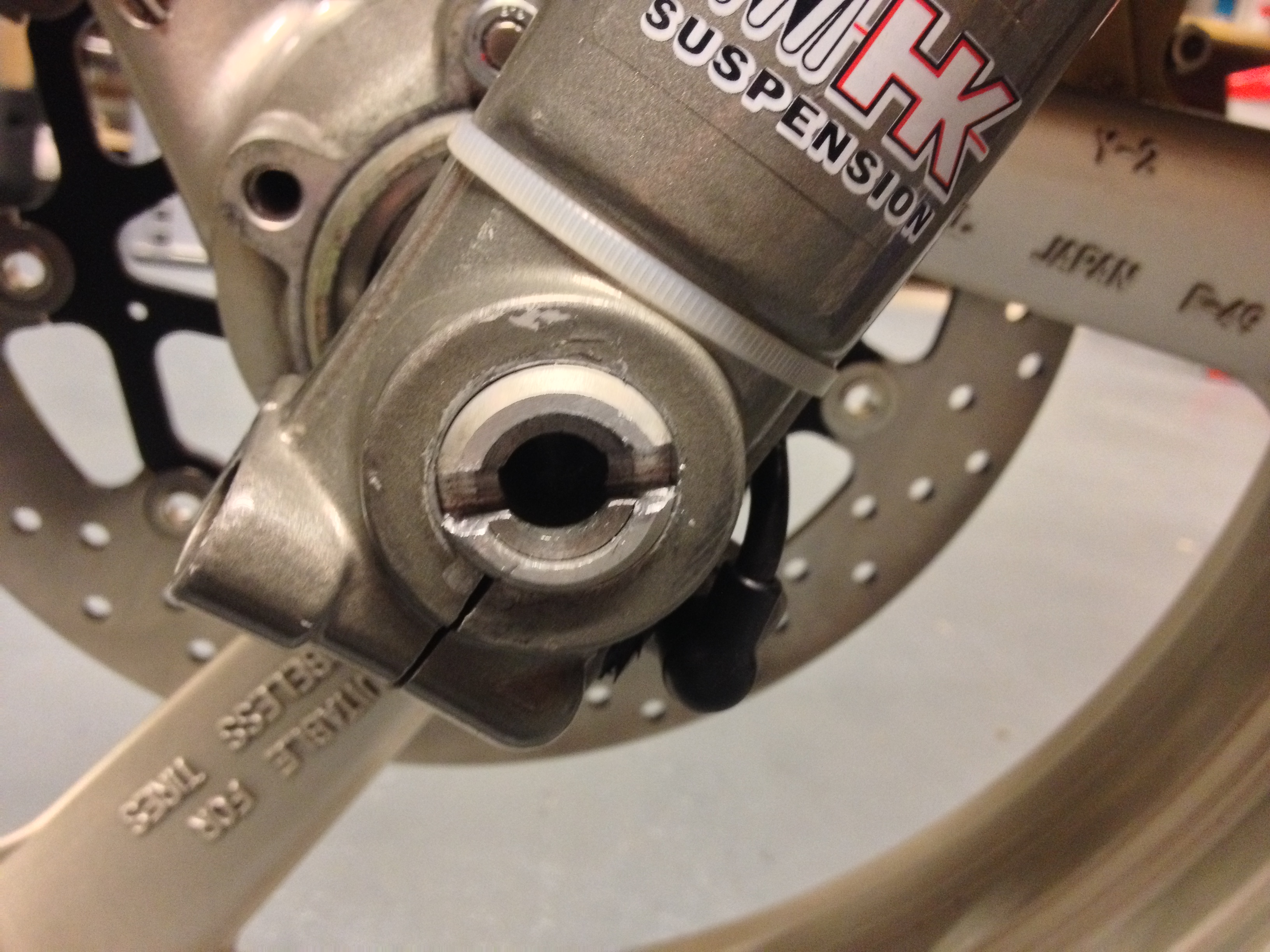

Only three pictures per post... Bushing left chain tensioner:
Oh, these markings are caused by three (3!) loose sprocket (grimeca) carrier bolts. The bolt holes were completely elongated after 20 k miles and ever since I secure every fastener.

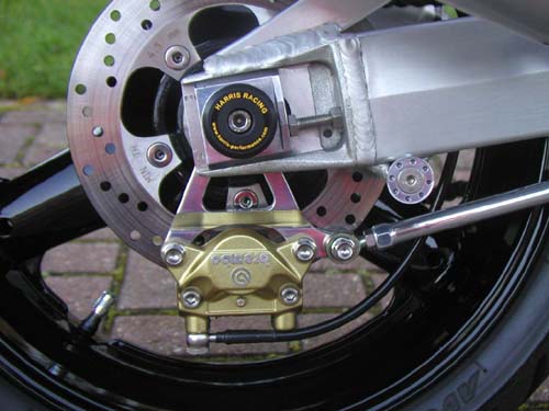

About shimming the brake caliper at the front: the caliper is indeed slightly outwards, but within limits according to Brembo. It is about 0,5 mm. To be honest, I've never contemplated it. The SZR brake carrier plate is the easiest way to go, but I stumbled across this picture:
Really nice Harris F1 carrier!

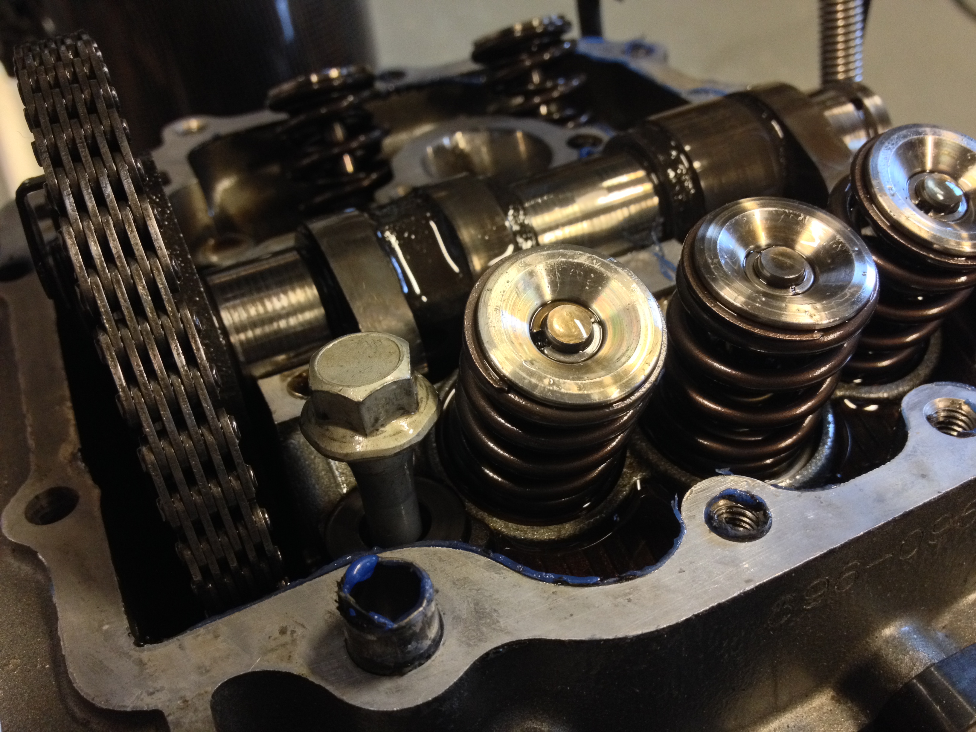

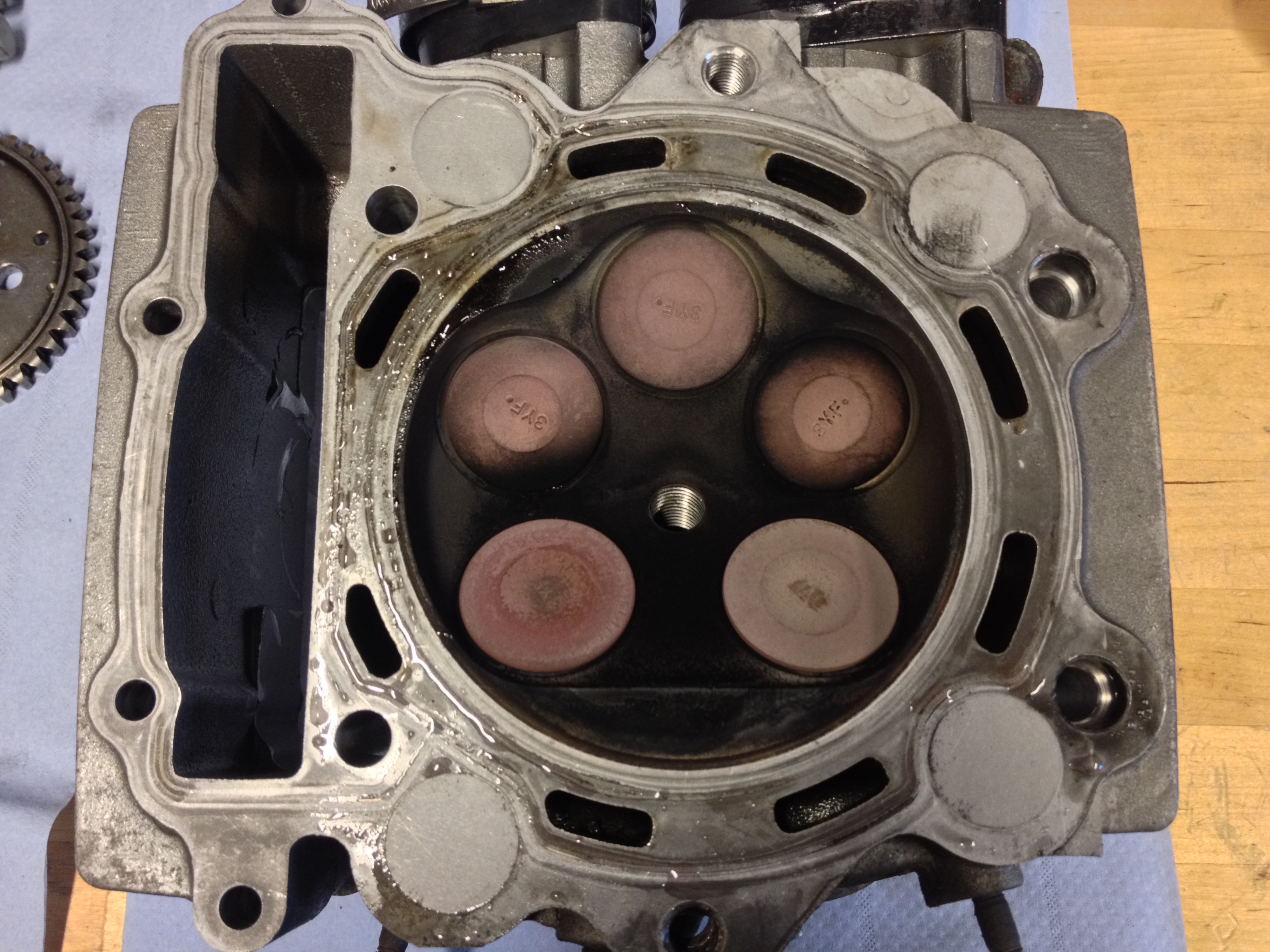

Yesterday I attended a race licence course with my MuZ ManX. Although it was cold and raining constantly it was much fun. Trying to keep up with zx10r's and BMW 1000rr's with rain tires and traction control was a challenge, but my Skorpion did well, until the head gasket failed during the third session :-( One of the left head bolts had come loose:
Luckily no further damage was done. It was a pity, I therefore missed the most important sessions, so no licence this year.
All bolts were torqued according to spec, although I have failed re-torqueing the bolts after the first 200Km... due to the labour involved tilting the engine to remove the valve cover. On top of my to do list is removing the frame crossmember for easy maintenance.

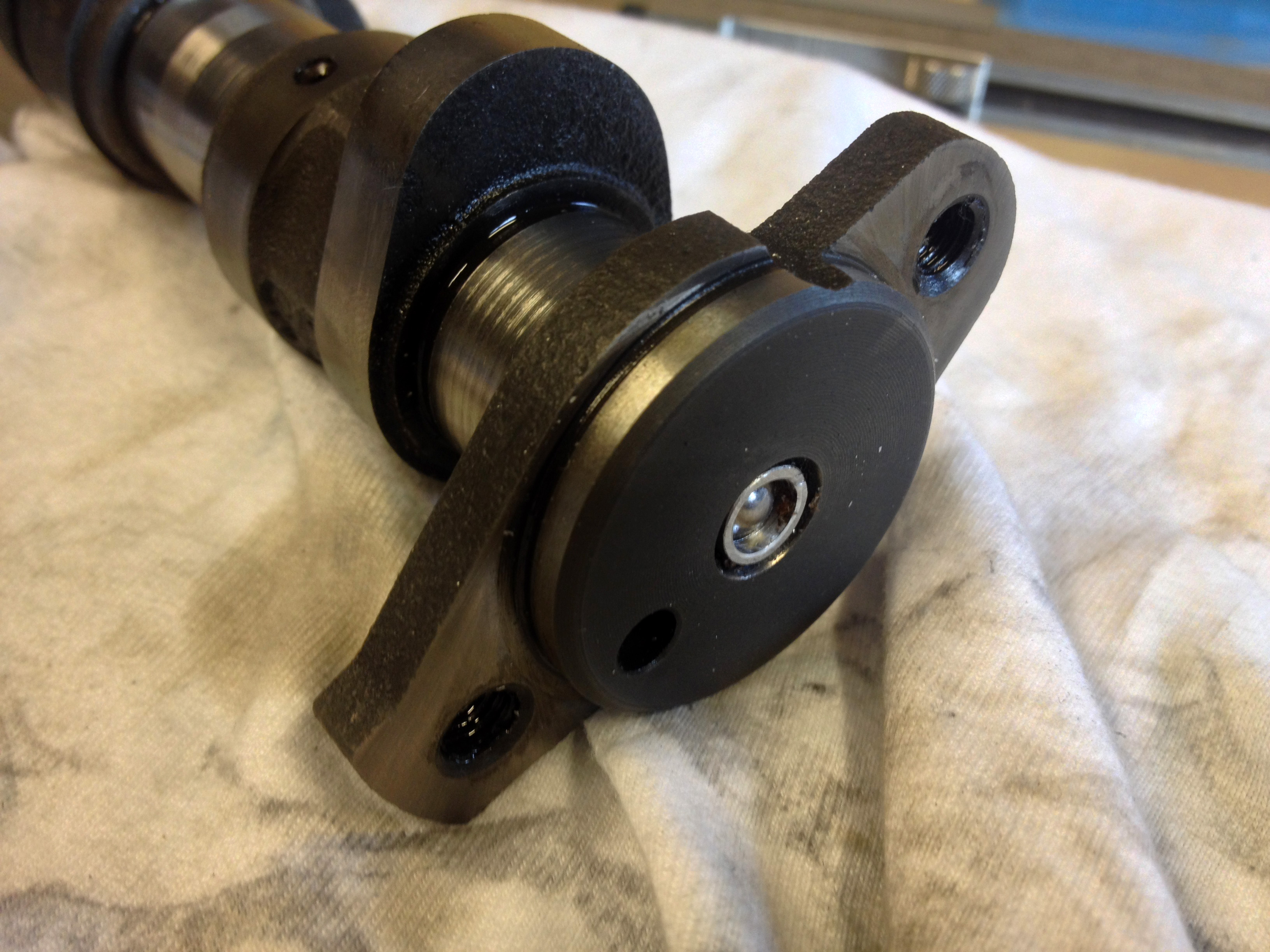

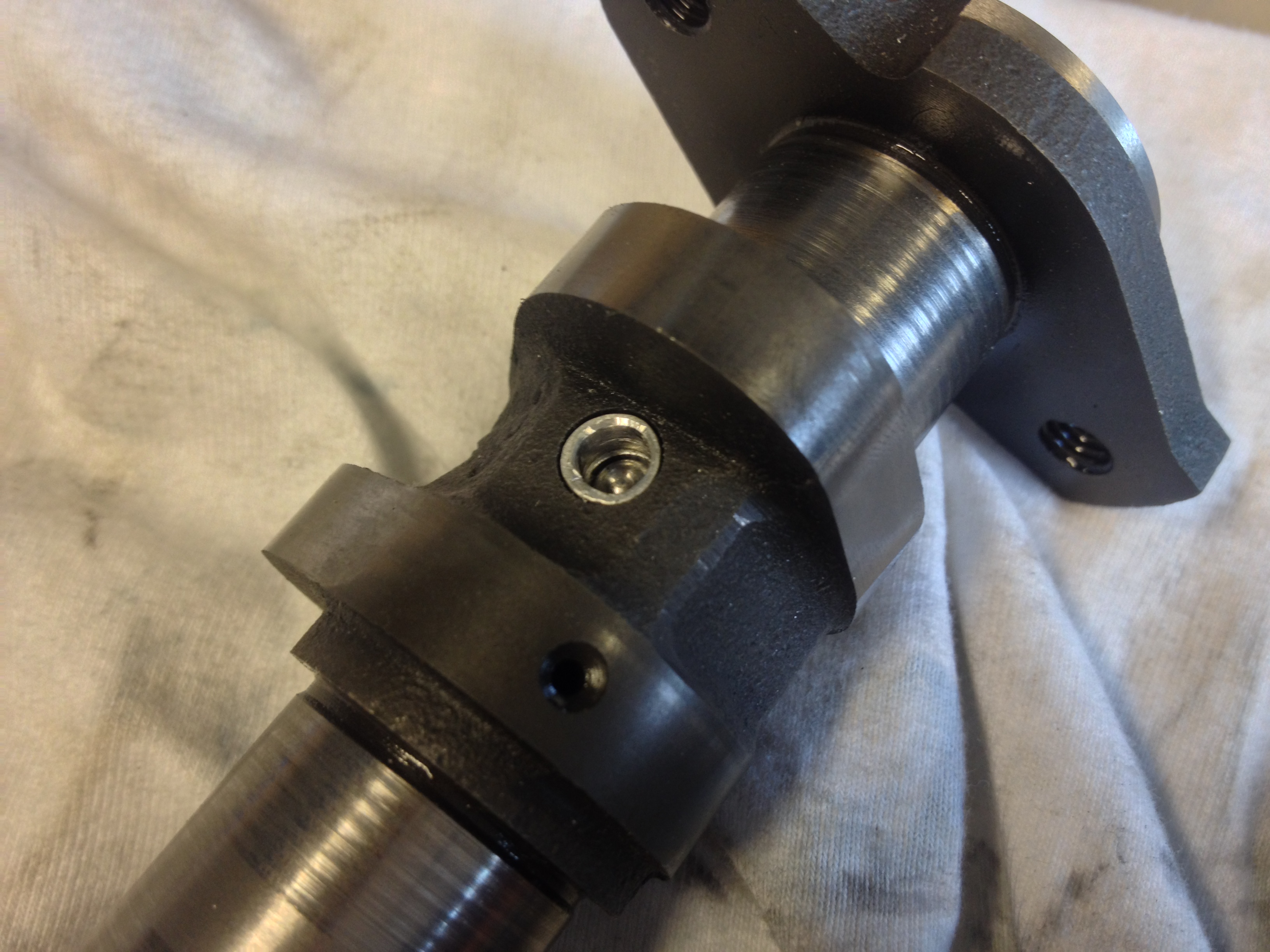

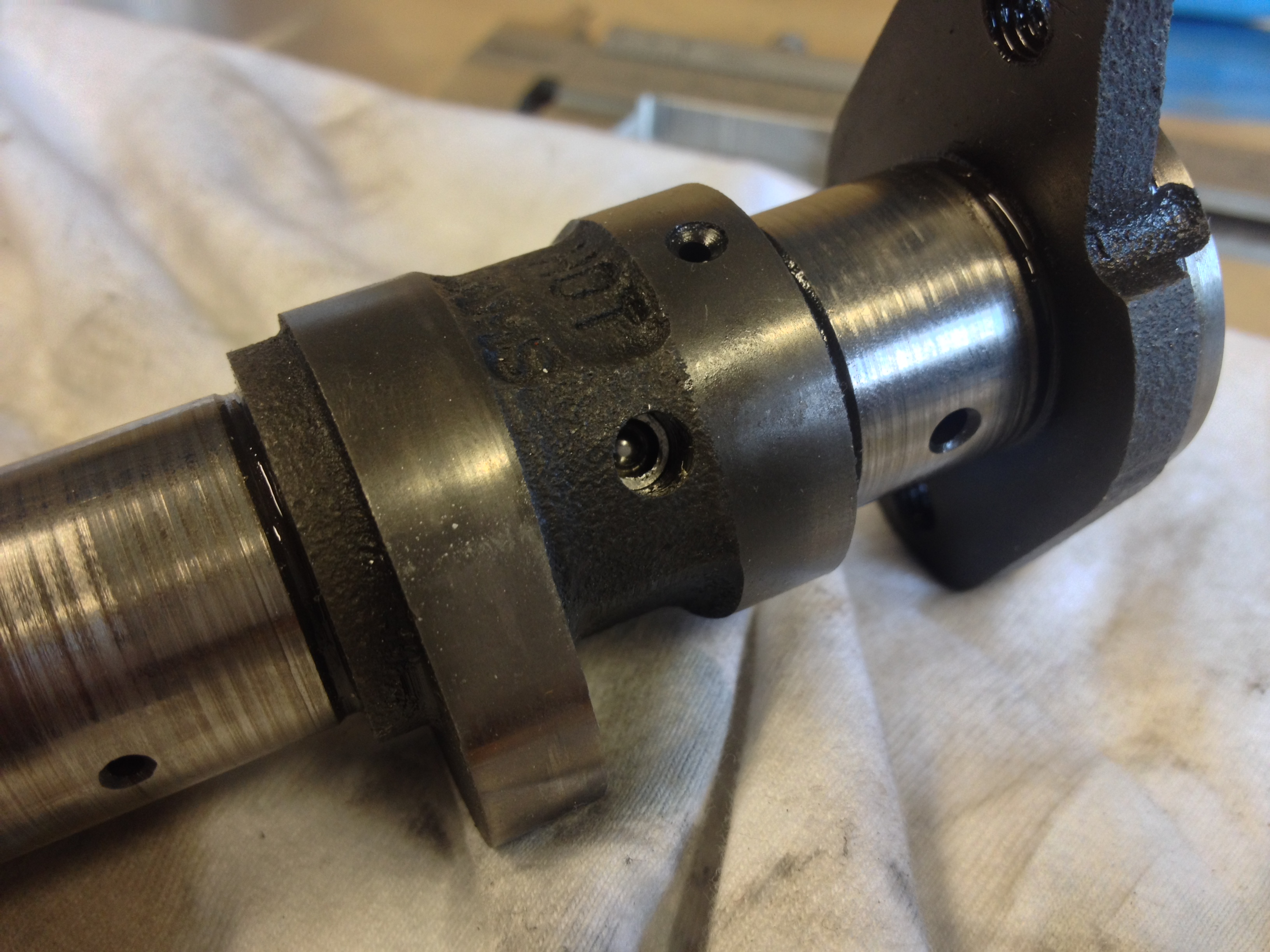

I took this gasket failure as an opportunity to remove the auto decomp. I know information is somewhere in the archives around here (something to do with Bill Jurgenson and steel balls :lol:), but the search function didn't give any proper results. In the end I came up with a solution myself using bearing balls and aluminum rivets.

If you ever feel like those fixes aren't solid, I discovered another one that's pretty bullet proof. Just thread hole where the plunger that opens the valve at low rpm is and put a set screw in it to hold the decomp rotor/cam in place. Done!
Re: MuZ ManX project
Postby Hajok » Sun Mar 27, 2016 4:44 am
Edfmaniac, I read about that solution in a Raptor forum thread. A proper and simple solution, with the mentioned disadvantage of creating threads in the plunger hole. The main reason for me not using this solution: removing the decomp cam ensures unrestricted oil flow to the most heavily loaded bearing.
These plugs are tight:

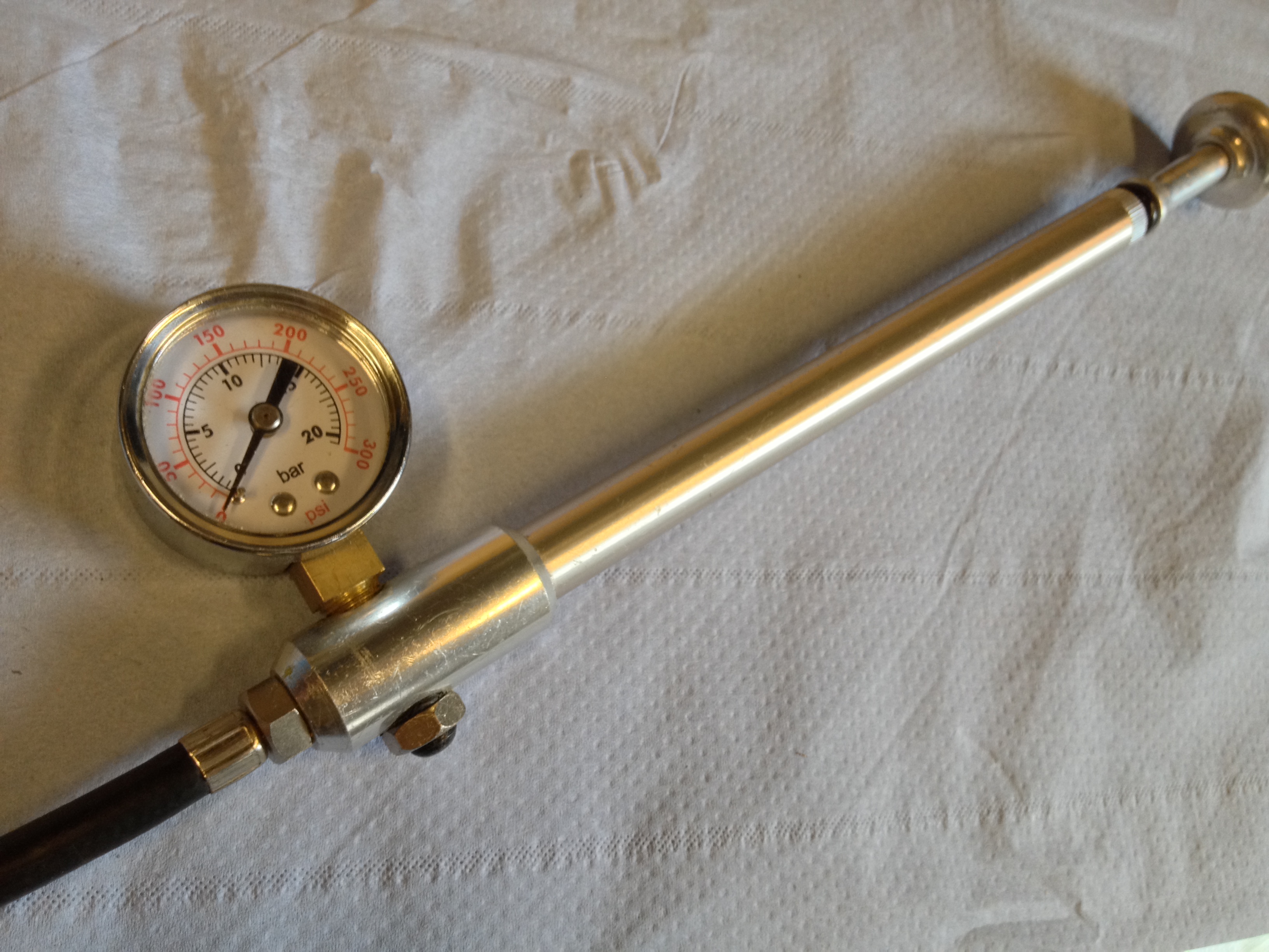

I will test my solution using a Cannondale fork pump, which goes up to 300 psi:
If the plugs can withstand this pressure I'm sure it will hold. Hopefully the Hotcams stage 3 cam allows the starter motor cranking the engine. If not a Megacycle x4 cam should do the trick. Something to do with valve timing overlap decreasing compression at low rpm... Edfmaniac, what's your opinion?

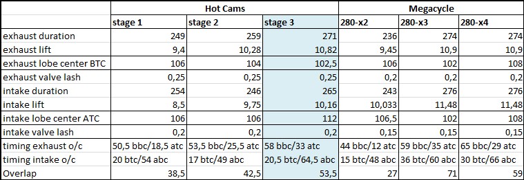

Postby Hajok » Mon Mar 28, 2016 1:24 pm
The valve timing overlap of the X4 cam is about 5,5 degrees more than my Hotcams Stage 3:
If the X4 is no problem my engine should be cranked as well.

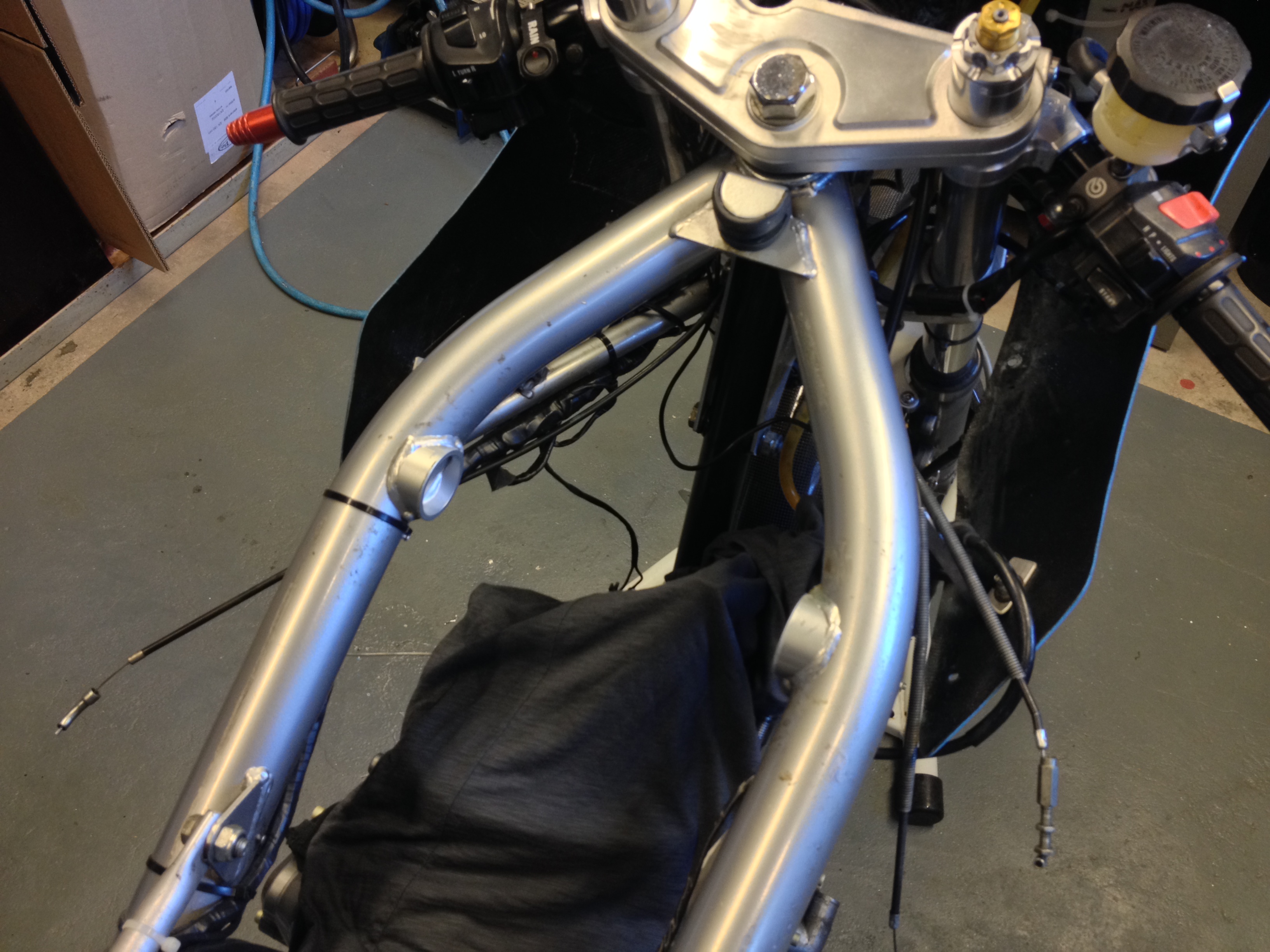

Today I had the guts to remove the frame crossmember.
This removal should give no noticable detrimental effects. We'll see, the worst case scenario is welding the crossmember back in place :wink:

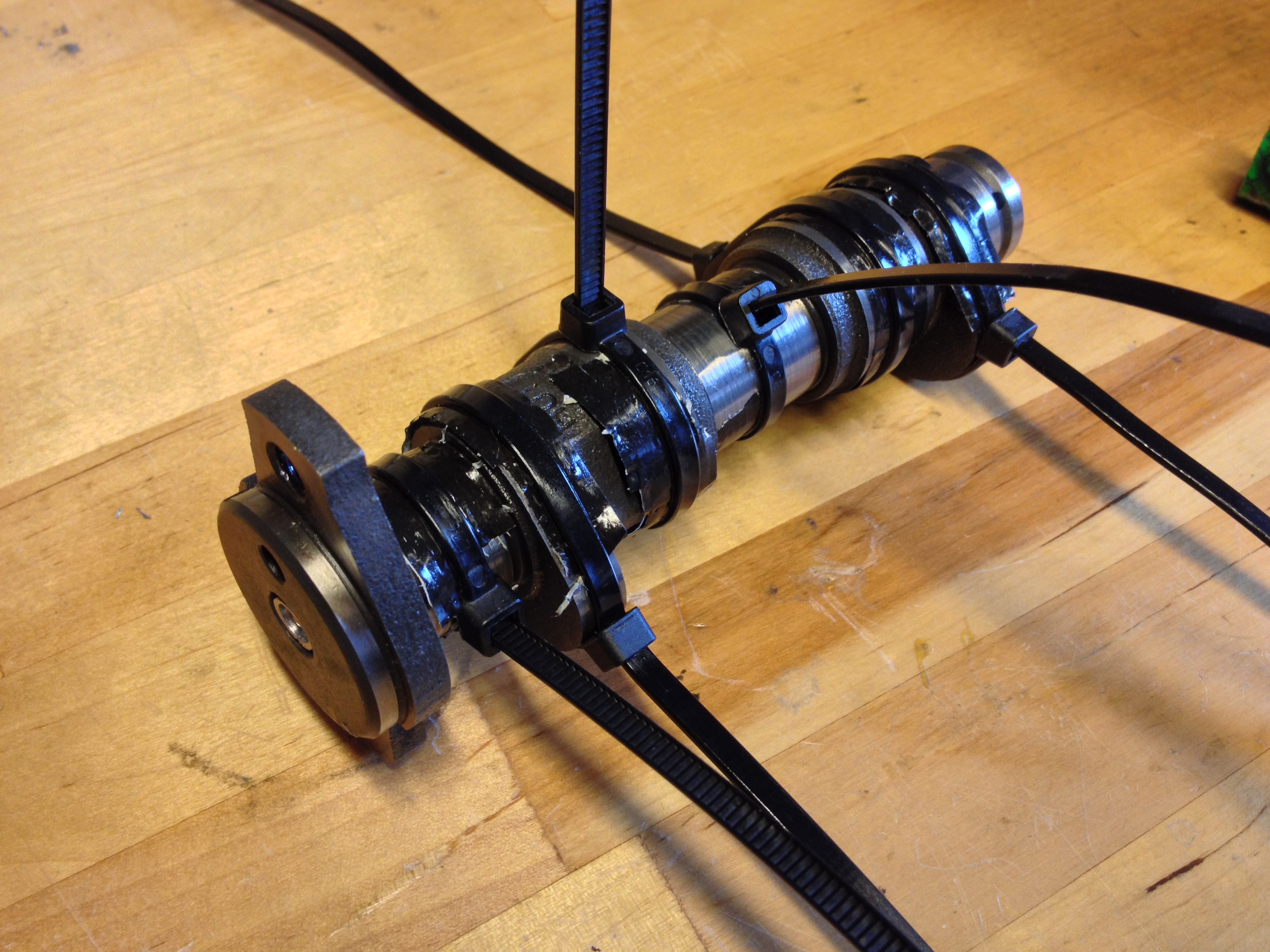

Testing the plugged camshaft proved to be difficult. With tape and tie wraps the oil passages are closed, the maximum pressure was around 6 bar (87 psi).
I have confidence the plugs will hold.
