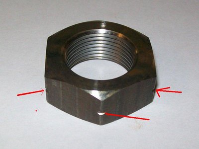

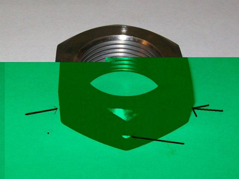

Postby DAVID THOMPSON » Fri Feb 15, 2013 7:39 pm
it is common practice to mark a reverse thread nut with a mark ..
see the attached picture at the end of the red arrows
torch tanks have nuts like this also so they do not get hooked up wrong
the rt125 crank nut is marked like this
as always click on pic for bigger view

DAVID THOMPSON wrote:it is common practice to mark a reverse thread nut with a mark ..
Turns out that the clutch basket nut has those markings on it. I noticed them on the fiche when looking up lock washer numbers and double checked my engine. :!:
Edit: Even though the clutch nut had those marks, it was conventional thread. Go figure!

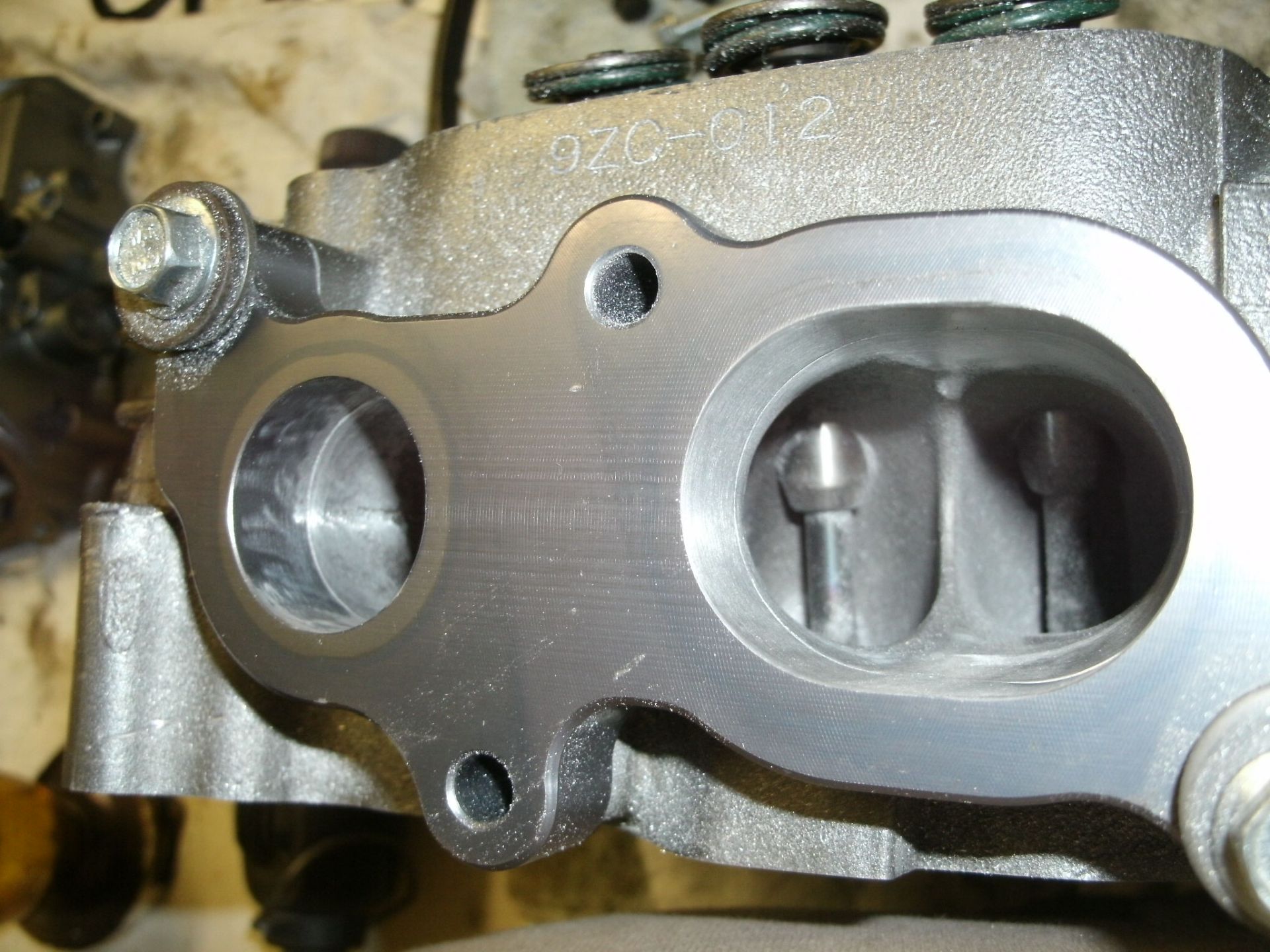

Had some time on my hands and decided to match the carb spacer and head ports. The amount of flow gained by matching these, as well as the union between the intake boots and the spacer should make for at least 1/2hp to 1hp. There was a pretty good bottle neck effect in the boots and the large port on the head got a full 1/8 of an inch removed from the far right hand side. Hopefully the machinist will appreciate the head start and do a really good job for me.

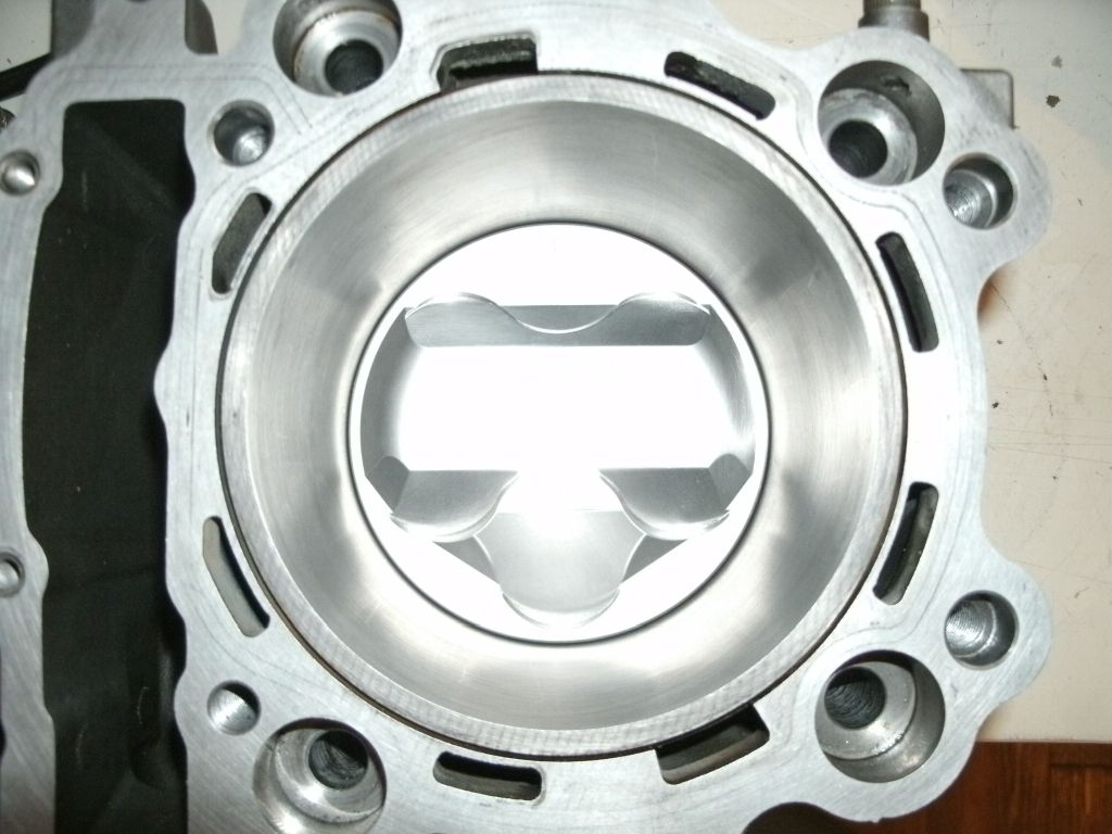

Just got the OEM cylinder back from the machine shop. Instead of wondering if the aftermarket cylinder will work right, I had a moment of clarity and called the local engine shop to see what they'd charge to bore my OEM. Turned out to be a real deal. The person quoting me the job didn't realize that I was taking off so much material and then refused to let me pay for the extra work they did. :D Sometimes life gives you lemonade.

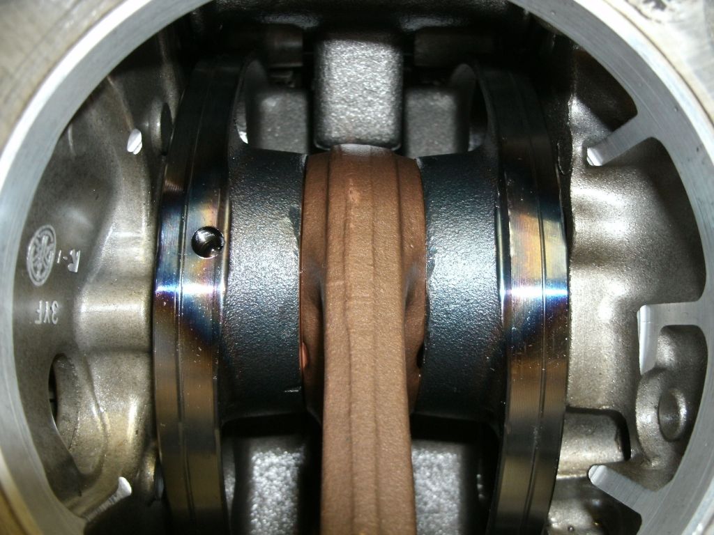

How much blue-ing did your crank have btw? i know a bit is to be expected from factory but i wonder if i have a touch more than most..
Any pics of the end job of the porting too? much different from stock can you see?

Postby edfmaniac » Mon Mar 18, 2013 11:08 pm
I noticed the colors on the crank right away but don't have much experience in engine building outside of rc car racing. I figured that it was all manufacturing process because for the crank to get hot enough to blue steel, it would instantly vaporize oil. Those were my thoughts anyway. The head is still in the shop because they asked me if they could take a little extra time due to a busy counter at the shop last week. I'm in no hurry as long as they do a good job, and thankfully they didn't call me today. I hate knowing anything I paid for was built on a Monday or a Friday. :lol:

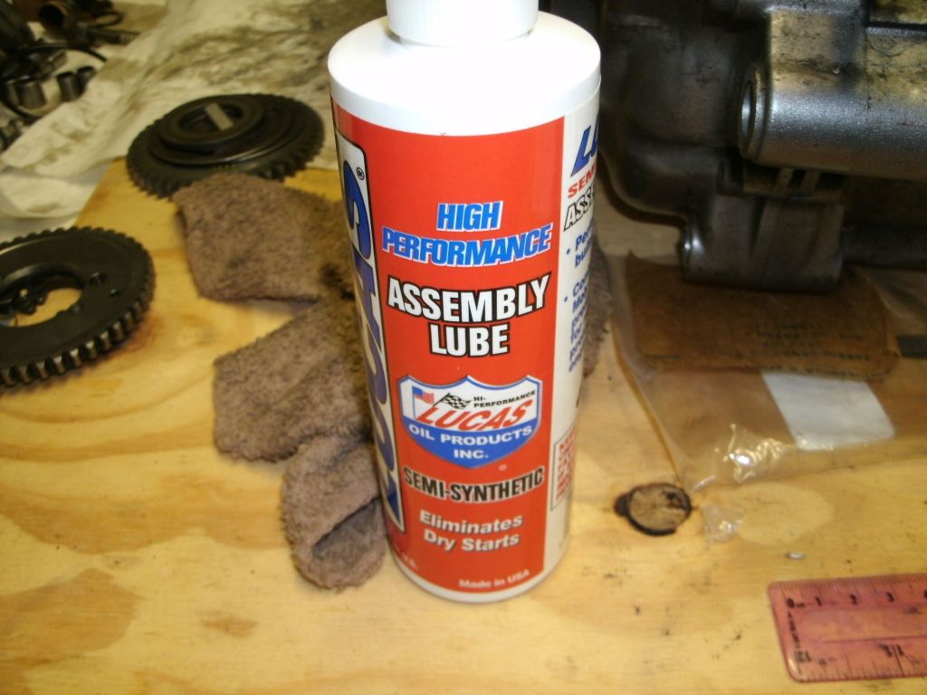

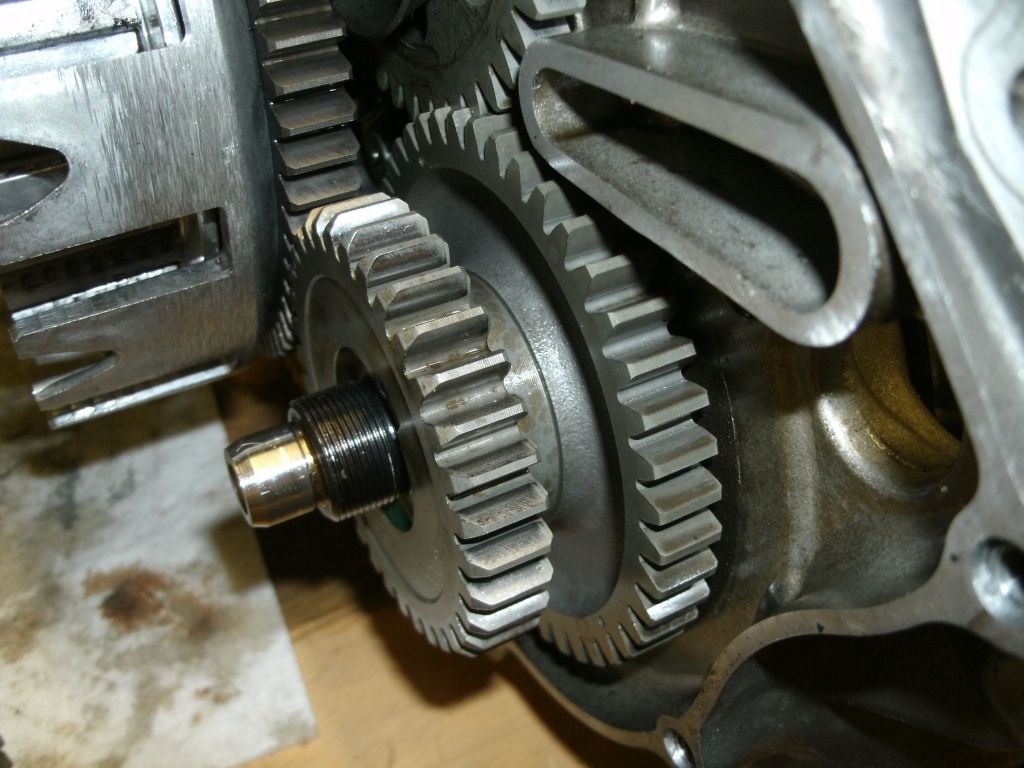

Here's a pic of the solid gear installed and a reminder to remove the two vented washers and the thick solid washer when doing this mod. Also a pic of some assembly lube I bought. There's no telling what's in there but it makes gears and bearings go together as if facilitated by God himself. I had a bear of a time getting the gear that drives the clutch basket to go back on the crankshaft with WD-40 alone during a test fit. One or two drops of Lucas' gooey, sticky, runny, silky assembly lube and it jumped on the shaft without hesitation. I can only imagine how happy the cam lobes will be until the oil pressure builds for the first time in the fresh engine.
