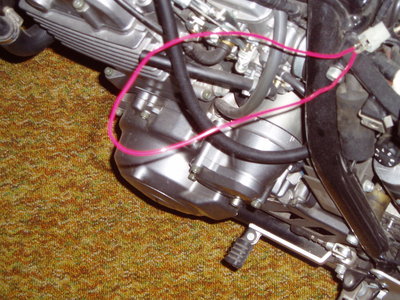

Custom bypass of switch, using a red wire...
A molex connector set is much cleaner, used the wire as an example...
