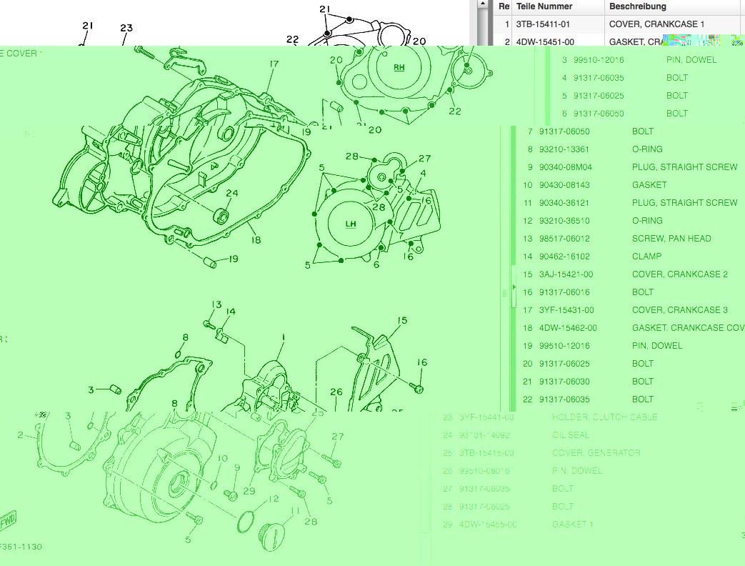

Also note Bills placement of the two gears side by side. If you click on the picture to enlarge, imagine a straight line from the lower edge of each keyway to the teeth on both gears. A clockwise count of five teeth and I find a dimple on both.
I'm not sure... never the less, Mr. Jurgenson might have done this for an older gentleman like me, gracious sole that he is.

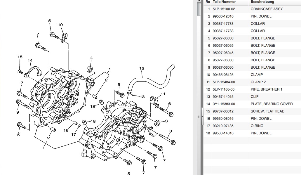

yes and no.

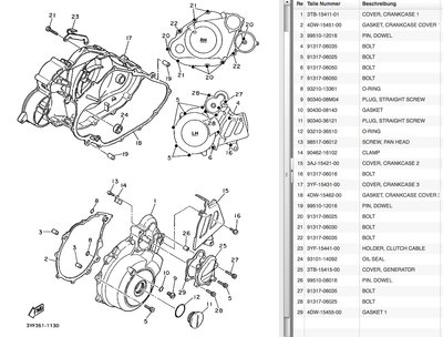

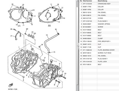

The Raptor crankcase halves do fit in the frame and they also fit all the internals, but the XTZ side covers do not fit. Otherwise I would have long gone over to using it because of the much better oil filter solution.
3YF crankcase, i.e. the one we have, the Yamaha internal number for this engine is 3YF
the matching side covers
hier the raptor case,
it gets complicated because of the generator and starter stuff on the left. None of this is compatible with the 3YF. Since the Raptor has a CDI (we DO NOT HAVE A CDI)
none of the ignition stuff works, either.
not worth it

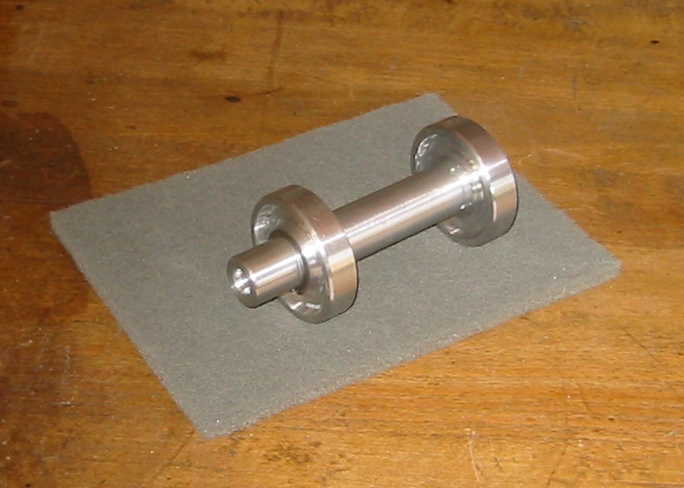

you should not run without the balancer because it is a necessary part of the crankcase breather system.
I know this from learning by doing. My first attempt was simply without and left me without oil within a few kms.
So we inserted a makeshift alu tube of similar diameter where the balancer had been to the breather on the left side. That worked and remained that way for 50tkm; makeshifts have a way of becoming permanent. like I said it works but only at civilized rpm and sedate street riding. Beyound that the oil is pumped out thru the breather.
Took me a while to figure it out; the street bike would act up periodically, especially after prolonged runs at 7000+ (Autobahn). I discovered that the airbox was so full of oil that as soon as engine speed amd vibes were over midrange it sucked in the oil as well. Started and idled fine.
Mopping out the airbox with a paper towel did the trick. Later I put a separate catch bottle for the breather.
much better

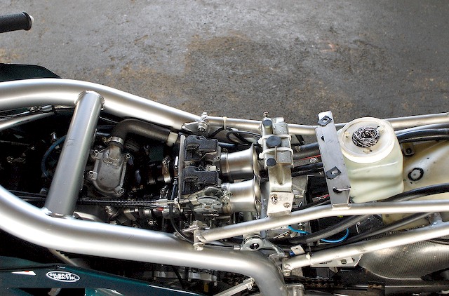

For the race engine I made a dummy from alu exactly like the b-shaft with its bearings, inside diameters etc exactly replicated. only difference: it had no gesr and didn't turn.
Despite two large breathers, the race engine spewed 1/4 -1/2ltr into the catch tank in the coarse of a 40min turn.
9000+rpm just pumps a lot more.
the second breather hose, 1"Ø from the head to the large with plastic can can.
With time I figured the thing out and what I had done wrong.
The shaft must rotate. It can be a simple round shaft with no balance function but it must rotate because it is a centrifugal separator. The rotation separates the heavier oil mist, forcingit out against the inner surface, the air passes on thru; since the far left end has a reduction, sort of dam for the oil, most of the oil passes on thru the small peripheral holes in the shaft onto the cluster.
like I said, I have written all this before and I definitely will not write it again. It escapes me - guess I am too old, my idea of courtesy and also self-reliance too antiquated - no I am baffled by the childlike dependency and impertinent persistance. I did my homework, too. I wasn't born with unlimited knowledge. I found the online Yamaha parts catalogue by myself cause I looked.

you do not need a dummy. That was a dead end, a shortsight I made and I just explained that this morning.
you need the rotating shaft, whether weighted ot not.
the balancer has NOTHING WHATEVER to do with the balance factor of the crank.
A one cylinder crank cannot be dynamically balanced at all. It must always be lopsided. How much is whst to decide.
any offer to do so is not serious, just hype to pull an xtra buck from you pocket. steer far away.
read my little ditty in counterbalancers on my blog. If you don't want to believe me, get the necessary engineering papers.

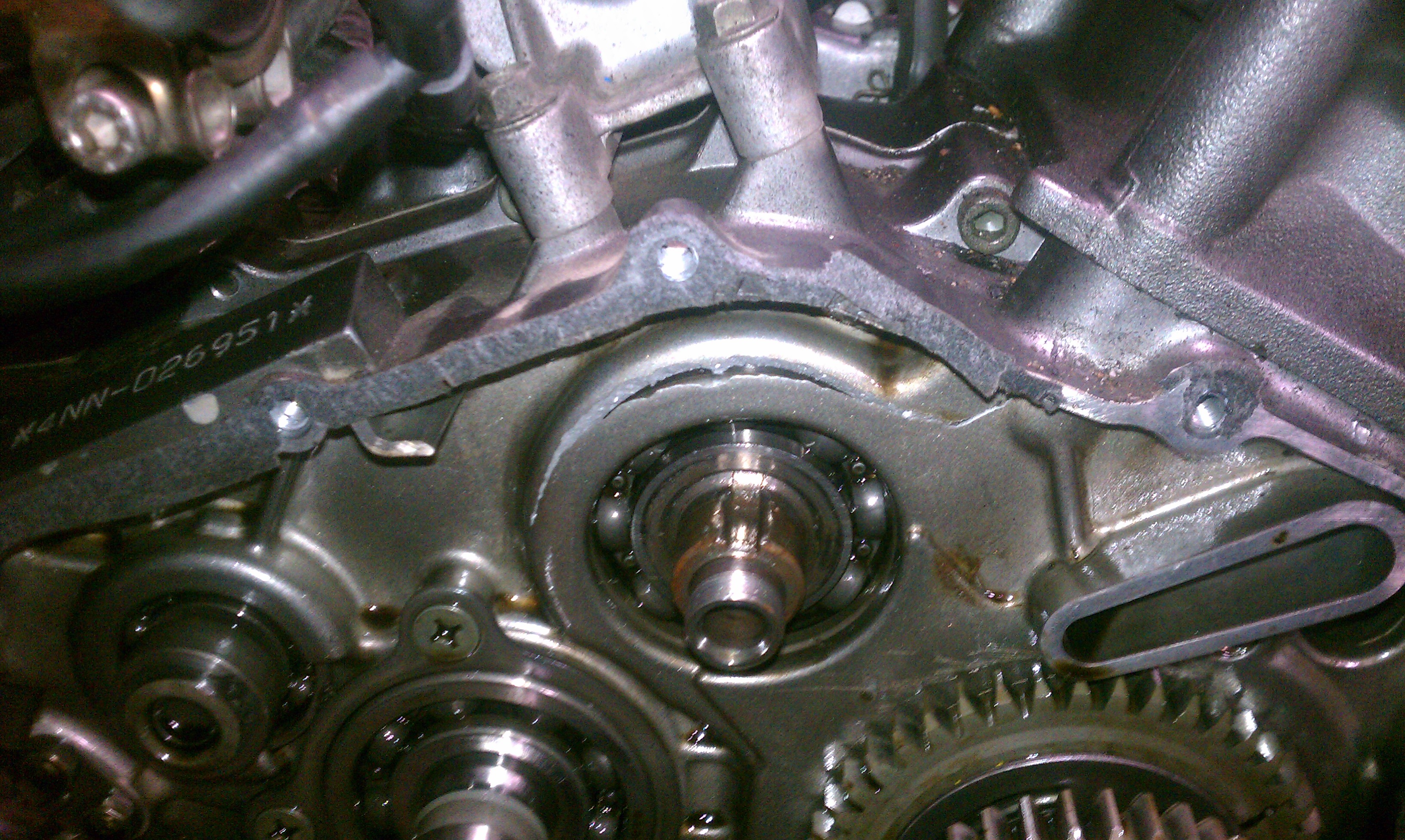

The bike now only makes noise as I shut it off. The last few starts were very normal.
I presume the gear and the woodruff key are on the left side of the engine case, cos that is where the noise seems to come from mine.
Now is it an advantage to get that solid gear from a raptor ?

The only way you will know is looking at the parts on the inside. That means taking the case and parts mentioned in this thread out to examine (As David and I both will be doing). The gear can be purchased at anytime the important thoughts that I have are...
As David has stated on the first page of this thread he has decided to parK his skorpion until he replaces the gear (parts) in question.
Thankful of Bills imput and other folks not so pleasent experiance, I also have decided to do the same as it doesn't make sense to take the chance to turn my Baghira into a "parts bike" because I wouldn't make the swap of that gear. Even so, I might open mine up the find a damaged key way and need to replace even more parts, though I hope the low (5,000) miles is working to my advantage, I HOPE.
If I choose to run my motorcycle and it fails not only will I destroy the engine but what might transpire at any given speed while I'm on it, I don't choose to find out.
Thank you for your patience with my thoughts...
To answer your question about the location. If you look at the three pictures from a previous post by Bill I found and shared on the first page of this thread, the bottom picture not only shows the (replacement Raptor) gear, the furthest gear to the right in the case (and picture), you can also see it in the above picture compared to the standard with the springs.
If you look at the upper right portion of the bottom picture you will see the small end of the connecting rod leaning forward as it would, towards the front of the engine, hense the side you are looking at is the right side of the engine, not the left.
Also look at the keyway in the top picture of the three of Bills that I reposted on the first page of this thread. Compare it to the keyway centered in the picture on the post before yours.
Again it's your ears, hearing your motorcycle. I wish I could offer you more.
