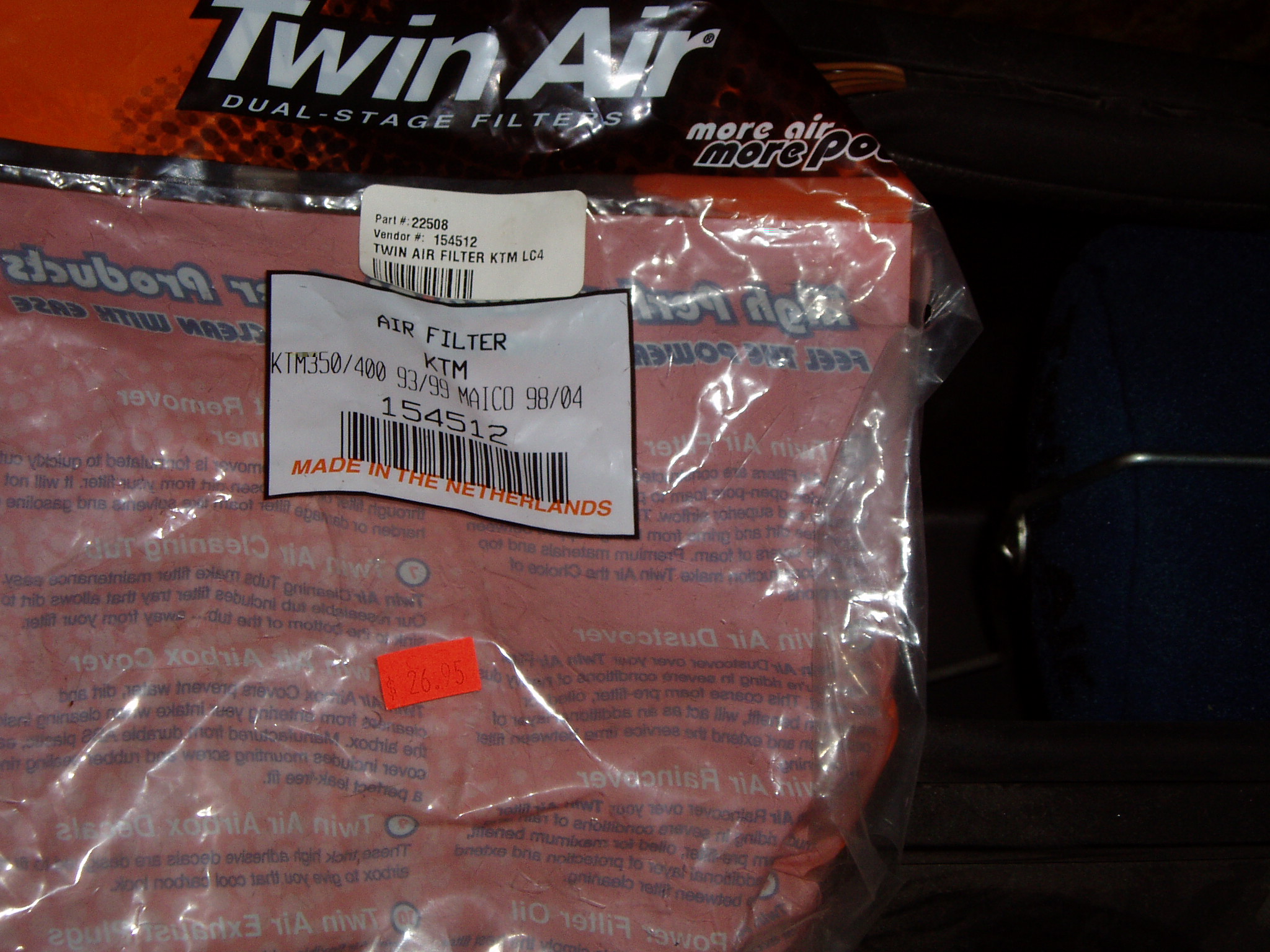

Postby OLDMTNCARVER » Wed Jul 06, 2011 6:15 pm
Here's a picture of the bag with part number and such.

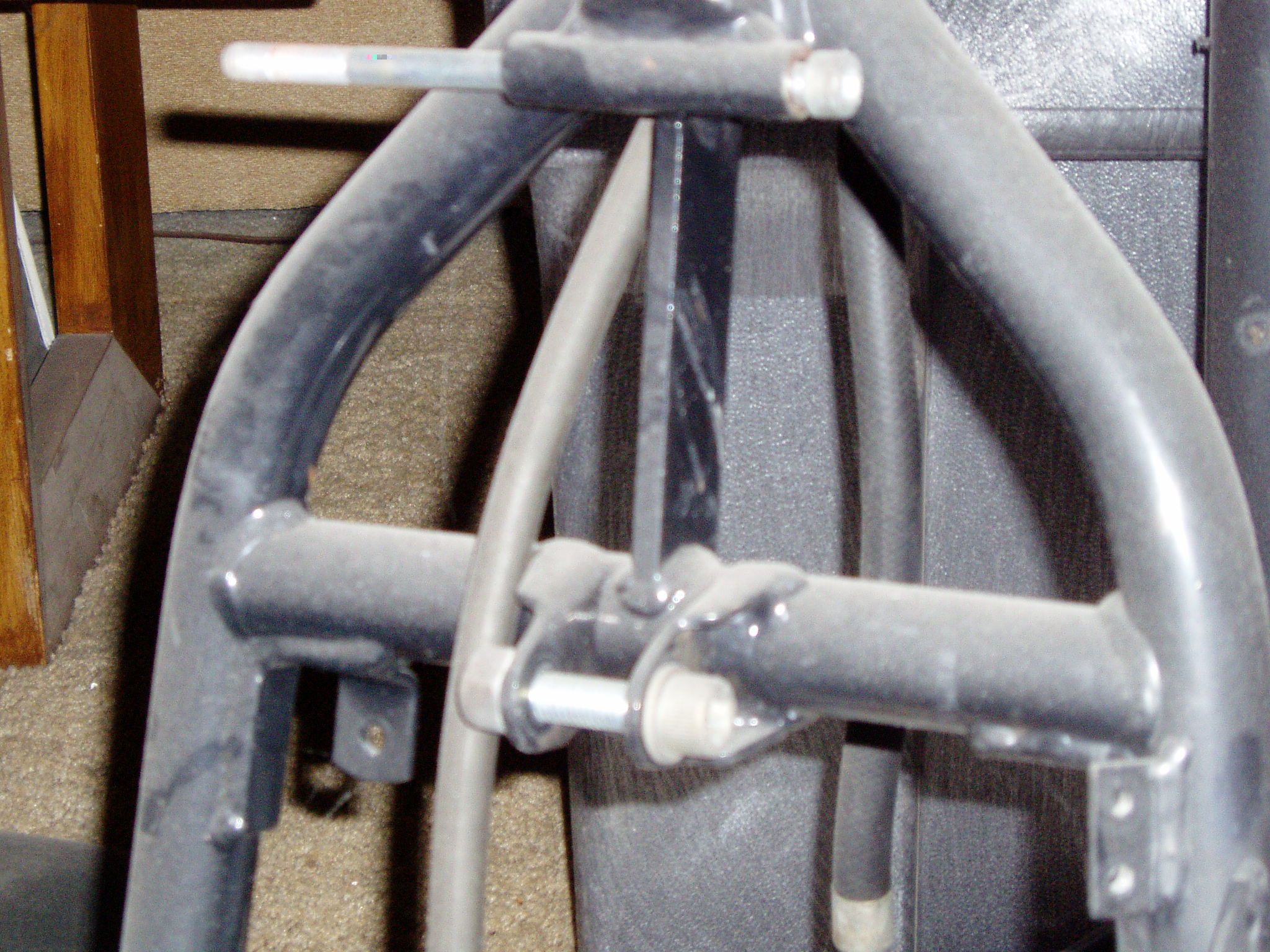

Postby OLDMTNCARVER » Thu Jul 07, 2011 8:01 am
The thought of a two into one manifold and single carb would seem to simplify things.
Clearance is an issue.
In another post Bill shows pictures of a cross brace on his skropion that's been removed and the benefits are presented.
I consider of the vertical brace between the Baghiras back bone and the rear shocks upper mount. If it were removed the clearance issues no longer exist, though I believe that this area does need some kind of brace.
If or when I will have decided more on the "total package" the effort still needs to be thought through.
