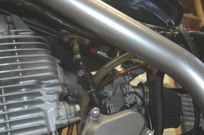

Thanks for the info. I am certain it's not the petcock. It flowed very well even before I cleaned it. If it used so much fuel that the flow rate was the issue, I would only get ~10m of cruising before running out of gas.
I'm using 3/8" hose because I needed it to make this fuel filter fit.
I checked one of the exhaust valves and it seemed fine. I will check the others before I ride again (I am waiting on a countershaft sprocket nut/washer.)
The plug gap is fine and maybe the lead has a bad connection, but that doesn't explain it acting like it's running out of fuel only when cruising. It can accel from 0 to 70 without issue but it won't hold 70. It could be a coil maybe. if the denso coil is cheapish, I'll get one just for fun.

However at the same time that I cleaned it, I also installed larger fuel hose and an inline fuel filter. It's hard to do without putting a loop in because the bung and carb are so close together, but I was able to pull it off. get the shortest filter possible.
