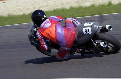

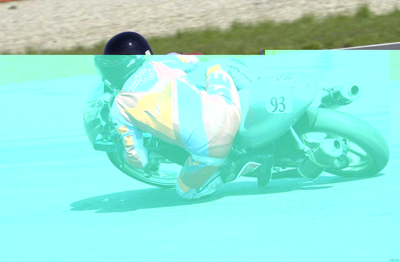

I don't know what sort of lean or hang off you expect but I never ever grounded mine - except in a fall.
I wasn't slow, either. Lacking a SOS class here in Germany most of the time (there is one again now that I am too old to race), I raced against 2 valve Ducatis and the like and was by no means last. Beat 916s, too, if the track had no long straights like the Lausitzring (Photo).
In your photo they are hung quite low but there would be no problem hanging them higher.

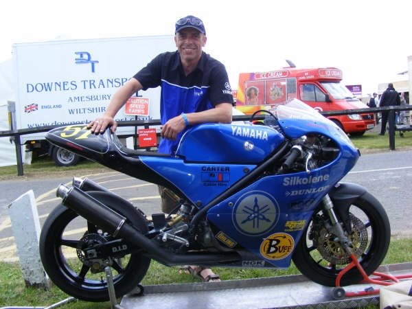

Obviously, tho, motors that don't have two-port heads don't have 2 in 2s either: KTM, Husaberg, MaliJawa, Ducati Supermono...

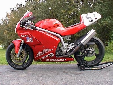

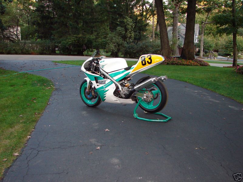

this the works racer from MuZ
BikeWorx "works bike" Maynard Mass.

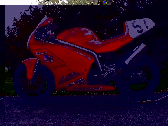

Our own Chris Hunsicker from Philidelphia. Chris became domestic and sold his MZ last year.
If the pipes look familiar, they are. I sold him my set when I quit real racing 2007.
Chris also had the referred to TZ250RR wheels, 3.5" and 5" mounted.

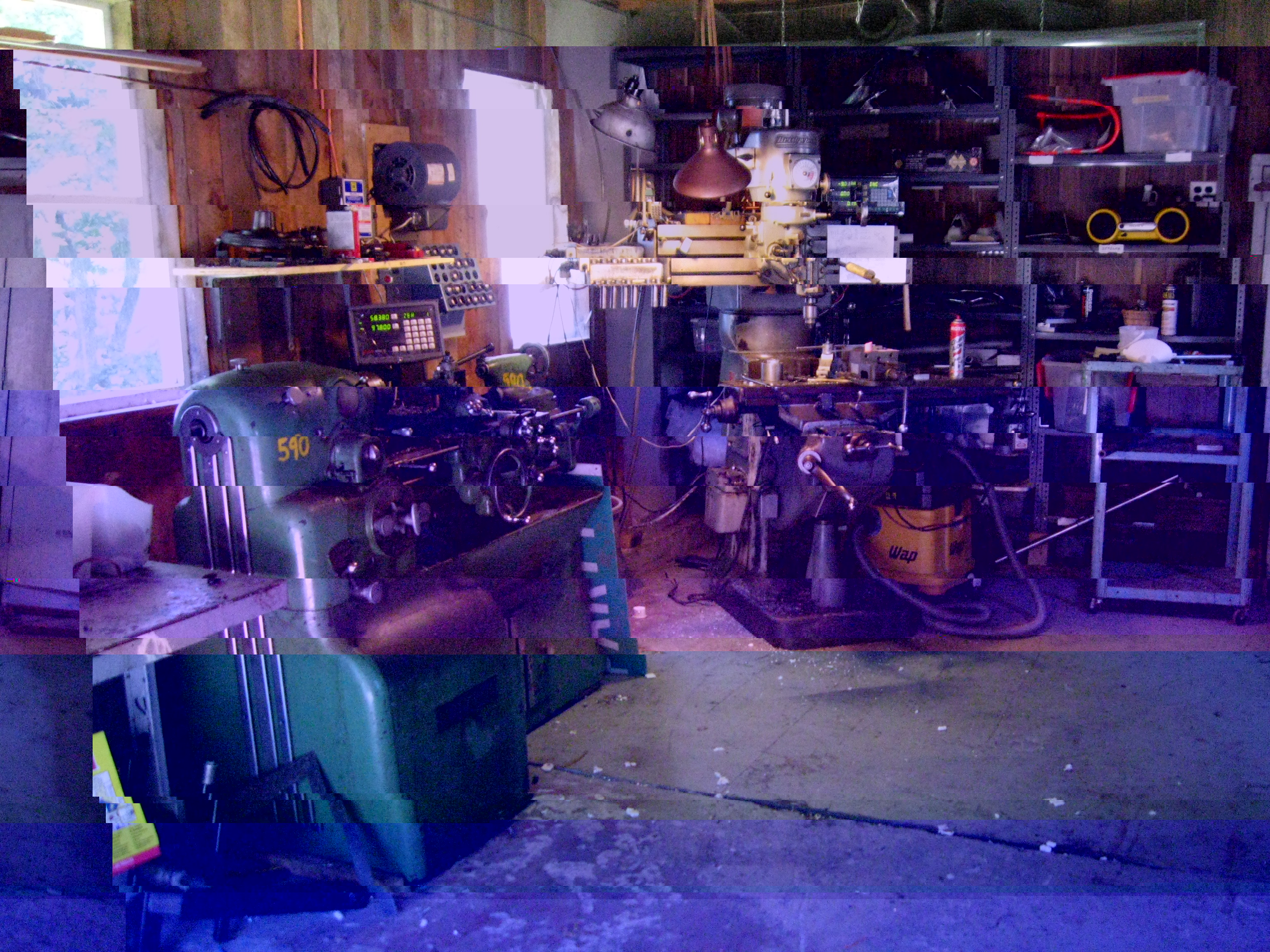

Postby Bill Jurgenson » Sun May 30, 2010 1:55 am

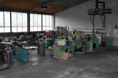

Despite having a complete machine shop at hand
I did not investigate further after seeing that the centerline was that far off.
I don't remember why and it might have had to do with MOT considerations over here which are very stringent.
Taking off 10mm is quite a bit from a cast part.

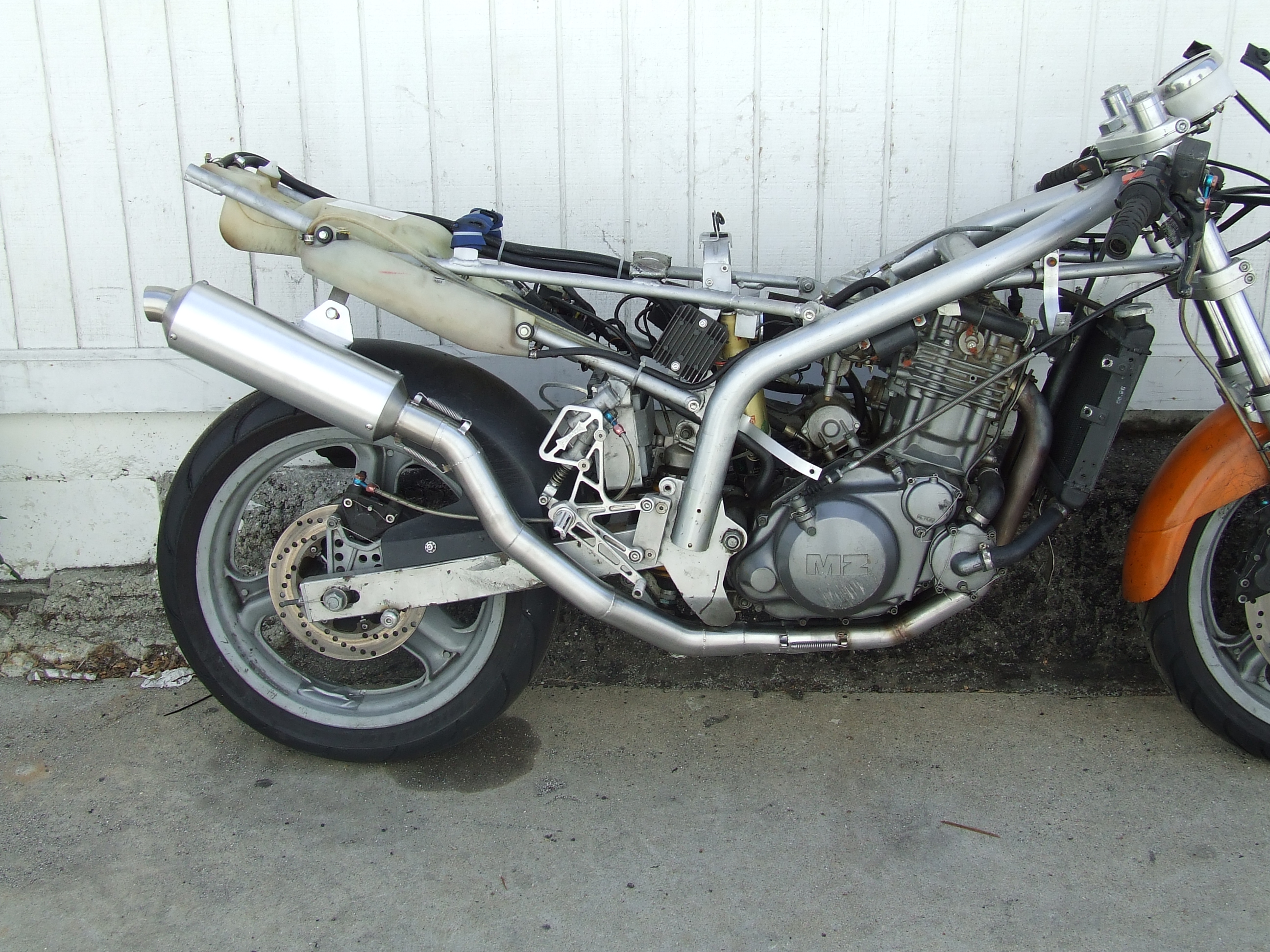

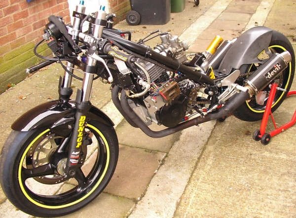

here's some more pics of a well-done Yamaha engined SOS.
NICE!
he obviously took a very close look at the MZ works machines.

Good. I was concerned that you were seeing something I wasn't, and there's not that much to see! Taking 10mm off may look like a lot but this is also a relatively low stress part. What I will probably do is turn the existing one down to fit, try it out, then make a new one in my shop.
I'll post pics when I do it. I think it would take a sharp guy to notice it wasn't stock, but I have heard horror stories about inspection in Germany. Then again, I've seen stuff over there that I wouldn't pass.

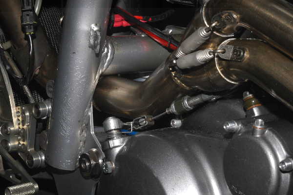

Postby Bill Jurgenson » Mon May 31, 2010 12:42 pm

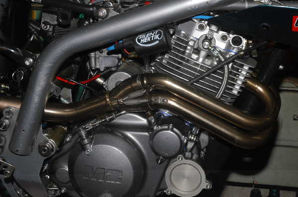

took two closeups of my XT exhaust system showing how well it fits the the Skorpion frame, as if made for it.
Re: God Help Me ...
Postby morbidelli17 » Mon May 31, 2010 1:48 pm
I really, really like that high-mount system.

Re: God Help Me ...
Postby Bill Jurgenson » Tue Jun 01, 2010 1:14 am
So do I but as I said, the ports of the XT600 head are quite different.
I have a hunch, tho, that that system from Germany for the new XT660 head could be made to fit like this pretty easily if the splay of the ports of the new head are similar to the XTZ. And I am pretty sure they are because the new 4-valve engine is or will be used in quads, i.e. as the replacement for the 5-valve 660 engine there.

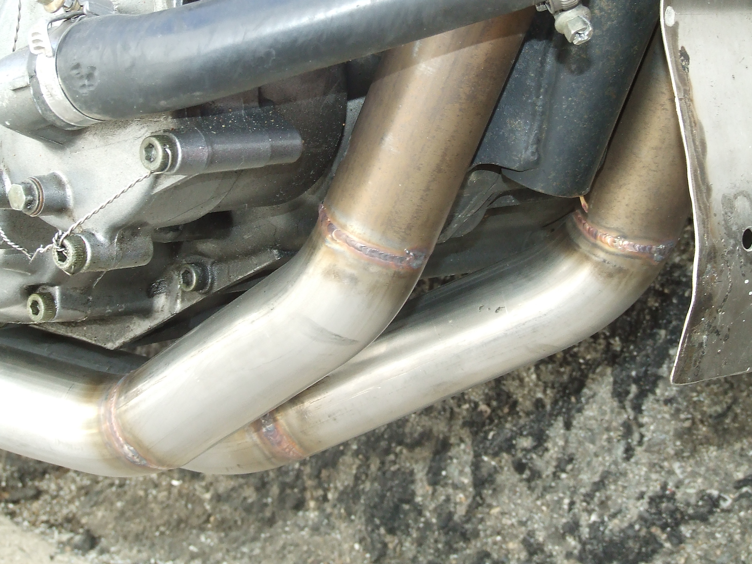

Postby morbidelli17 » Sat Jun 05, 2010 10:41 pm
So I had the Skorp back in my possession for a couple hours running it from the pipe guy to the race shop. Now it's getting the rear shock rebuilt and getting run on the dyno, just to make sure it's healthy and happy. It was racing with the last owner in February, but a little TLC doesn't hurt. Anyway, here's a shot of the pipe.

Neat, tidy 2-1 pipe. Putting the pegs back where they belong is on the to-do immediately list ...

Postby basser23 » Sun Jun 06, 2010 2:49 pm
Michael,
Very cool,I like the exhaust system....$$$? Let me have have the name and address of your exhaust guy..and let us know how it works during your
race stint..nothin' like a Michelob catch can.....
by the by,was the exhaust cannister an off the shelf item or custom made?

Re: God Help Me ...
Postby morbidelli17 » Sun Jun 06, 2010 4:56 pm
To fab everything from the headers back (I've attached a photo showing where the old and new systems meet) was $300. That included the exhaust canister, which the guy makes himself. It's Mark McDade at http://marksperformance.com/

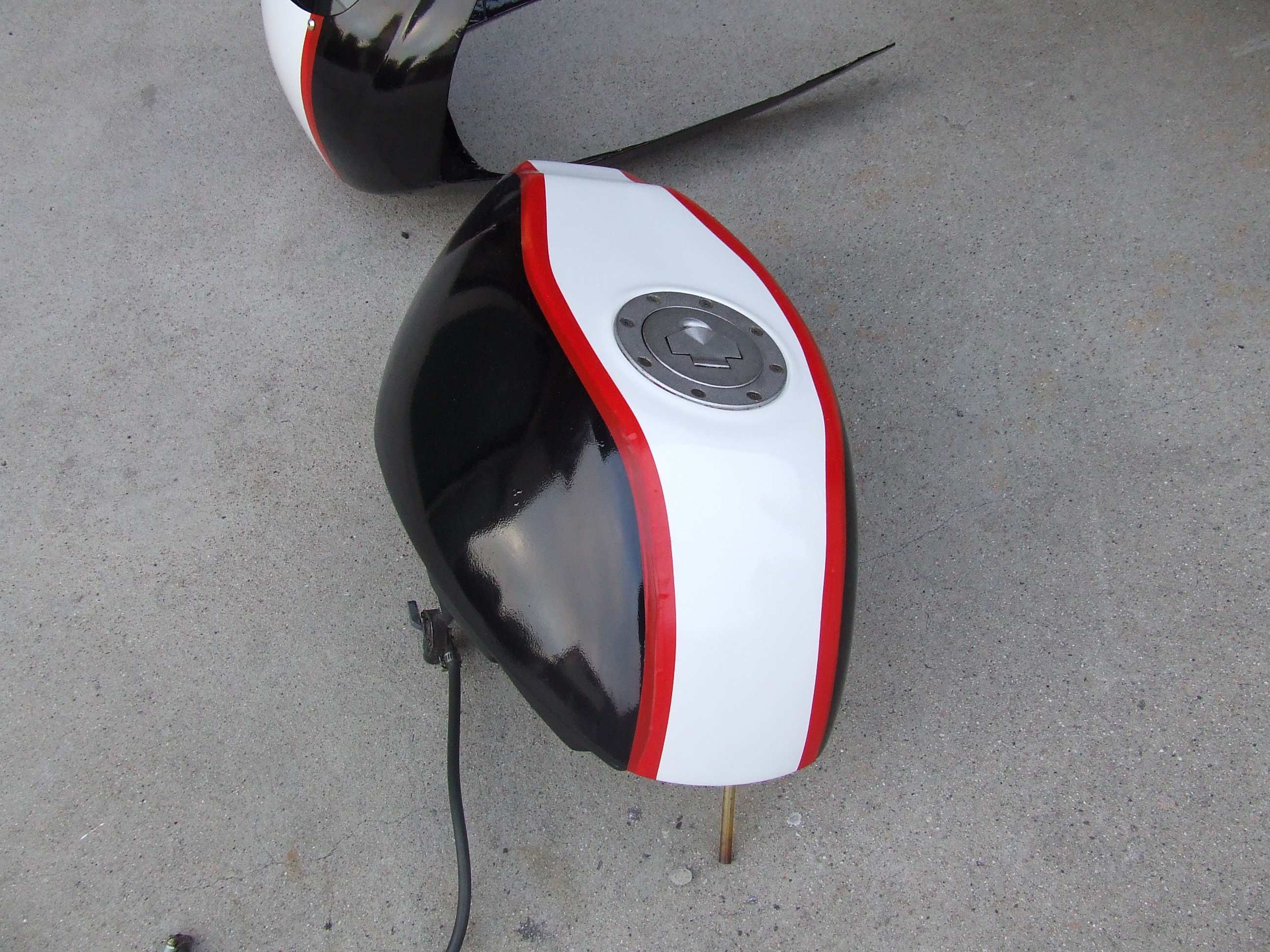

Just finished painting the new tail section. If I get a chance later, I'll take some pics of the wrapped upper fairing and gas tank and post them. I wanted to use wrap on those parts because the tank is pretty beat up, and fairings take a sandblasting at the desert tracks of the Western U.S. Wrap is a lot more durable than most paints.

Postby morbidelli17 » Sun Jun 06, 2010 10:05 pm
Wrapped fairing and gas tank. A little red vinyl tape for accent, and good enough for a race bike. At the price of what the team painter charges, I'll save myself enough for a front and two rear tires.
