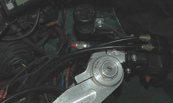

I only have one like this;
which would work just fine but might dictate a different brake hose.

Postby Bill Jurgenson » Wed Jul 14, 2010 11:43 am
here is photo.
I use the hydraulic switch up front as well:
Brembo M10x1 hydraulic switch on front brake pump.
this one.
