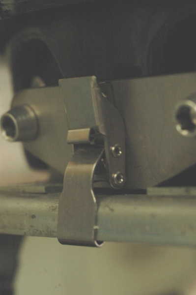

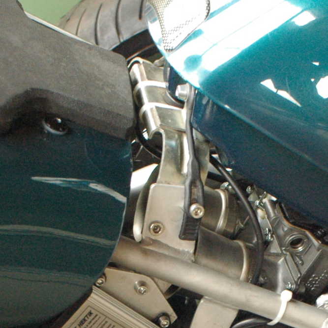

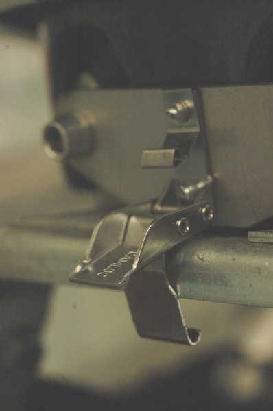

Postby Bill Jurgenson » Tue Jul 05, 2011 12:57 am
for the life of me, I can't see how that cross tube has anything to do with the tank.
That said, the tank drama has always nerved me no end. With three different Skorpions, I had my share. Both the red and blue bikes had the "standard" unremovable screws at the back of the tank, forcing one to remove the tank complete with the stamped sheetmetal support bracket.
After a whiie, I devised a method or repairing that problem, so that the tank screws would actually be used. My green bike never had that problem, tho, so I figured it must have something to do with initial assembly and possible use of something like Loctite. We built the green bike from scratch and know how and what was used for assembly. On the racer, I simply held the tank down with two rubber straps for the purpose as used in many vintage racers:
you can just see it hooked to an Allenhead bolt in the bracket. Since the tank was removed after every run the rubber catches didn't tear and worked fine, but if I forgot to undo them for any real length of time (e.g. over the winter), I found them torn so not a good idea for normal use. Besides, since there was no enclosing seat fairing, they ere easily gotten to, again, not the normal status quo.
For the Green street bike, I came up with something altogether better and really rather easy:
Camloc Schnappverschluss.jpg (10.1 KiB) Viewed 4221 times
Camloc Schnappverschluss2.jpg (11.07 KiB) Viewed 4221 times
The triangular stainless sheet metal is bolted to the tank with two cylindrical bushings as spacers over which the rubber grommets normally use for tank have been placed. The tops of the two "eyes" on the tank bracket have been sawn out so that two tapered slots, opening towards the the top are formed. the "Camloc" latch is riveted with pop rivets to the stainless bracket and - voilá - the tank and a latch with lock catch that cannot open by accident. One simple grip and the tankcan be lifted off - IF the fuel hose has been fitted with a quick release.
All covered in my blog.

Postby Bill Jurgenson » Tue Jul 05, 2011 2:23 pm
that's the one, with "secondary lock."
