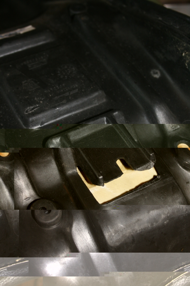

Slighty thicker and taller than the original, the replacement fits snugly into the exisiting area, requiring a minor mod to the rubber securing band to encompass the slighty fatter body. I simply screwed a curved 1" plastic block onto the existing hook-on point to extend it out past the case.
A recommended upgrade next time your 7ah battery dies. :smt004
Since my battery was on its way out I thought I would give this a go. £37 later I had it fitted, albeit a little tight, only to find the seat will no longer fit !. The space where the seat location tab fits into the frame (at the front of the Tour/Traveller seat) is now occupied by the battery !.
Lesson learnt, money wasted

Postby Linegeist » Sat Sep 06, 2008 3:19 pm
I'm sorry you had a problem here - I've just been out to look at mine again and I can't see where you baulked your seat fitting - unless mines different in some way.

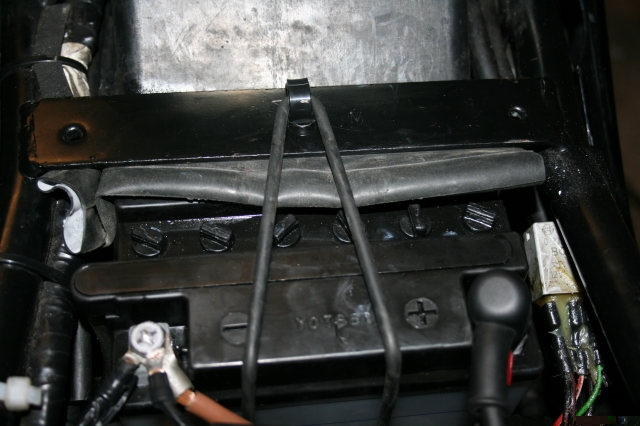

Postby srx600 » Sun Sep 07, 2008 4:50 am
Warning bells should have rung when I had to remove the pin on the frame, I initially thought this just retained the battery strap, I now realise it locates the front of the seat.
As you can see its so tight I fitted some inner tube between the frame and the battery to isolate it.
Battery
I'm planning a long weekend away next weekend so needed the battery for that, I shall probably re-fit the old battery and take jump leads.
I could modify the seat, but would rather not.

Postby Linegeist » Thu Sep 11, 2008 8:30 am
This gets more and more complex. My seat base doesn't have the inlet tang on it that yours appears to have, neither is there a loop on the crossbrace above the battery for the rubber band. I have a 1" pin protruding below the brace and yet still clear of the battery, although my brace is canted slightly upwards. In fact, there was enough clearance in my battery tray for some extra insulation on all sides to help the new battery deal with the big-single vibes............ :?
Either one of our bikes has been modded in some way from standard, or there were different battery configurations during the production run. Perhaps a good reason the use the dimensions I gave in my initial post, before shelling out the dosh?
I'm sorry once again, that you had this problem. :oops:
