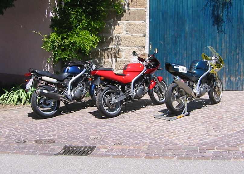

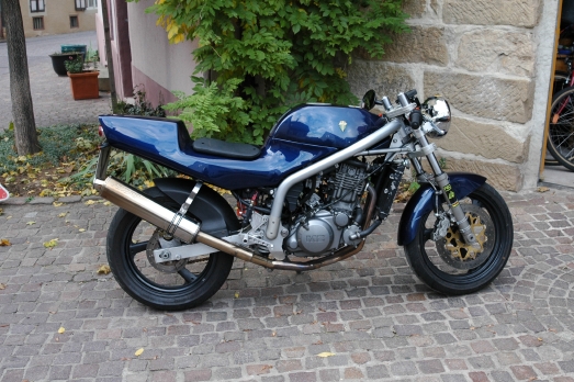

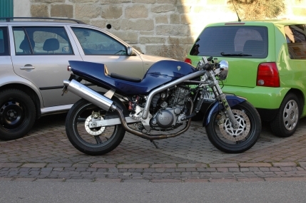

Exhaust ground clearance is a problem with all Skorpions but the Cups and Replicas, especially on the Tour, and I ground my L&W right thru. But after the exhaust caused me to go down once too often, breaking my hand, I threw out the original system and built a new rerouted one using a 3-bolt flange to accept the BSM can - or any other can with that pattern. It ran more centrally under the bike, requiring the centerstand bracket to be removed; neither Cups nor Replicas have a centerstand and the centerstand was the first thing I removed from my Skorpions anyway. I made this DIY for the racer in its first configuration, before things got serious about it. It then went onto the Tour and then to the red Sport when I got a Remus Cup system, the one presently on my Tour. That DIY system was sold with the red Sport eventually.
I had just bought the red Sport; the DIY system is mounted on the racer and the difference in routing can be seen to the Tour.The DIY runs inside the framebracket, the original outside.

here the Remus Cup system. It runs very centrally inside the frame bracket and VERY close to the swingarm. It als has less sharp bends at the head requiring the radiator to be set a bit farther forward and is larger in diameter.
here the DIY with BSM can on the Tour. THe BSM can is not good but it is legal here in Germany. No others are without additional certification. I normally had a BOS straight-thru mounted to this system as can be seen in the top pic.

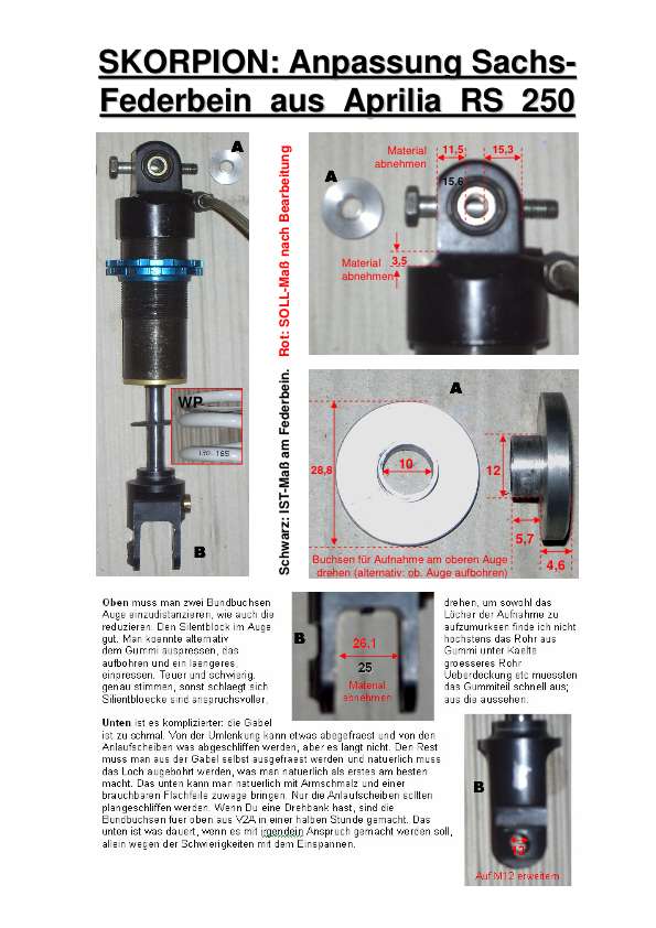

re. Sachs strut. At the moment, it is "on loan" to someone who bought a Sachs strut and is using mine as a model for the necessary changes. I have the WP spring from the Replica on the Sachs. Juergen -that's his name - made a .pdf showing and describing how my strut is changed and what spring to use - attached below.
Sachs strut for Aprilia RS250 with modifcations to fit Skorpion. pdf converted to jpeg

about the rs shock, i read the pdf once, but its in german and i didnt understand everything, maybe if i see a picture, before/after that it will become completely clear, the problem is that i dont have the machinery to modify the spring. i grinded my fzr shock at my old school, cause is was easy to do, different story with the rs shock i guess...
