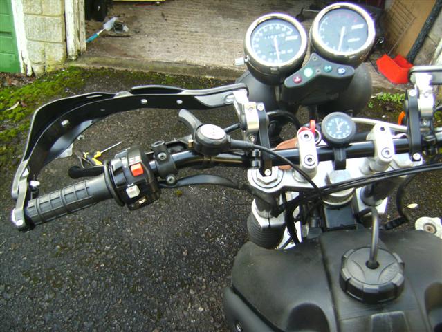

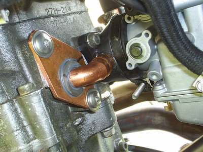

I thought that it had too much carb with the originals which made it to revvy for a 660 single, hence me putting a 40mm CVK on mine (love it BTW!) -
I had a bicycle gear lever mounted on the bars as a choke lever at on point, i probably have it somewhere.
