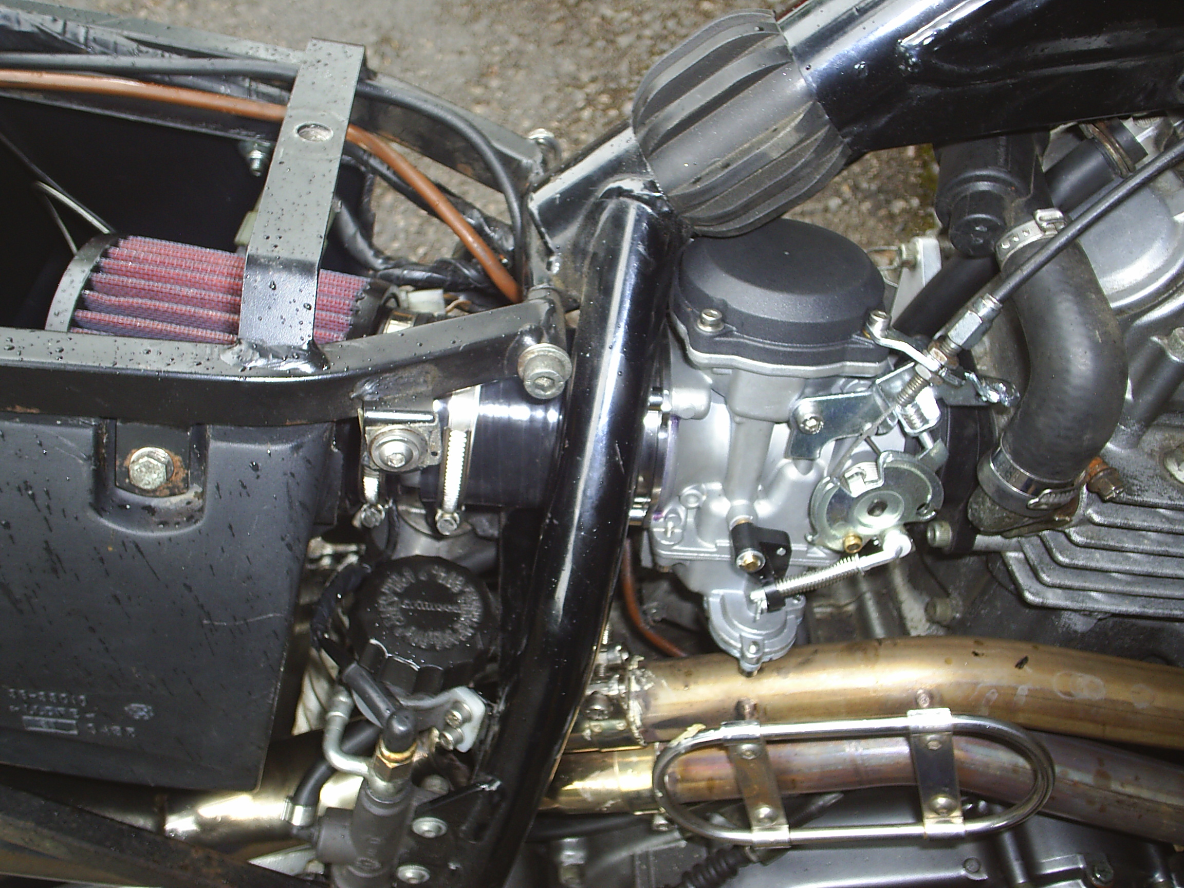

Do you really need to remove the air box?
I have an SP400 and the previous owner removed the air box to fit a silly K&N, and I deeply regret he did that.
At any rate, make sure your jetting is OK.

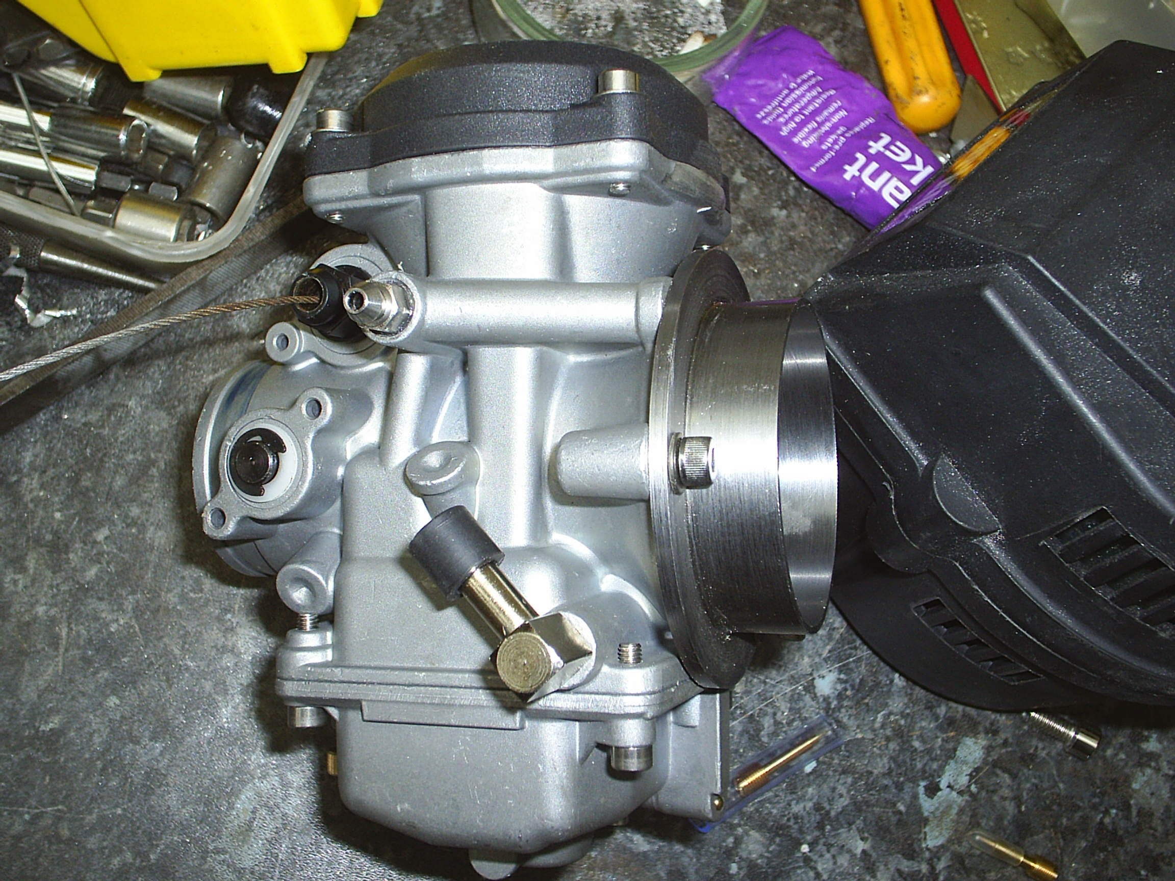

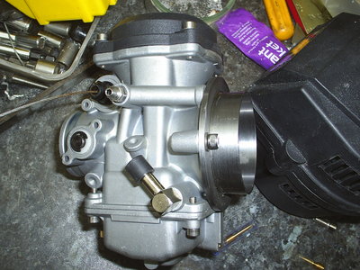

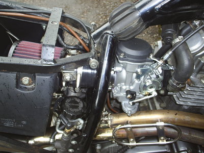

A mate turned up an adaptor to match my K n N filter to the carb for the price of a packet of fags and i put in the three attachment holes.
Pulled out the vent passage cap on the side, tapped it M8, and screwed in a modified brake bleed nipple to which a rubber pipe is pushed on to.
Rusty enrichener cable is only a temporary one!

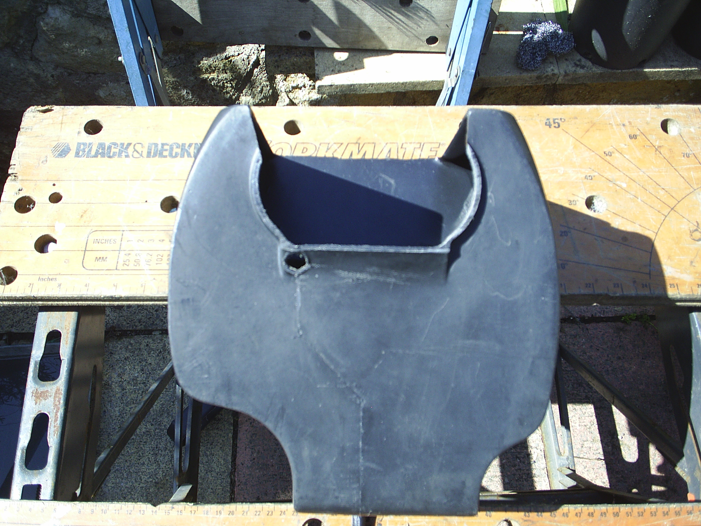

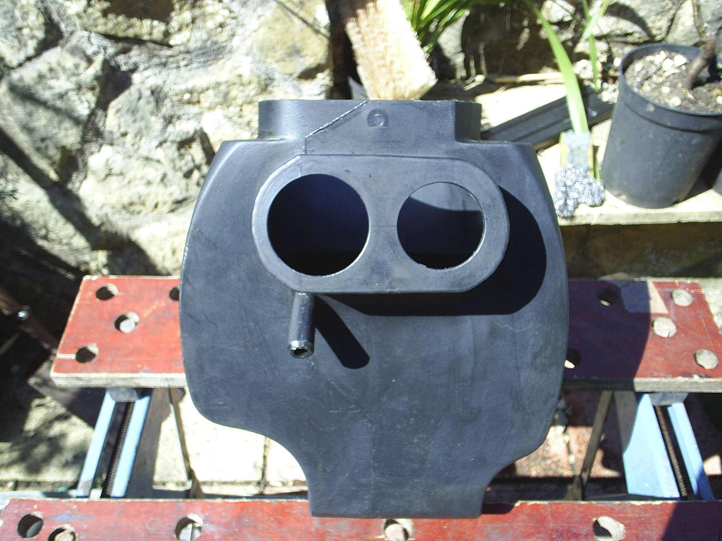

Air box modified and now await a 60mm ID silicon coupling hose -

Yes, mods to that airbox are in order.
Not a fan of K&N, as you may have seen elsewhere, but with proper jetting it'll do on a 4T.

It makes me wonder how it used to breathe at all to be honest, just between the top edges of the box and the underside of the seat and that (the air box)
used to have a vinyl lip filling most of that gap!

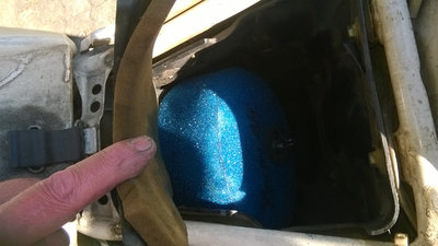

I don't know what the air box looks like on the Mastiff, but on many bikes there seems to be little breathing space between the seat & the top of the air box. But it's far away from the carb, with that volume of the air box between it, evening-out the pulsating suck-suck-suck of the engine. I guess they thought about it. Also reduces noise, as you know, an open throttle can make a bit of noise too. Hence the foam on the lid in
On the K&N on my SP400 I'm also using that blue Putoline filter oil, which gets very sticky when the solvent has evaporated. What does the official oil actually look like?

No, not this YZ. 55HP in a 96kg package (with a WR gearbox to cope w/ the difficult climbs). Juicy.
If you're talking about this type of foam filter & oil: nah, TwinAir & Putoline have been champion for many years, see fi https://www.twinair.com/world-champions-on-twin-air.php. Just count the titles.
If you're talking about putting this type of oil on a K&N: again no, the SP runs fine. Not a very fast bike, obviously, but few 40 year old bikes are.

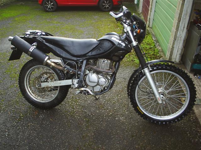

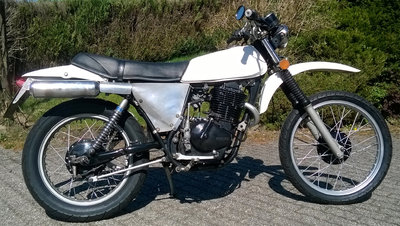

No sorry if I was unclear. The pic above the SP is an oiled TwinAir filter in it's airbox, in a YZ250. That too breaths below the seat, like your Mastiff. It has standard 55HP & weighs 96kg dry. Maybe a bit more now, as it has a bigger tank, lights & a different rear mudguard (with a tail light), maybe now 98kg without fuel. It's a different bike from the SP400 pictured above.
That SP400 has a bog standard engine, with originally 27HP, and originally weighing 127kg dry. When I got it, it wasn't quite complete, all the alu & the rear mudguard are mine. What it weighs now I wouldn't know, and I don't really care. I didn't make those things to make the bike lighter, just because I did not have the originals, while the steel mudguard was rotted.

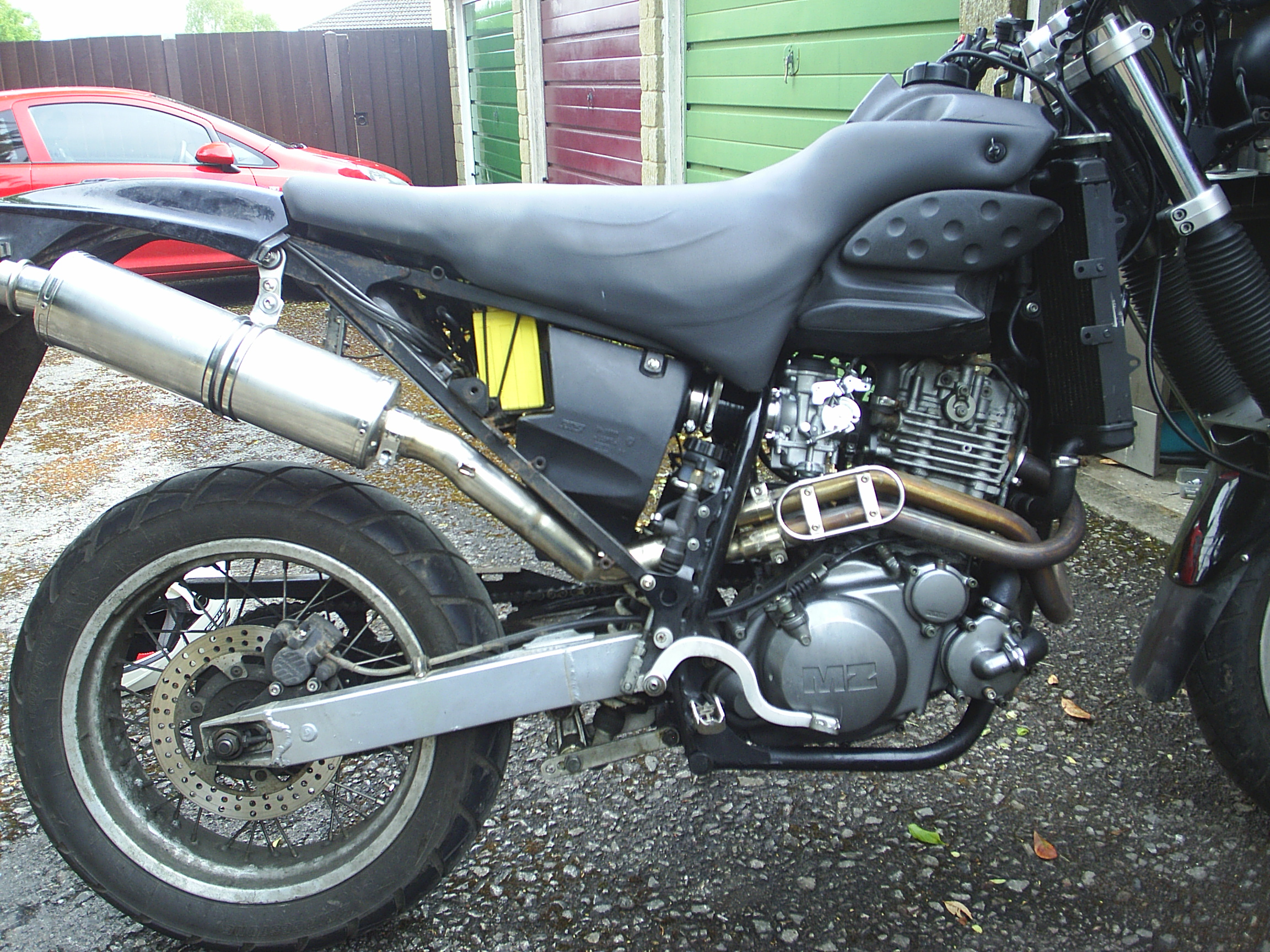

Well i`m so pleased with the way this runs i`m going to keep to this setup and not bother with the manifold and other inlet port, so thank`s to STANIMAL for the inspiration! viewtopic.php?f=3&t=7357
It`s more prompt to start and idle (especially from cold) and power is stronger and more linear right from idle up.
There was no numbering on the pilot jet but best idle was about 2 1/2 turns out so it must be in the right ballpark.
I`ve raised the needle with one M4 washer but i think i`ll add another.
I must add that i replaced the original silencer with a regular looking, road legal silencer and baffle and opened up the airbox at the same time as fitting the carb, so i`m not exactly comparing like with like.
