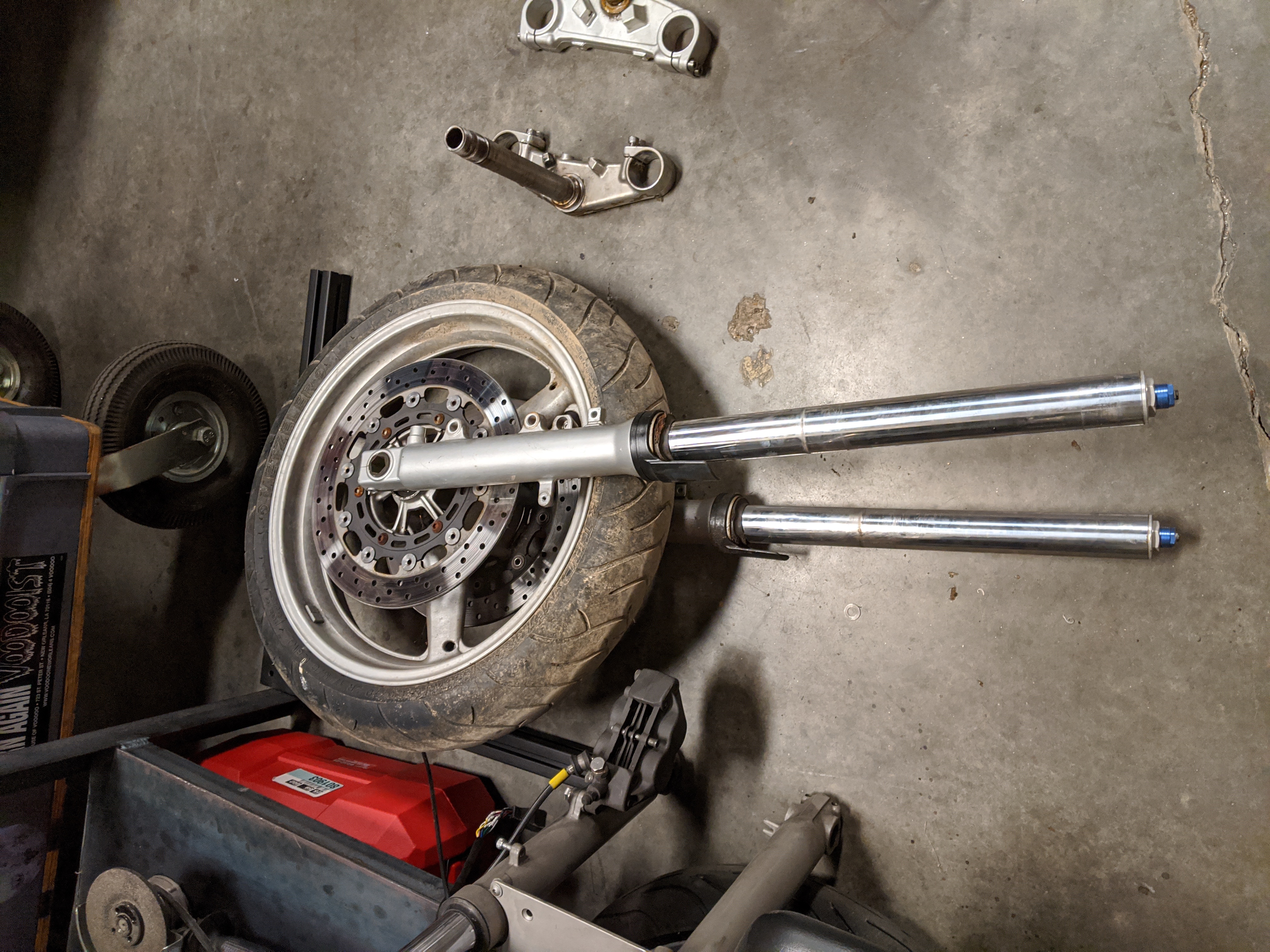

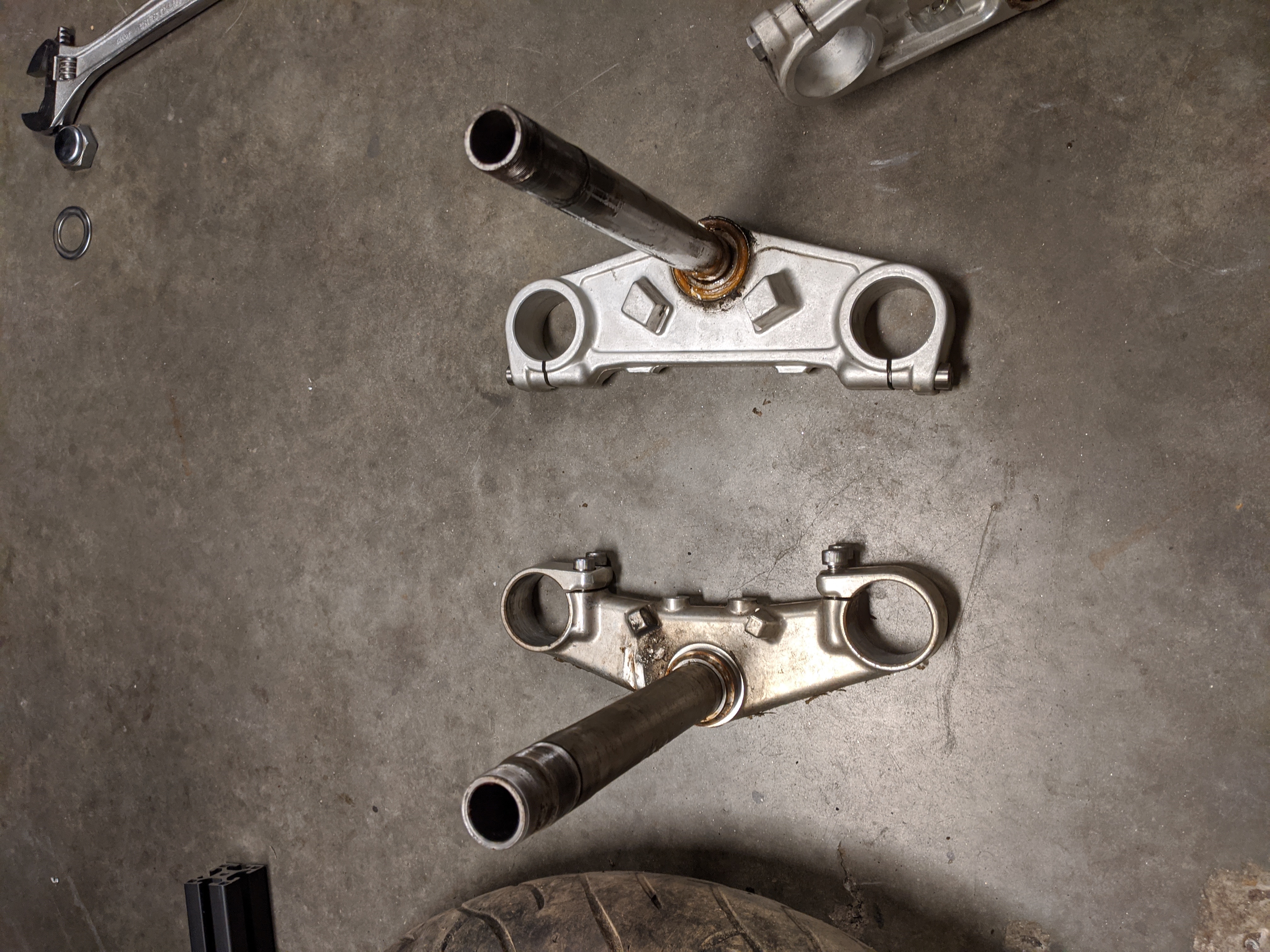

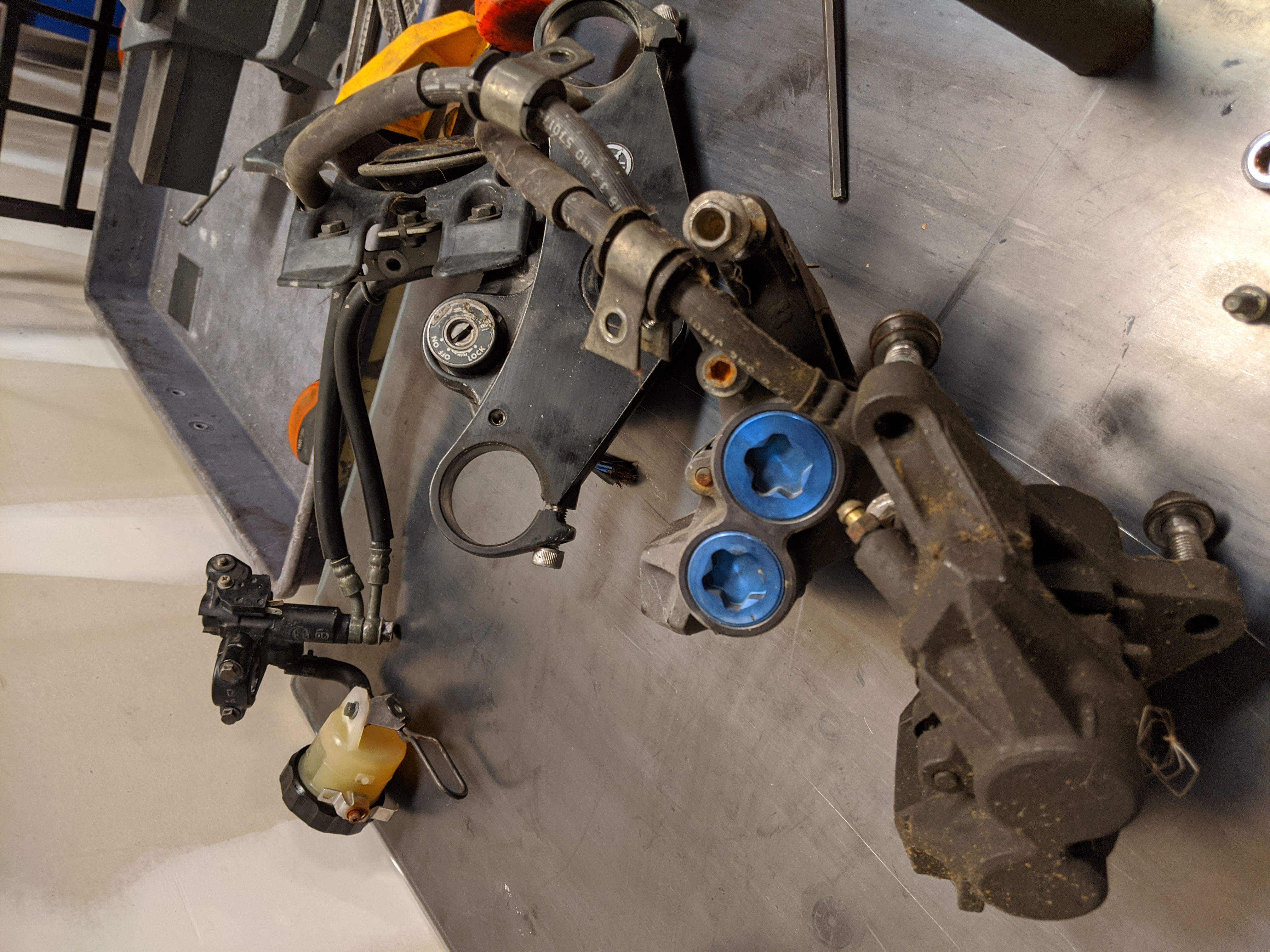

I went out to a local junkyard today and picked up a pretty nice front end off of a 1999 Yamaha R6. Came with everything I need to convert it over. I am going to freshen it up with new seals, bushings, rebuild the brake caliper, and see if I need new springs (which I assume I will).
Everything is so much lighter on it. Its pretty crazy.
The steering stem and lower triple seem to weight half as much.
the brakes are pretty nice too. Going to convert over to a single rotor. I don't think I need both.

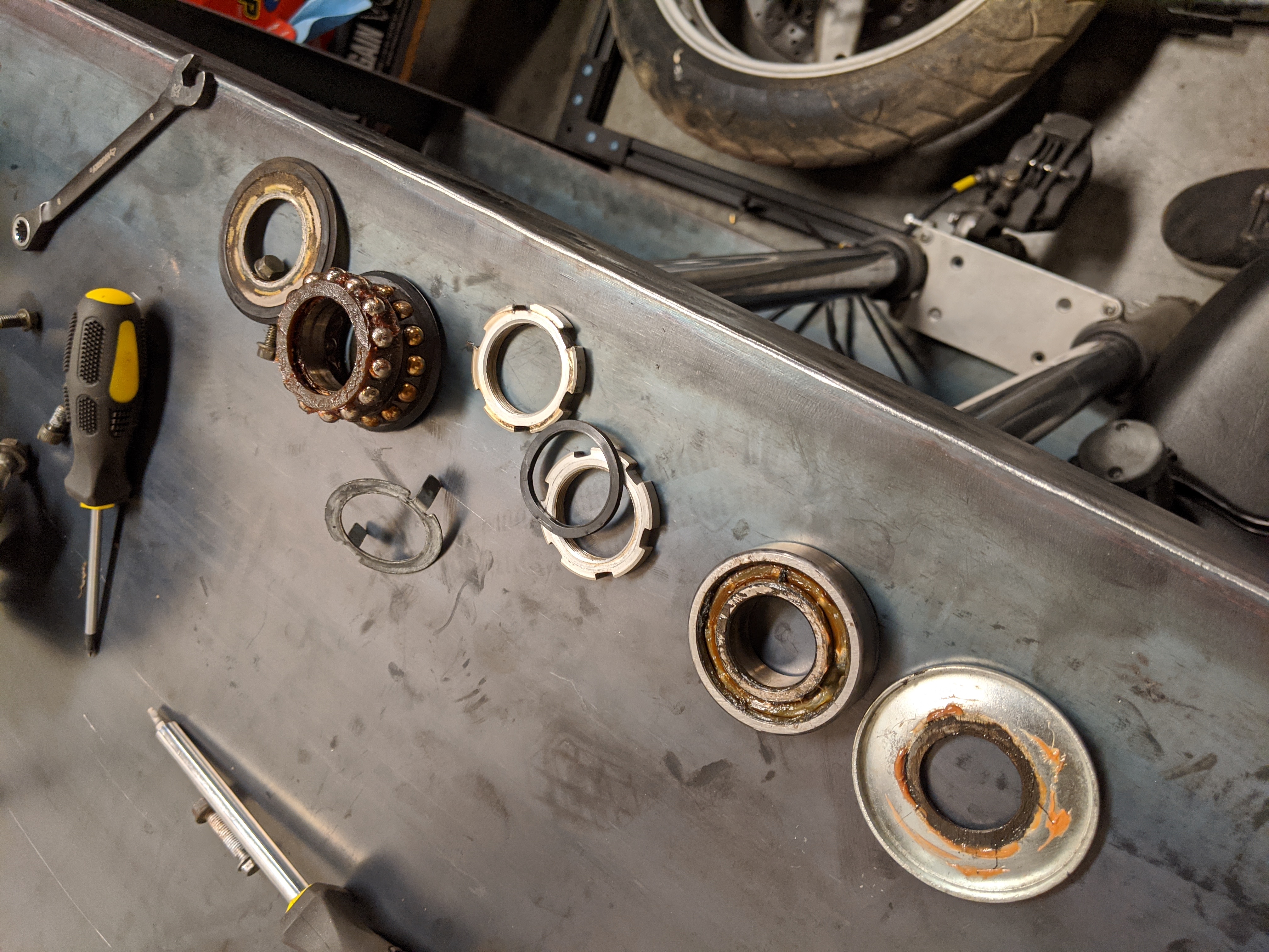

Measured up the steering stem bolts. The random blog I found awhile ago was right: DRZ400 bearings will work well. 30mm ID, 52mm OD, and 16mm height. It is very strange that the MZ uses just ball bearings for the steering stem as opposed to tapered bearings.
Not a bad haul for 300 bucks I don't think.

And here are the forks, though already stripped down:
The forks are right side up cartridge forks, fully adjustable. Plus parts and things for them are super easy to find.

Postby breakwellmz » Wed Aug 05, 2020 12:57 am
What`s not to like? :)
Is the wheel a lot lighter as well?

I measured some weights this morning:
Item MZ R6
axle 653g 364g
caliper 930 966
lower triple 1333 1153
top triple 1259 823 (this is with the handle bar risers still on the MZ and the stock key setup still on the R6)
forks 8.7 kg 7.53kg
wheel 11.6kg 11.6kg (this is with an old tire and both rotors on the R6 rim. I will weight them on more equal footing when I do the tire swap. I think the R6 will be slightly lighter.)
fender 625 505
Looks like I will be able to save at least a couple of pounds off the whole ordeal while also getting much better suspension. Can't complain about that!

Postby Puffs » Thu Aug 06, 2020 3:53 am
That seems like a worthwhile visit!
On using both disks/rotors: if you use only 1, all the torque from the braking will only be stopped by 1 single fork leg. That may cause extra wear, as well as torsion in the forks. Sometimes you see a brace between the 2 legs to combat that.
It's your bike, but I would very much prefer using both disks. Even though it's a bit of extra weight.

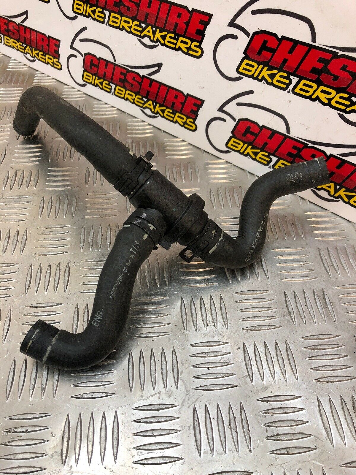

I received this via Ebay today but think it`s final resting place will be a bit different to yours due to the hi-level header pipes on mine, we shall see. -

Puffs wrote:That seems like a worthwhile visit!
That makes a lot of sense. I will look into either using them both or at the very least making a fork brace. I think it would be pretty simple.
Perhaps I will start with both and see how I like it. I don't think there is a huge weight penalty, I just don't know if for the speeds I am going having two discs is needed for a 350 lbs motorcycle. Something to think about!
https://www.ebay.co.uk/itm/Ktm-RC-390-R ... 2749.l2649
Nice! It looks like yours didn't come with a t- pipe for the water pump side of the routing, but that should be pretty simple to solve. I bet it works well!

No it didn`t but Ebay to the rescue again! - https://www.ebay.co.uk/itm/T-Piece-Hose ... 2749.l2649

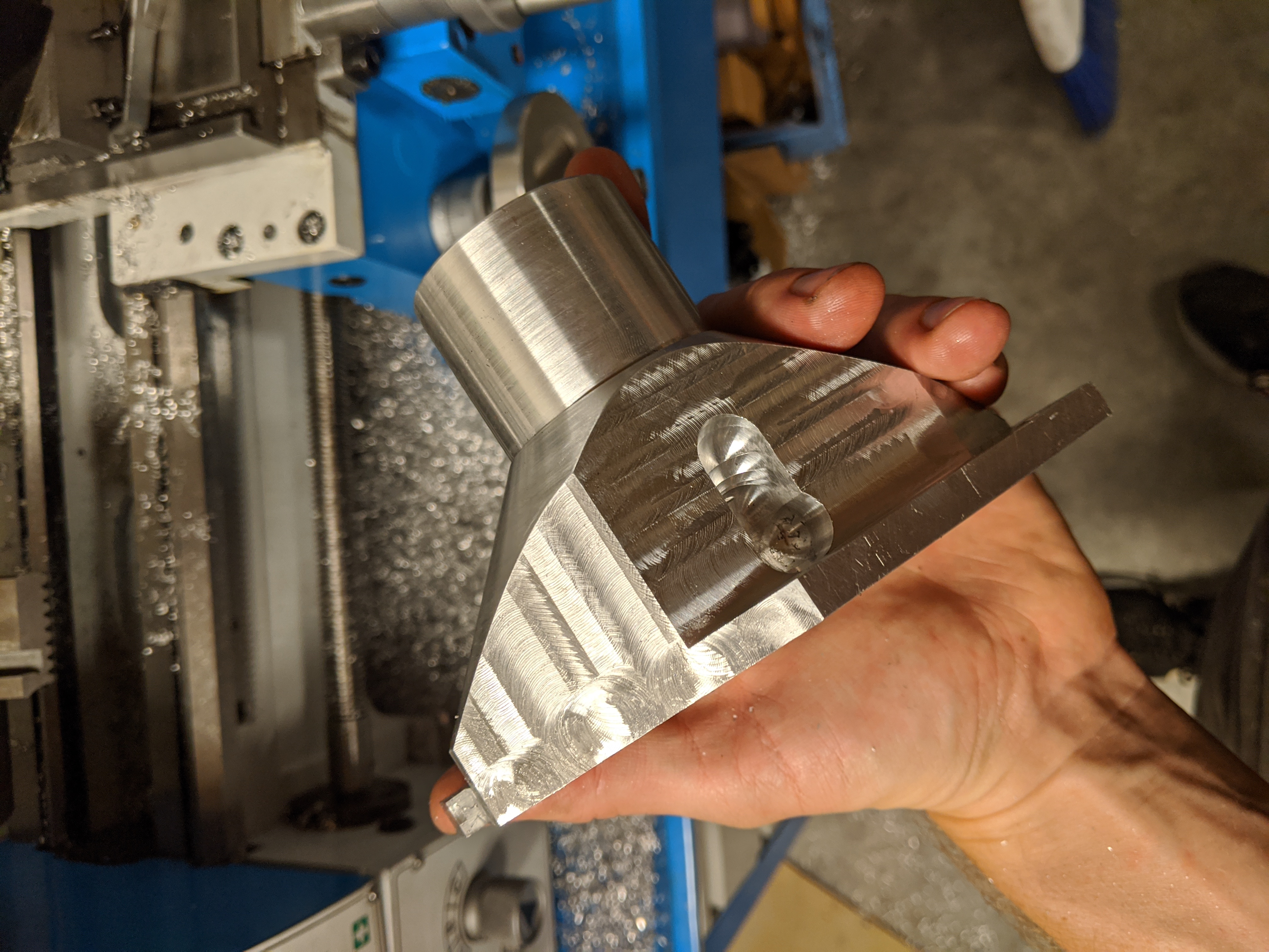

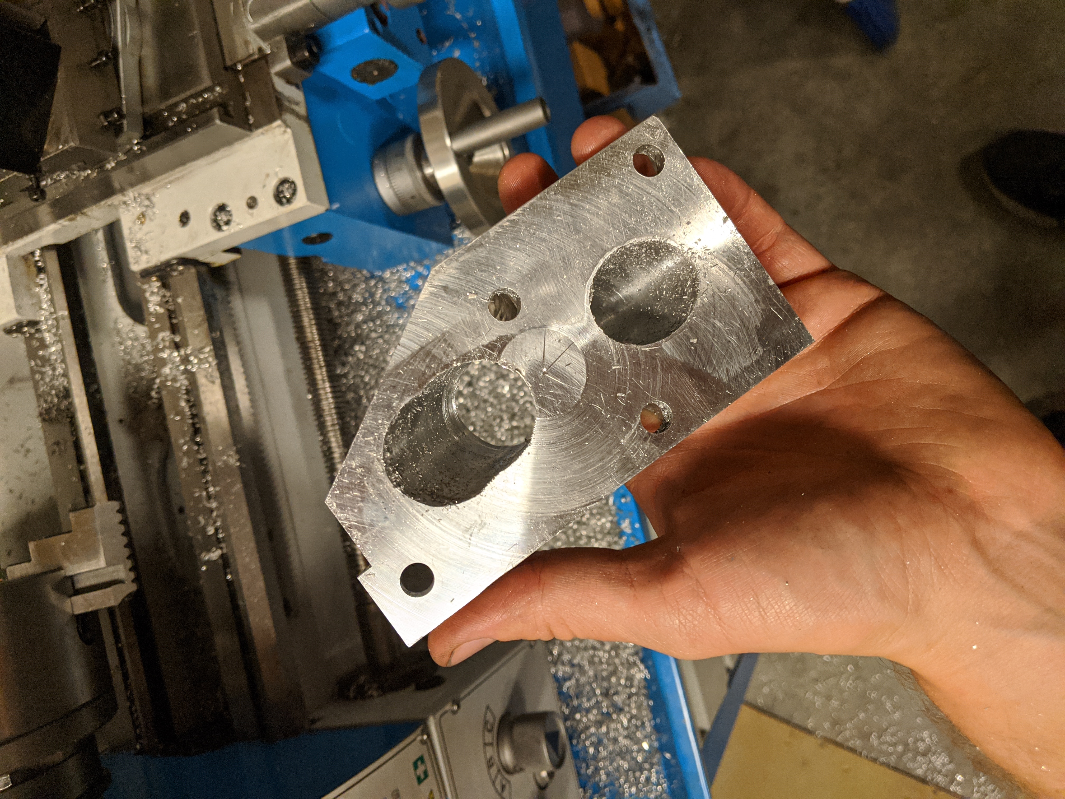

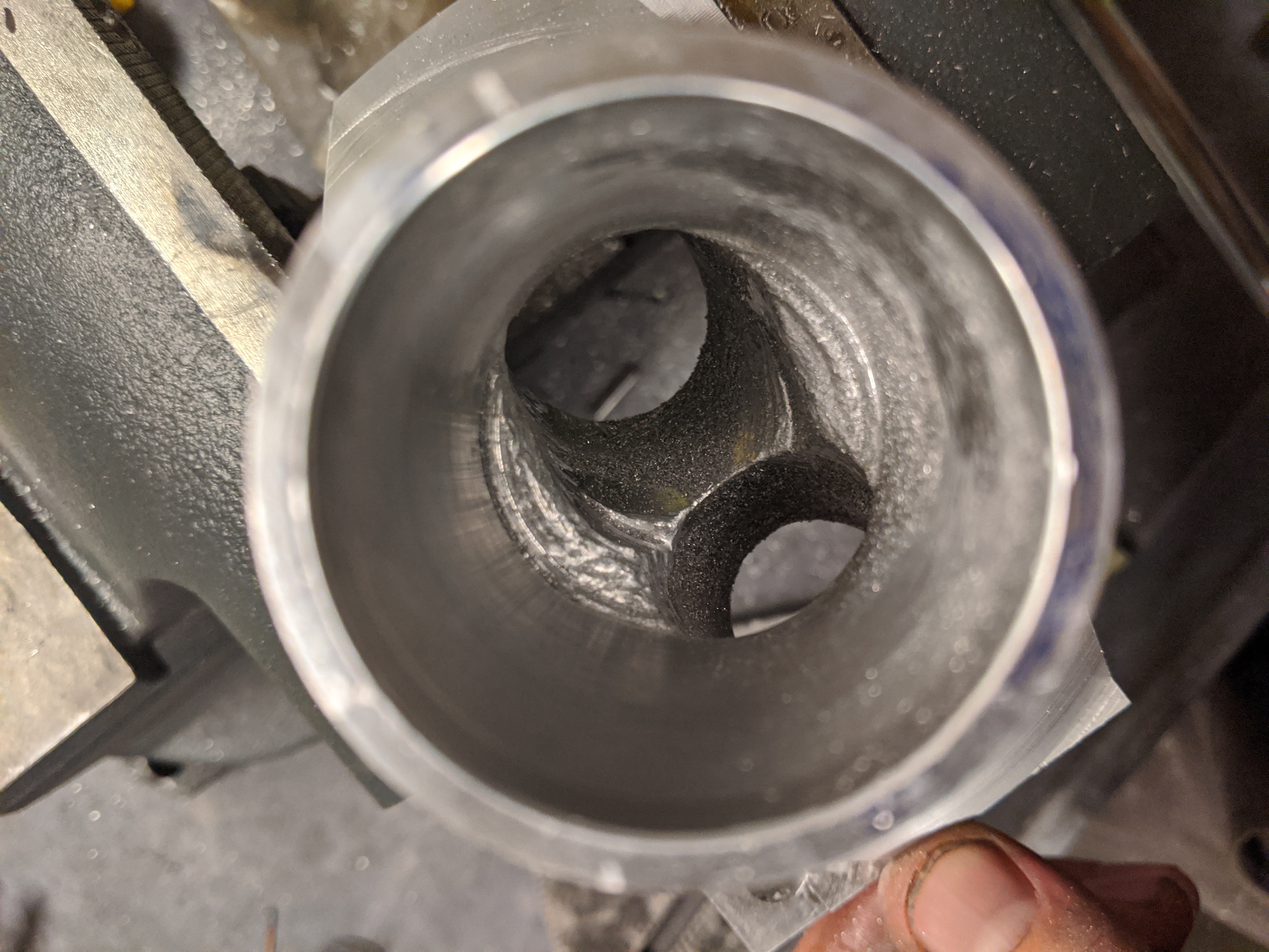

Got the lathe in last week and got around to continuing the intake manifold project. Did a lot of work on it today and got very close. a couple more small bits on the mill to clean up some bolt mating surfaces and some more time with the dremel to make the inside a little better and it should be good to go. Not the prettiest thing in the world as it is manually machined, but as long as it works. I built it long with the idea that I can always make it shorter, but its harder to make it longer.

Postby Puffs » Wed Aug 12, 2020 2:59 am
That looks suitable & beautifully machined!
You probably said so somewhere, is it stainless steel or alu? Regardless, me being old school, I'd put a file to it and thin the walls down, from the outside.
