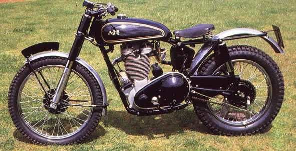

here, the classic thumper at its purest: the AJS 16 as trails bike. Just look how TALL that engine is. Over stump and stone at barely over idle...

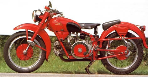

an original 500cc Falcone

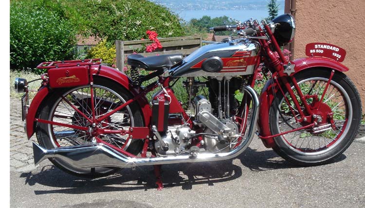

here a Standard with 500cc MAG motor

Bill, great pictures, great bikes!
