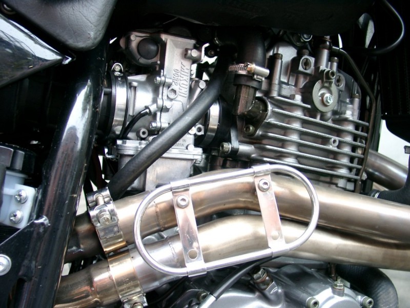

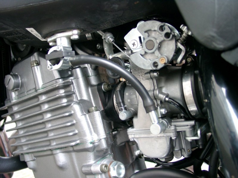

I just installed these(kit from Tunebike) on my Baghirra Forest and there where a really tight fit...
It looks like You moved the oil and ventline -did you have to change them?

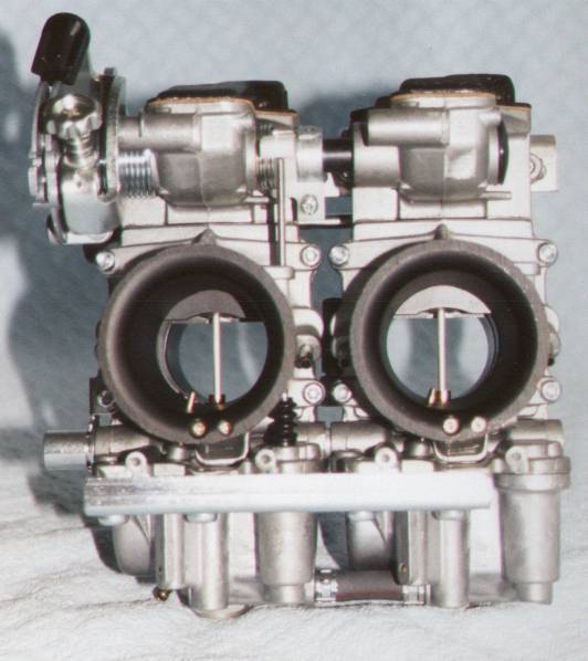

How much did the carbs cost total? In the throat picture, are the brass fittings at 7 o clock the injector nozzles?

I guess that the brass fittning is the injector from the accelerator pump.

By the way, the stock oil/ventlining can be placed on the left side of the carbs ;-)

My carbs are mounted and the only thing i had to do was:
1. Make the hole in the airbox for the left intake pipe bigger (used a Dremel with good result).
2. Get a larger clamp for the left intake pipe. I got longer screws for the stock ones to -it is easier to mount with these.

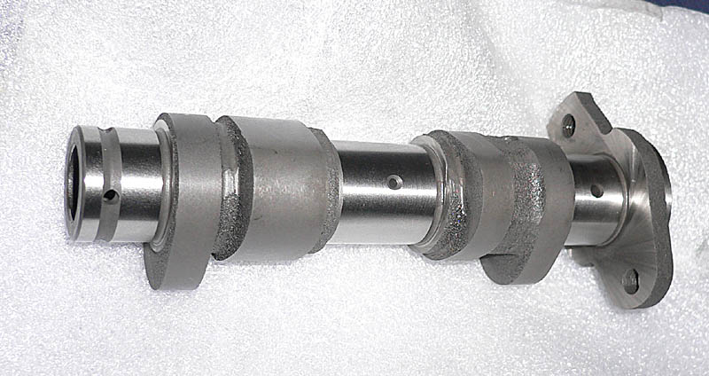

The Hotcams really look like crap/"not worked on enuff" compared to the MegaCycle cams -just a hint. But they are ready for the autodecomp from start = good + they are cheeper..

Hoke wrote:The Hotcams really look like crap/"not worked on enuff" compared to the MegaCycle cams -just a hint. But they are ready for the autodecomp from start = good + they are cheeper..
That's not good, but I guess you know they work ok. You mean they don't look nicely machined? And the MegaCycle cam - you have to modify it for the autodecomp?

This is the new Hotcam(pic) and the Megacycles http://www.megacyclecams.com/catalog/catalog.pdf
Hmm i do not remember what was up with the Megacyclekams and the autodecom.. My friend had one used X2 and one X4, at least the the X4 was not prepared for the autodecomp (they had to bore the cam to make the autodecomp to fit).

:!: :shock: that cam is rough! ...the only cams i've seen are shiny, smooth. it looks like that one needs running-in for like 1000s of km.! but maybe i ..just have not seen so many cams. are you sure it is finished? :shock:
