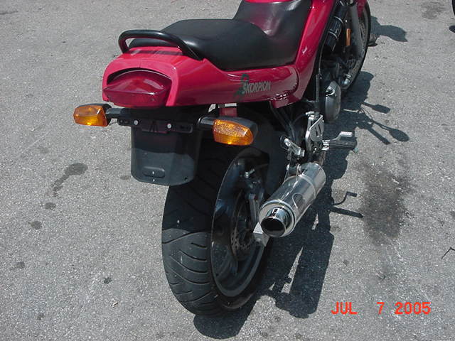

Postby Chayanne » Thu Mar 30, 2006 6:23 pm
I have a MuZ Skorpion Tour 2002 I'm already change my rear tire from 150/60/17 to 170/50/17(Metzeler) I don't see any problems, but the seat is too hig to me, I can reach with the two feets but not plain (My legs height is 29-30 inches) if your 32-32 probably you don't see that problem.
This is a MZ SKorpion Tour same year but isn'ot my unit...
