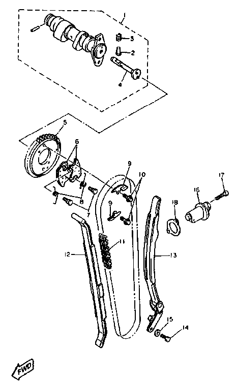

whats test for worn timing chain.. how would i identify if its stretched. ?
handsomejackuk
Posts: 938
Re: odd misfire hiccup...
Postby Puffs » Mon Oct 12, 2020 5:30 am
The give-away is if your tensioner 16 is at the end of it's range.
Chain clatter, when you move the crankshaft forward/backward?
When you have the thing open, the book will also specify a maximum length for a set number of links.
