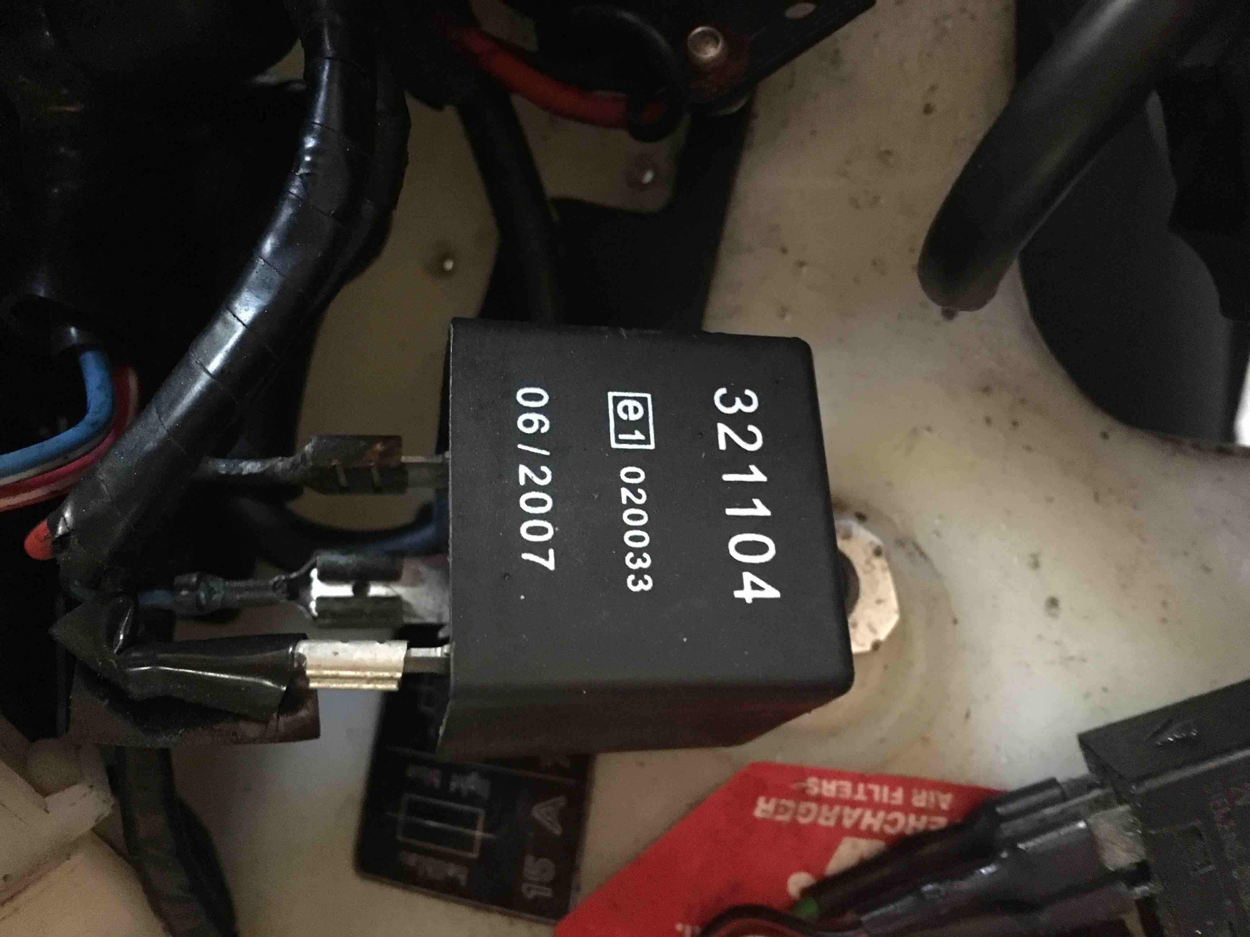

It's not clear to me from your posts which model MZ you're having the problem with. I can only say that on my Scorpion Sport the flasher unit (side lights intermittence) is under the seat unit, held to the front section the oil tank with a screw. I believe this is the standard position. I did, in fact, experience a similar problem a couple of years ago and it was only fixed by replacing the flasher unit with a genuine replacement from Graham's. (Quite expensive as flasher units go, if I remember correctly.) Photo attached shows the flasher unit in-situ. I hope this helps.

Thanks a lot, after having a look to the drawings and removing the left side panel i found the flasher.

I used the battery tester to check what are the power and earth cable and... I noticed that no current comes to the flasher!!! Stupid me that didn't check ast week.
So it is possible that there is some interruptions in calbes, maybe on the handlebar command or some connectors. So, now I have to wait the weekend to have enought time to disassemble tank and check everything.
