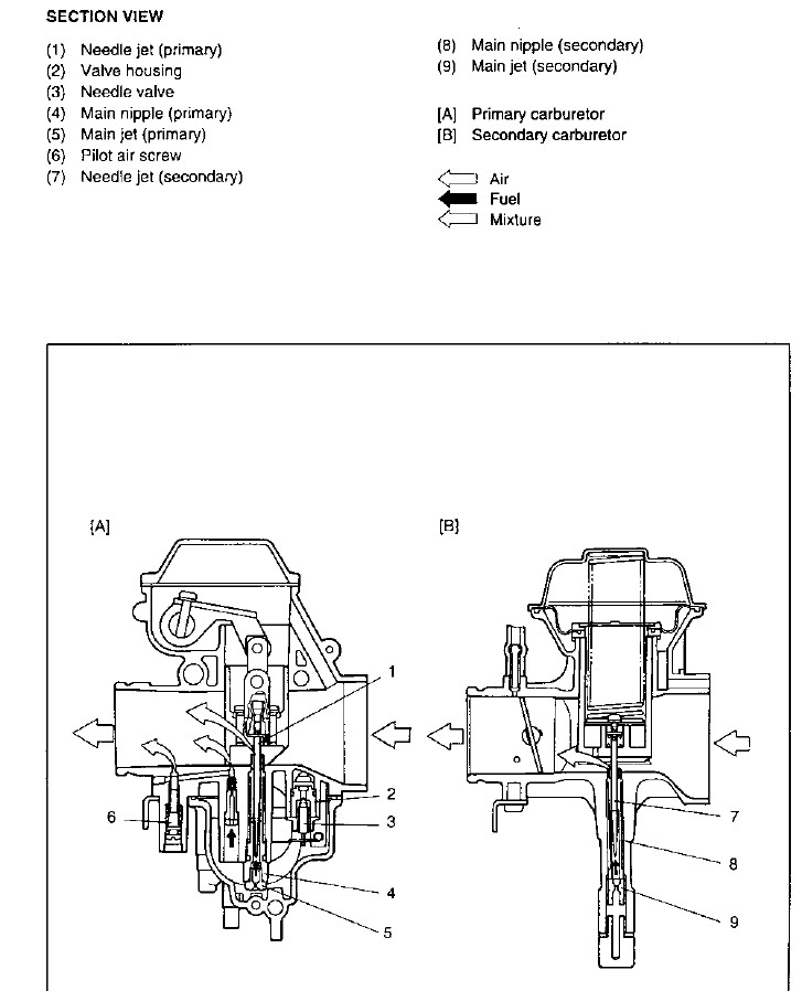

Hi Krusty, before blaming the carb for this popping and banging: check the header gaskets if they're the culprit. If there is an air leak this gives you the biggest bang for the buck as well ;-) Old reused gaskets are a no-no and new gaskets sometimes need some tightening after the first heat cycle.
About your question: 2,5 out should do with stock setup. Turning the screw out is richer, look at #6 in the drawing:
The pilot screw adjusts the amount of extra fuel mixture through it's secondary fuel orifice.
