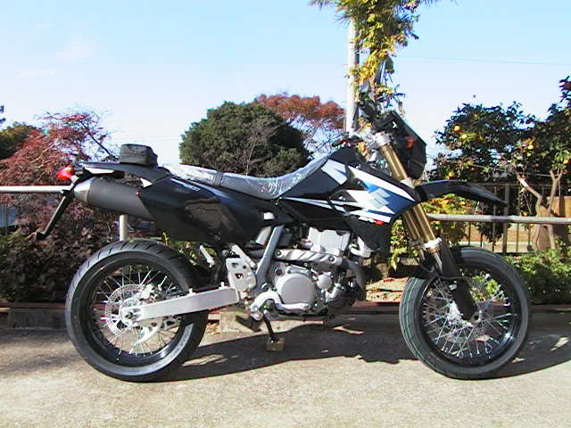

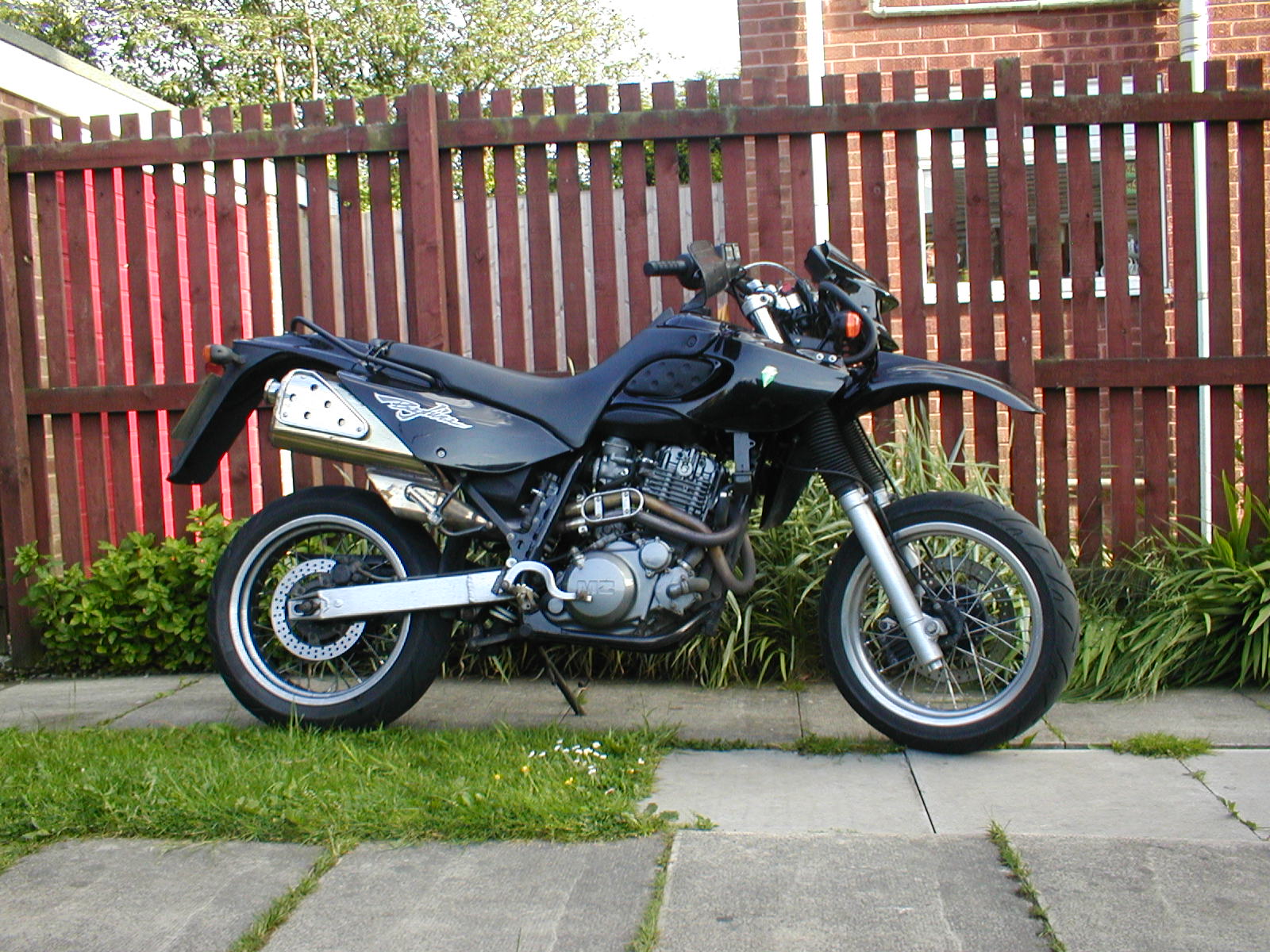

Postby TomLondon1978 » Tue Jun 14, 2005 3:31 pm
Is it possible to get some more sporty looking tyres on this bike as I really like the lower profile ones like on something like the DRZ400SM that Im also looking at.
See the pic for what I mean about tyres.

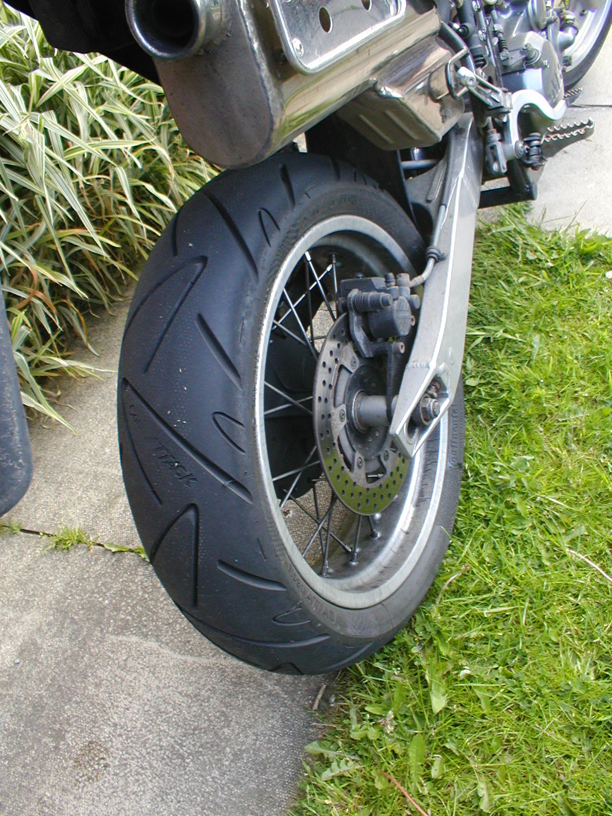

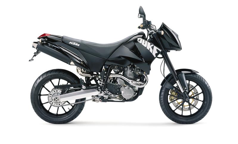

Postby TomLondon1978 » Tue Jun 14, 2005 3:52 pm
See what I mean by the tyres? Also the Duke ones look nice maybe could get those wheels and/or tyres on the baggy?

Postby keithcross » Tue Jun 14, 2005 6:52 pm
Tom
Check out any of the major tyre makers lists for the correct size tyres. The tyres shown on teh KTM photos can be used on teh baggi street moto and panther models.
For a real neat look, tryAvon Pro extreme rain tyres. Some rider I know also use proper race wets or even cut slicks on teh road, but teh police really dont like them if they catch you.
Keith

Postby phlat65 » Tue Jun 14, 2005 7:29 pm
any 120-17 front and 160-17 rear will fit your bike. very popular size tire, 100's to choose from.

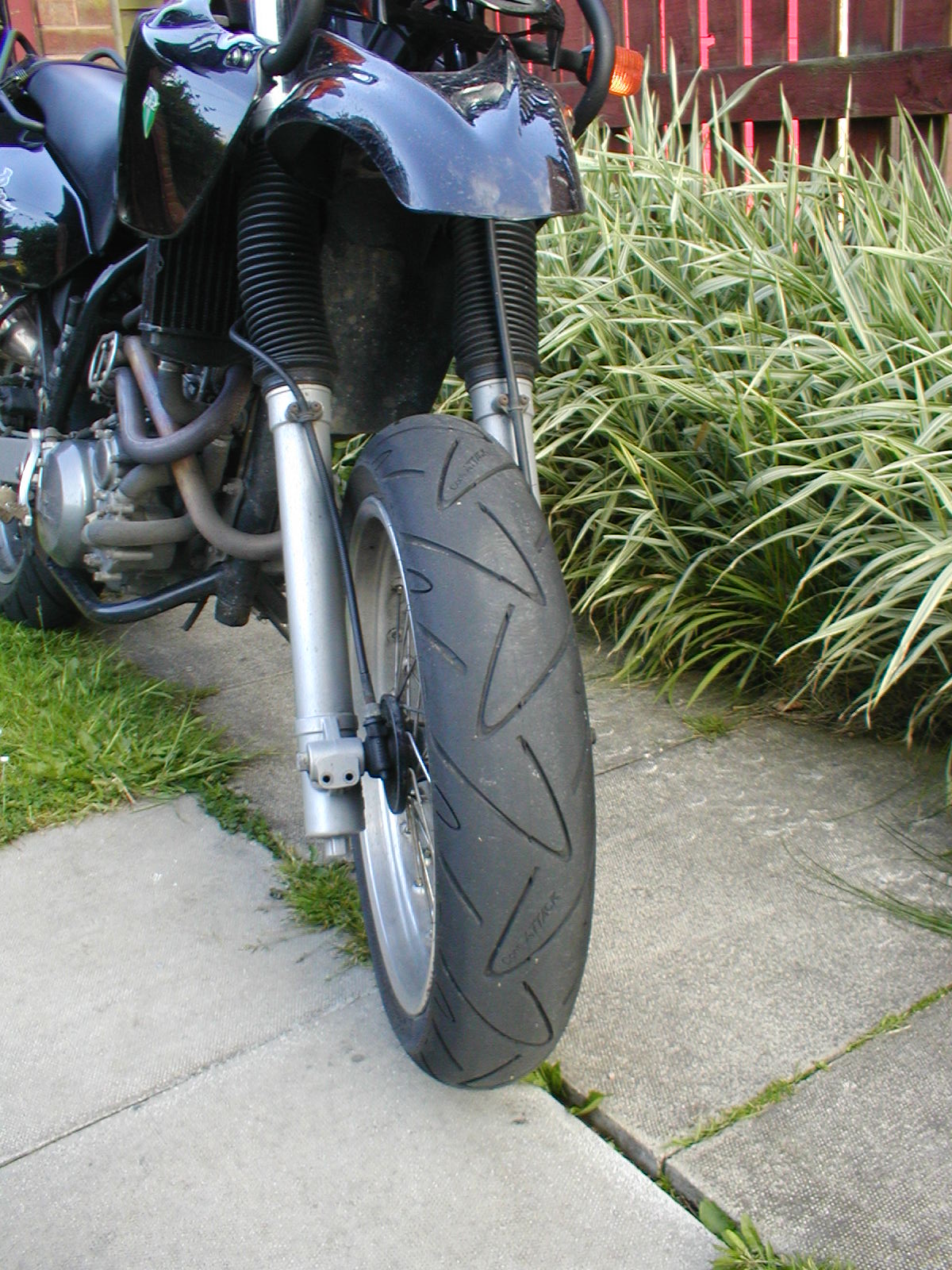

Postby Flipper » Thu Jun 16, 2005 8:03 am
Well spotted. As you can tell, I prefer riding it to washing it.

Postby boysie » Fri Jun 17, 2005 2:50 am
I hope your going to fit the axle clamp bolts to the lower fork leg before you ride it :shock:
