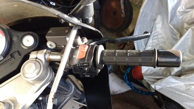

Can I have a pic of your reversed bars and how they fit the fairing? Cheers Eric

Postby lavrentyuk » Wed Feb 10, 2016 5:50 am
Shall do, I'm going to try a different pair of handlebar muffs this morning. The ones i put on tend to blow into the brake and clutch levers so shall do it when they are off.
Swapping was a fairly simple job BUT you will have to drill new holes for the switchgear locating pegs. It is a job you really have to get right first time, i recommend a spring loaded centre punch. Also be aware that the holes are different distances from the ends of the bars.
Clearance is just fine. Bit of fine tuning before nipping up on the bolts is all that is required so the levers don't quite touch the fairing. The fairing braces weren't a problem.
I do sometimes think i should have a gone for the Tour mind. More bar options and much better headlamp, better for luggage too, just not quite so pretty.

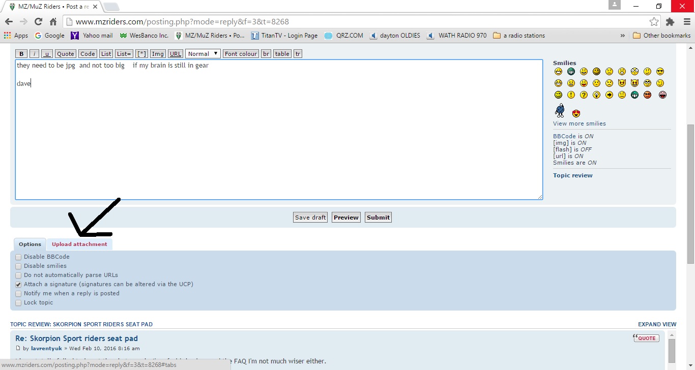

I have totally failed to insert the photographs I'm afraid, having read the FAQ I'm not much wiser either.
Richard Marshall
Wales, U.K.
lavrentyuk
Posts: 137
Re: Skorpion Sport riders seat pad
Postby DAVID THOMPSON » Wed Feb 10, 2016 2:38 pm
they need to be jpg and not too big if my brain is still in gear
i think my brain is getting fried i had to go read notes in a little book to remember how to make this post :smt006
CLICK ON THE PIC BELOW FOR A BIGGER VIEW

Postby droy » Thu Feb 11, 2016 8:18 am
Comment/question
Those don't look like the stock clip-on's -atleast what we got in the USA.
Looks good otherwise

Postby tigcraft » Thu Feb 11, 2016 6:10 pm
They do over here!
