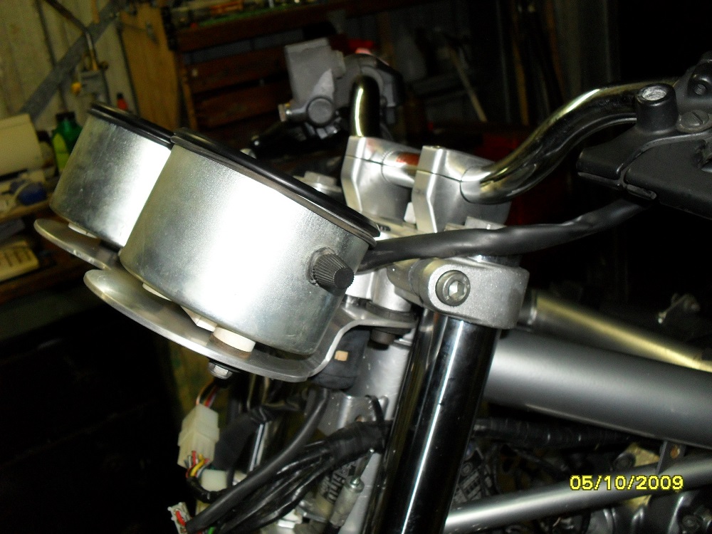

This is the sight that met me when i picked it up a month ago..
The rearshock in need of some new paint
A slow transformation back to some dignity and better shape...
And some new paint...
Cleaning....
Putting it together...
This is the shape it's in for the moment. Month some parts...
