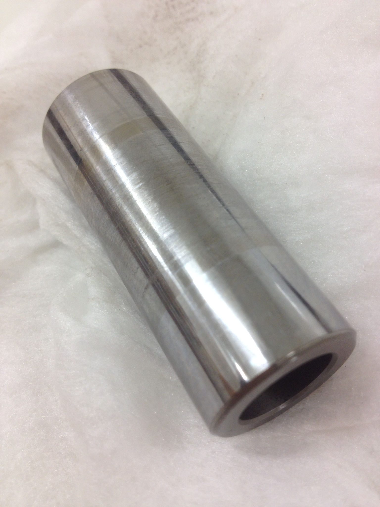

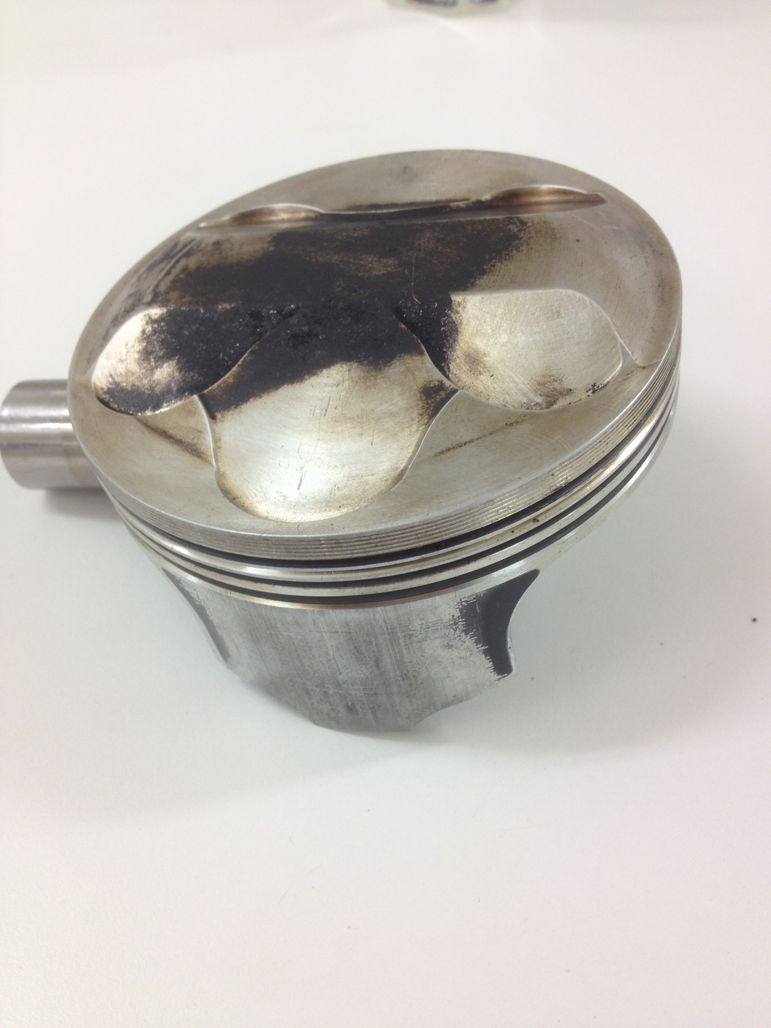

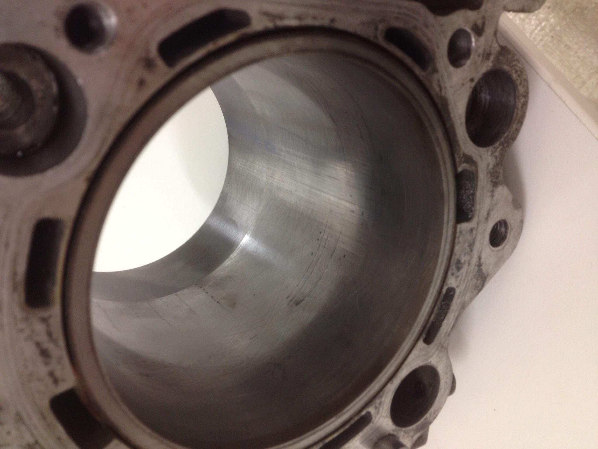

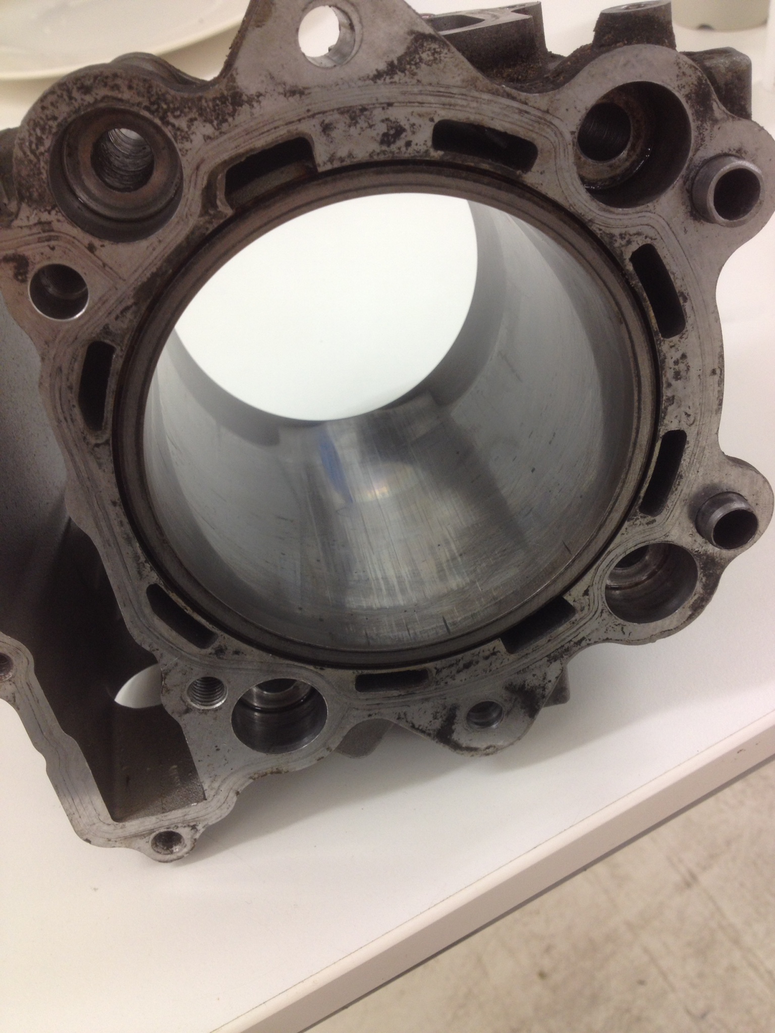

The piston Skirt was a little wore and the barrel was glazed with some small scratches, although everything seems in spec. But then I found something that made my heart sink, when the piston was remove I discovered that the wrist pin was loose in the small end, both seemed to have score marks. This could mean only one thing the engine had to be removed from the frame and disassembled:(

Glazed, scratched barrel
score marks on wrist pin

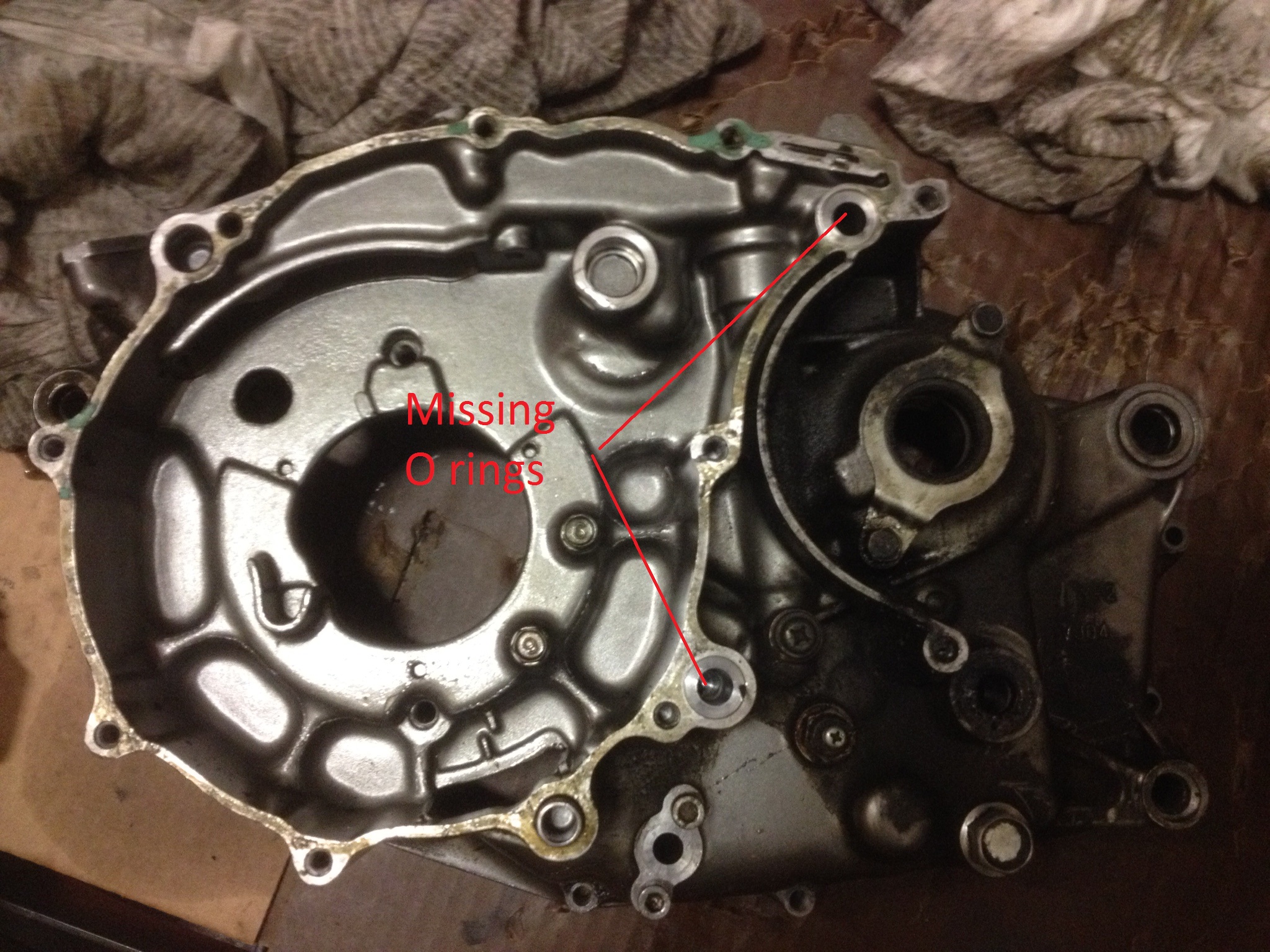

So firstly all the flywheel side components were removed, whilst stripping this side I noticed that two o-rings were missing from the oil channels. Then the clutch side was stripped and the gearbox cracked open, this was interesting when all the gears flew everywhere:) The gearbox casings separated surprisingly easy without using a special tool, is it normal for the big end bearings to slide easily on the crankshaft?

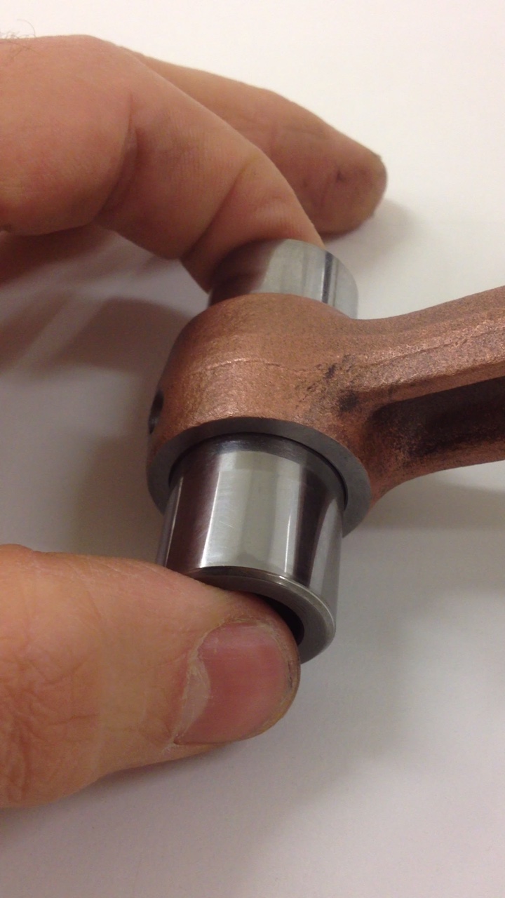

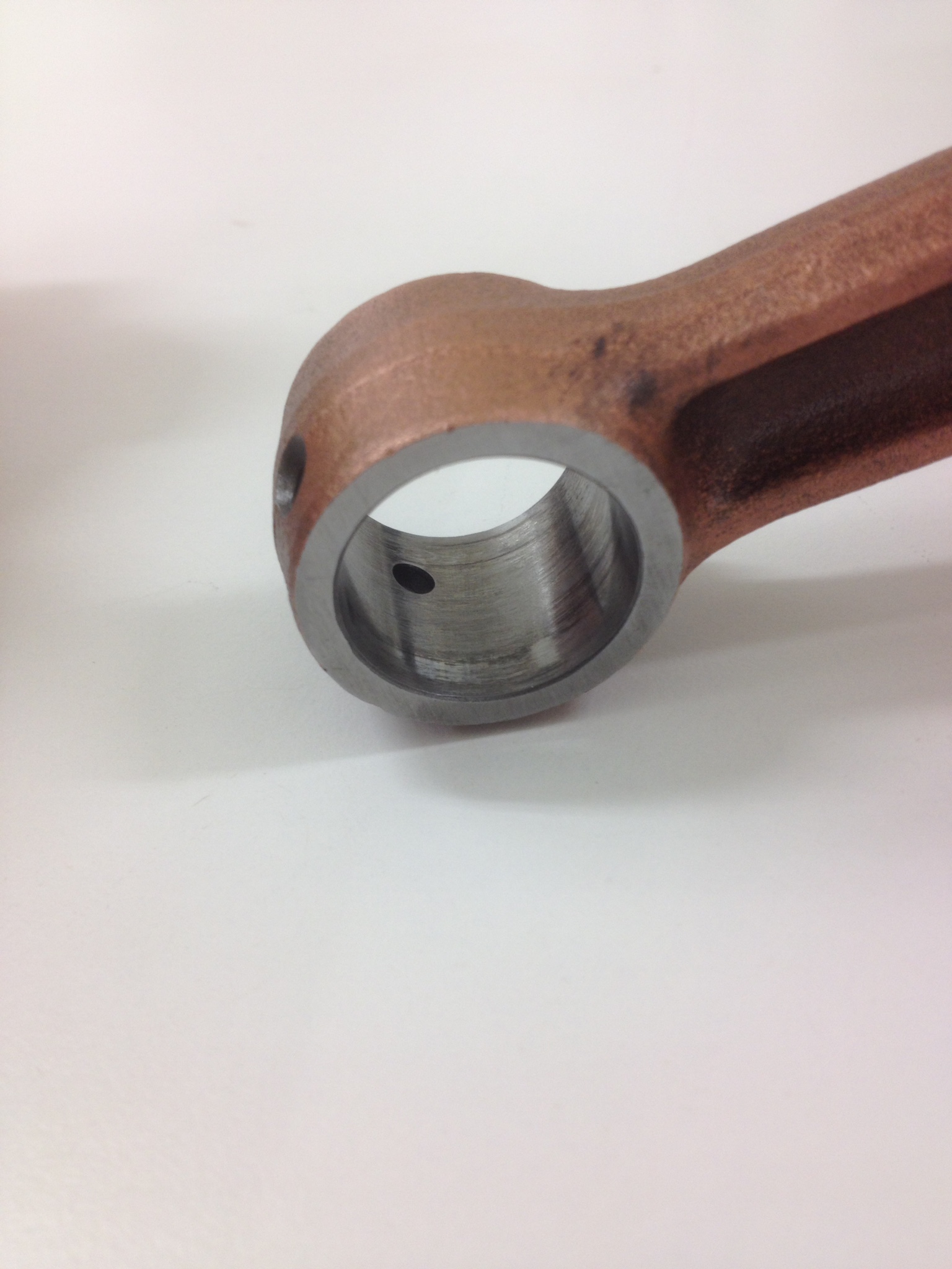

score marks on small end
the pin is loose in the small end

You definitely need to bore that cylinder. What's the big horizontal gouges? It looks like the engine was seized at some point and the rings were rusted to the walls.
As for the crank and con rod, may as well take it to a professional to have it checked against the specs and rebuilt with a new rod. I think Carrillo makes rods for the Raptor that will fit on the MZ crank but the crank ends are different, probably an XT600 crankshaft. I'd stick with the stock crank if it's salvageable.

I will definitely go with your advice and re bore that cylinder to 102mm, it hasn't seized or anything since I 've had the bike but anything may have happened with previous owners.
another angle of the cylinder
Probably won't bother with lightening the balance shaft or flywheel then, maybe the bike just felt so weak because the timing chain was so far out and the bad cylinder condition.
Those Carillio Con rods look so sexy, although the price is rather steep. I am still playing with the idea of machining the con rod small end 1mm larger and pressing in a bronze bushing, whilst it's still connected to the crank. Although this would weaken the con rod somewhat so I would like to find out if anyone else has tried and tested this.
