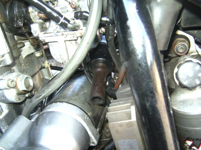

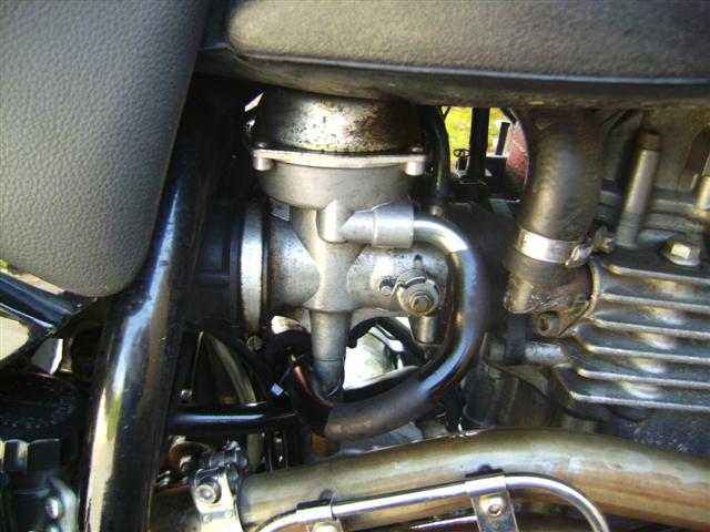

Postby breakwellmz » Fri Sep 18, 2015 9:08 am
I GOT I WRONG AS WELL!!
The open ended tube in the middle of the top picture comes from the carb diaphragm not the one from the crankcase(On the left)
Note to self-wear your specs when you go to the garage! :oops:
