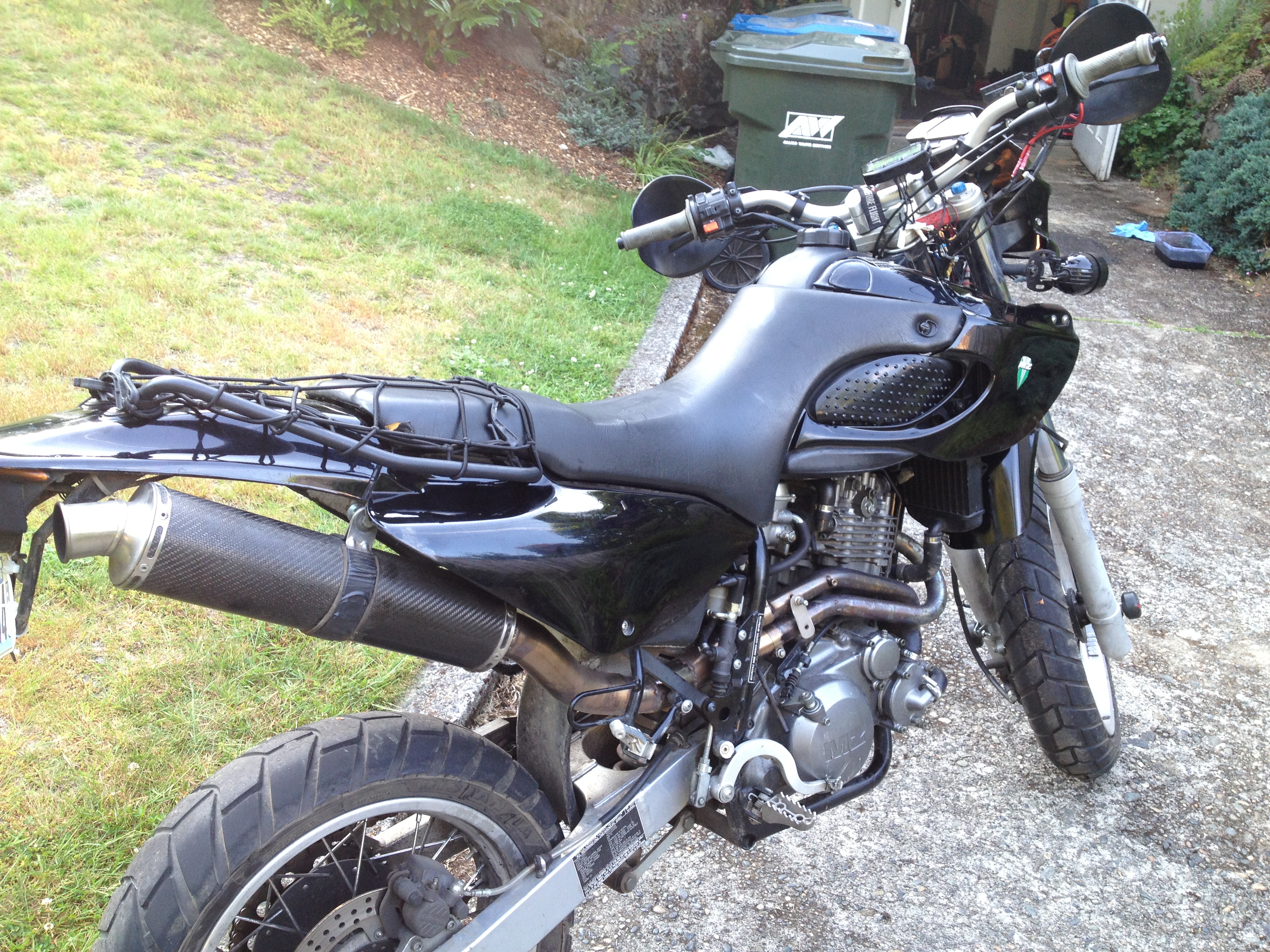

This is what it looked like a couple days ago before I tore it apart.

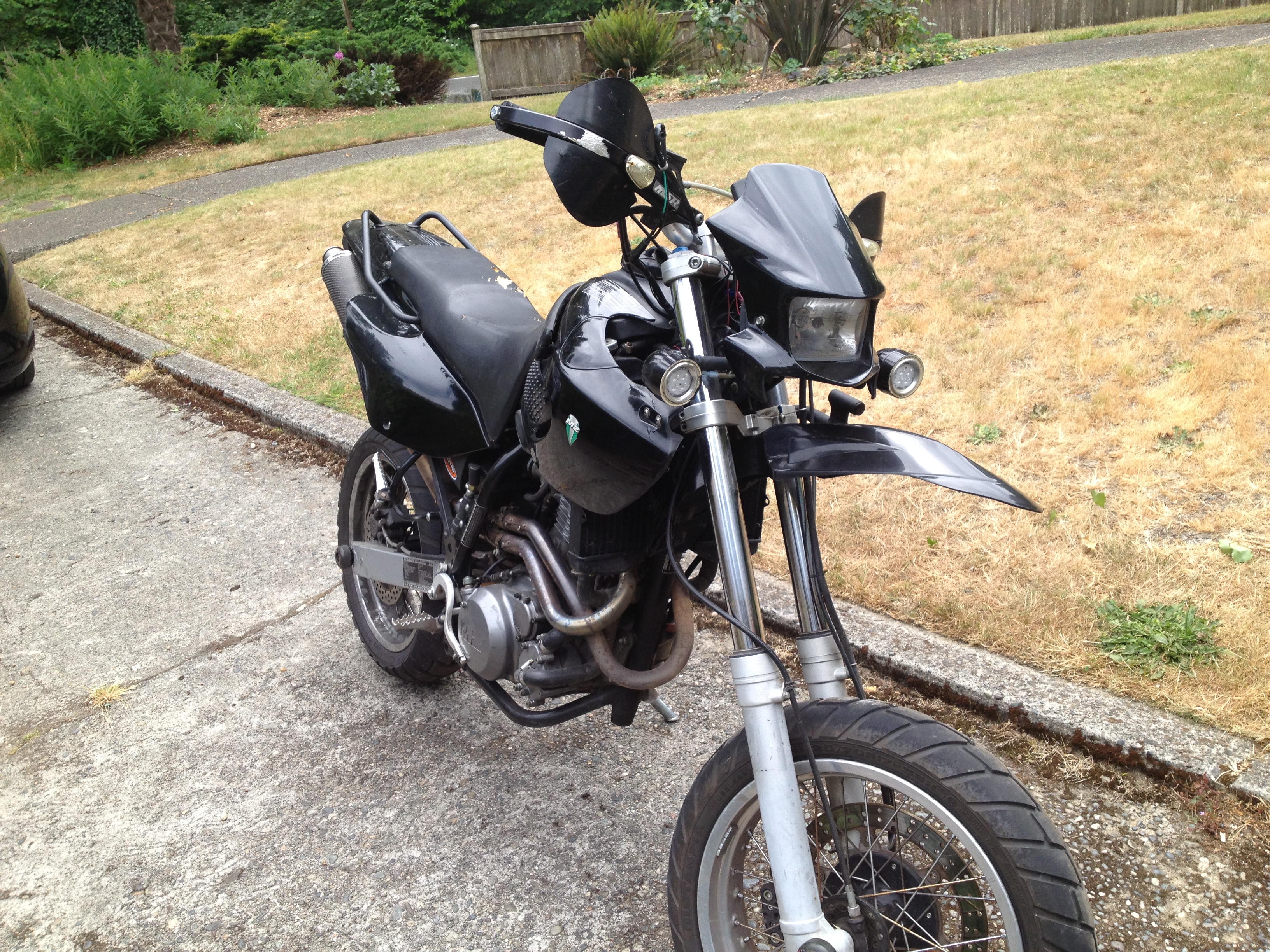

Here's what it looks like today with a new front fender and the stark realization that it's gonna take some doing to make this a sexy bike.

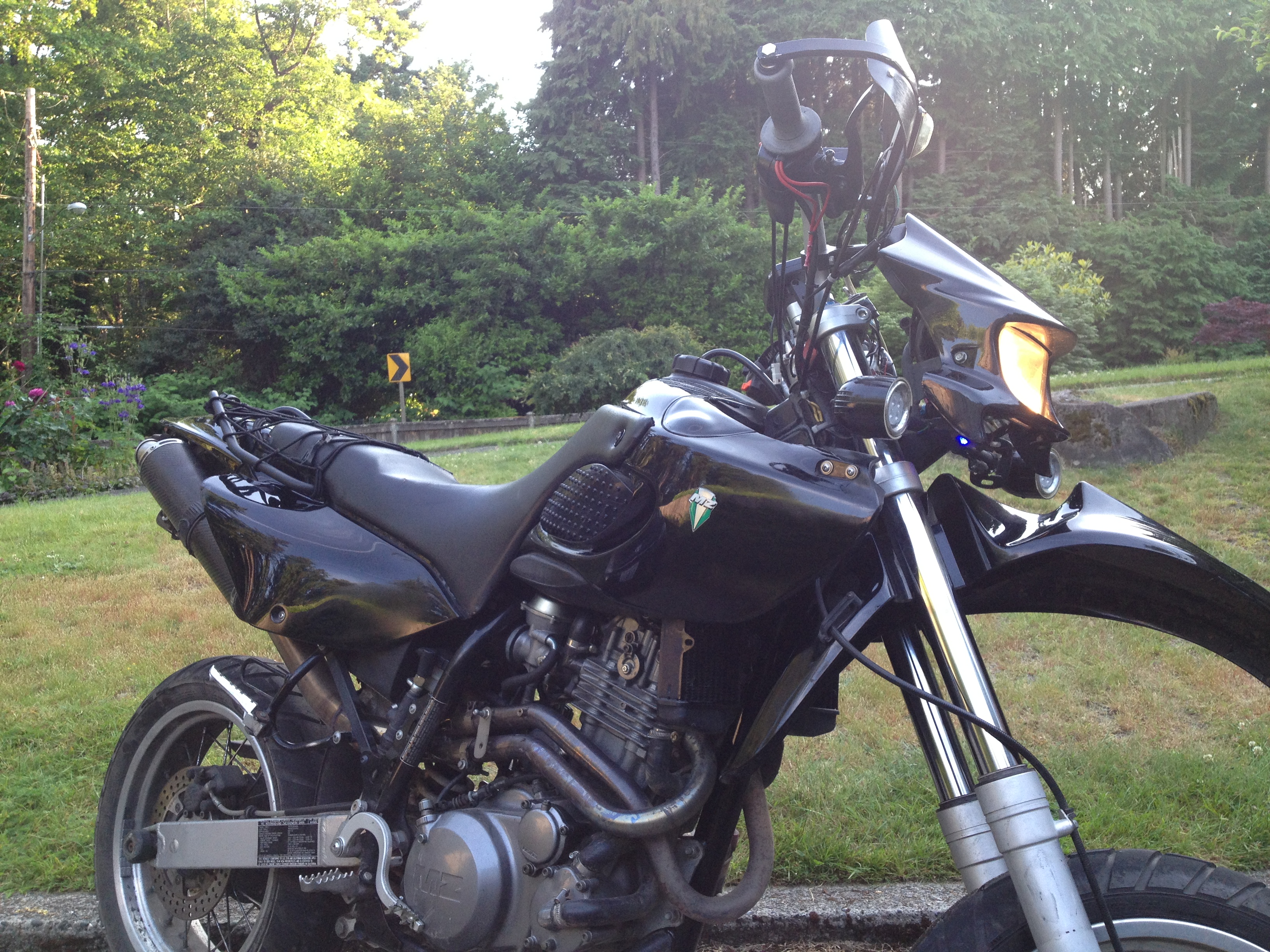

I am so lost when it comes to the headlight. In these two photos, the headlight seems more compact and streamlined which is what I would prefer. Maybe it's a later model? http://imgur.com/a/tB9QG
In the second photo if anyone know's anything about that skidplate or the radiator guards I'd appreciate the info.
