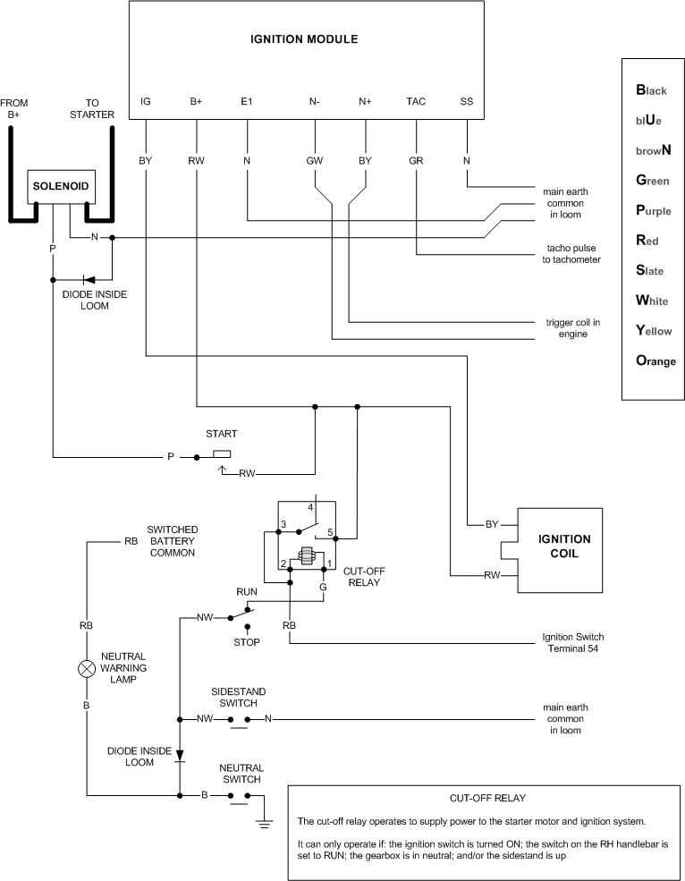

Postby DAVID THOMPSON » Sat Jul 05, 2014 6:57 pm
maybe this will help
drawing from tony idle
click on picture may make it bigger
better view

Postby mforza » Sun Jul 06, 2014 11:09 am
Thx Dave, will check this out tonight and compare to mine. Hopefuly I can find the glitch :)

Postby mforza » Sun Jul 06, 2014 11:15 am
So far I think just by looking at it my problem might be that "cut off" relay which I can't find anywhere :(
