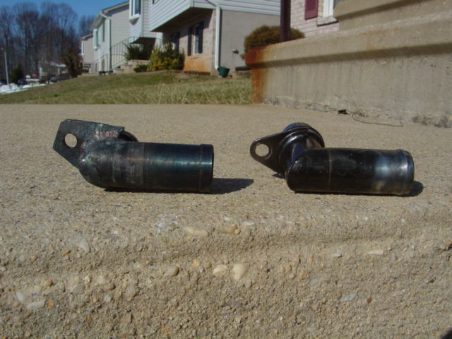

The next problem was with the throttle bracket in the new location the cable interfered with the 90 degree coolant ell sticking out of the head. I fabricated a new ell with the bracket in a slightly different spot so the ell was now rolled inboard a bit and out of the way of the cable. It took a couple of hours with the lathe and tig welder (I work in a machine shop).

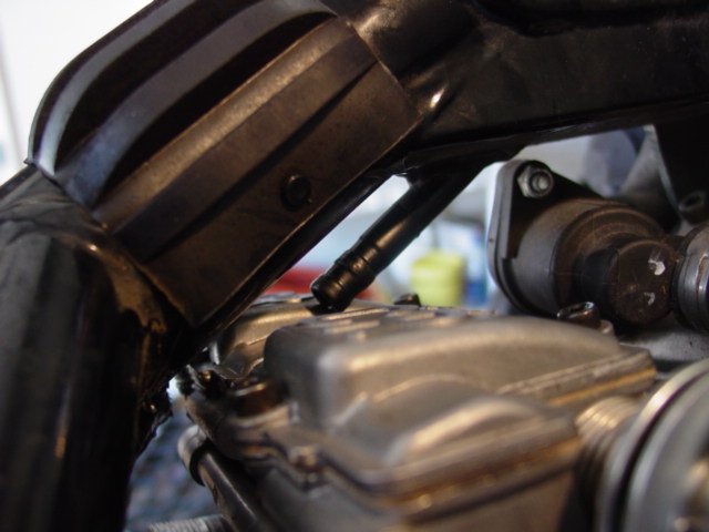

The next problem was the 10mm oil line nipple sticking out of the bottom of the frame interfered with the top of the carbs,. I solved this by cutting a good half inch off it with a hacksaw.
