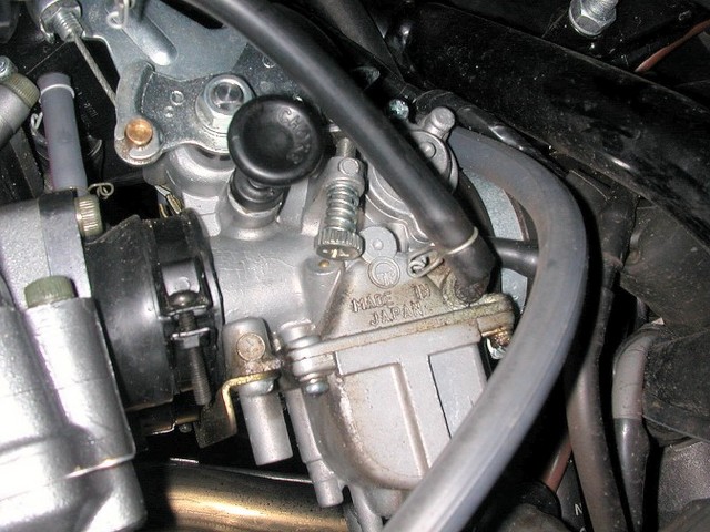

I had a get-off in the dirt that resulted in snapping the little plastic nub off the choke dial that keeps the choke in place when engaging/disengaging the device. So, not a major deal, the choke still works, but you have to hold it in place now with one hand while turning the dial up or back with the other. I'm wondering if anybody's ever relocated the choke mechanism down to the carb with a lever-type switch?

wha most do, is to simply let a short length of cable hang out under the plastic and put some sort of knob on it to pull. Of course you have to hold as long as you need it, then simply let it snap back in.

or you buy the choke for a xt600E model, must be from the model 1990-95 in the US, works great, only thing is you have to adjust the choke a little bit when you pull it out, otherwise the engine starts to rev up, michael

here is a link, http://www.georgiawatersports.com/Produ ... 30312d3030,
part #2KF-14371-01-00, in the micro fice it is number 49 if you look under carburetor, michael

puts the choke right on the carb, no more cable and no more problems with moisture
http://www.yamaha-motor.com/sport/parts/home.aspx, thats what it looks on the carb
