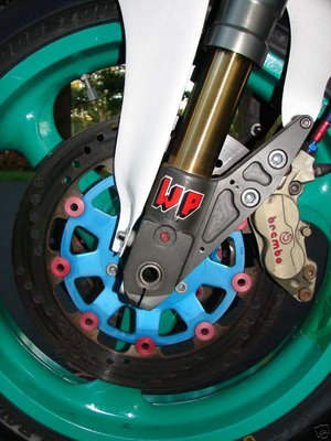

the PS looks like this, can be black or gold with adjustable or fixed lever, polished or black
it has a screw against the pump piston to set the empty travel, i.e. the distance between the piston edge and bleed hole
I use a PS12 with separalte reservoir on my Skorpion and the stock PS13 on the SZR - yes the Brembo pump is stock as is the P4 caliper: Brembo belongs to Yamaha.

P4 30/34 r
it is cast.
and this is almost high end:
cnc milled but P30/34 just like the cast one, taking the same pads and having the same mounting details, costs 3 times as much.
here on the MZ works Skorpion:
or this one, real high end for the Superbike series:
P32/34 cnc milled, Price? don't ask.

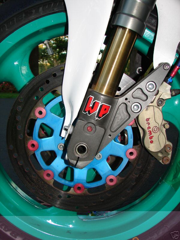

This one is cast:
P34/34
It has 4 separate small pads and above all the fixed bridge across the middle. Really good caliper for the money. Unfortunately with 65mm spacing it doesn't fit our fork. One could of course make an adapter.
compare to this:
this is the identical caliper as radial, same pads, same internal design. It works exactly the same, not better nor worse. It exist only to satisfy the wannabe market.
